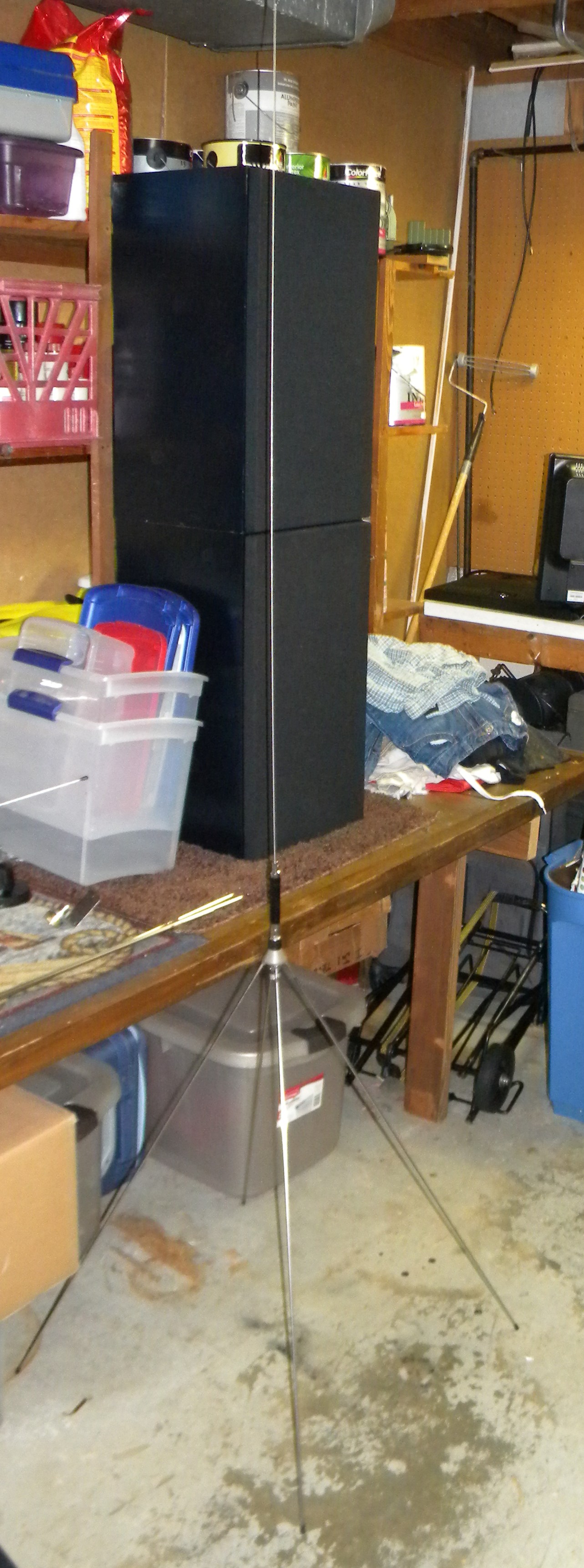

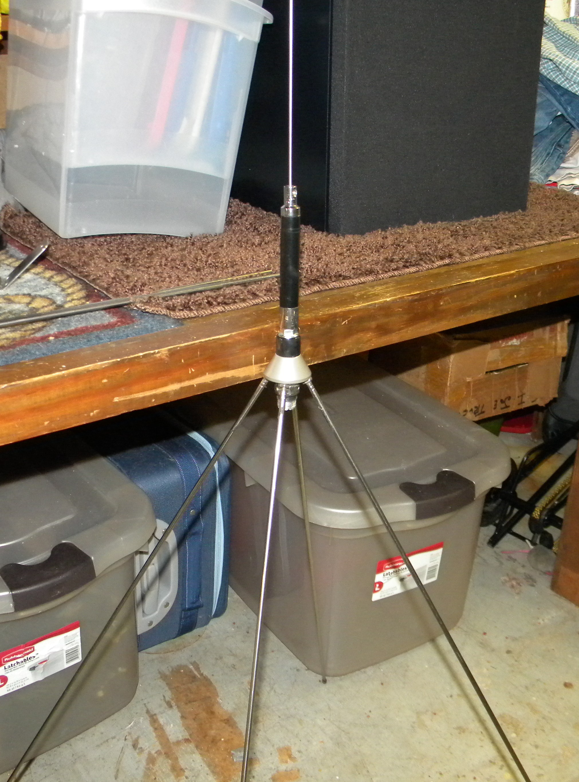

The finished product:
Whole assembly is dang near 8 feet tall, so won't quite fit in the picture...
VSWR < 1.3 across the entire 6 Meter band.
