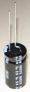

I need to do some recapping in my radios, but want to order my own electrolytic capacitors. I don't know the hole spacing and don't want to remove all the caps before the job to check the lead spacing of each cap. Does anyone have a list of the hole spacing for the electrolytic capacitors used in any of the following radios:
(1) a Cobra 142GTL
(2) a Uniden Washington
(3) a Uniden Madison
(4) an HR2510
(5) a Realistic Navaho TRC-490?
Kind regards!
Nobody does, far as I know. You'll find that over the last 40 or so years the average size of radial electrolytic capacitors has been shrinking. Good luck buying new caps by specifying the lead spacing you want. I suppose you could, but it's about the last spec we worry about. Spreading the leads a bit farther to match the hole spacing in a pc board doesn't seem to cause any problems.

I agree with Nomad that lead spacing is not a dimension that one needs to concern themselves with for this sort of project. What dimensions one needs to make note of is height and width. Some radios have special considerations when it comes to these dimensions. I have 272 kits available and there are a number that have special needs. I factor this in when I build a kit. One of the benefits of buying a kit from Klondike Mike's.

Does the 2510 have some unusual sized caps? Yes, but it’s not a necessity to replace them with exactly the same size dimensions. Doc never thought so, and neither do I. The 2510 has a number of very small caps. Depending on the circuit, Doc replaced many with larger sized ones that had a little larger working voltage. I followed suit and did the same with my 2510. The main emphasize is placed on buying quality caps such as Panasonic (Matsushita), and Nichicon. Testing each batch with a capacitance / ESR meter is advisable, especially involving any Chinese odd brands.
