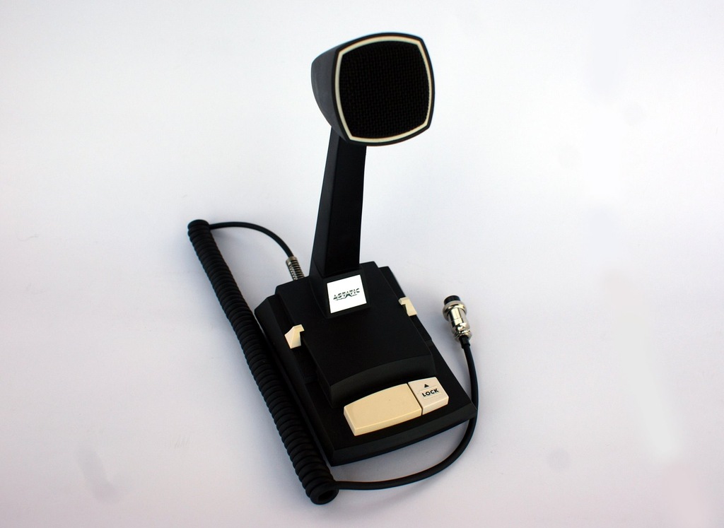

how difficult is it to convert tug8 to non amplified all the one on ebay are amplified
Look for the Astatic UG8 base which is non amplified. The "T" stands for transistorized so any T-UG stands would have to be converted.

Rarely are the d104 elements in good shape. They used a salt crystal which is sensitive to shock such as tipping over or being dropped and they don't like humidity.
The high impedance element makes you sound tinny on todays radios even with the ur6qw eq because of the impedance mismatch. Thats why i started experimenting with low z dynamic elements that would fit in the d104 head. Luckily the first one i tried fit and i had already used that particular mic with good reports.
Astatic made low impedance heads like the DN-50 and a few others that come up for sale on ebay.
Drop your shipping info in a pm and ill send you a few inserts.

Tokin I receive the UG8 today had no element at all in it took the cobra coffin mike element and the 2 pieces you send me got here today too perfect timing it's altogether
but i had low receive so I check the wires under the plate the red wire and the shield wire was swap I put them back the right way now it's working as it should thank once again for the eBay tip and the foam
