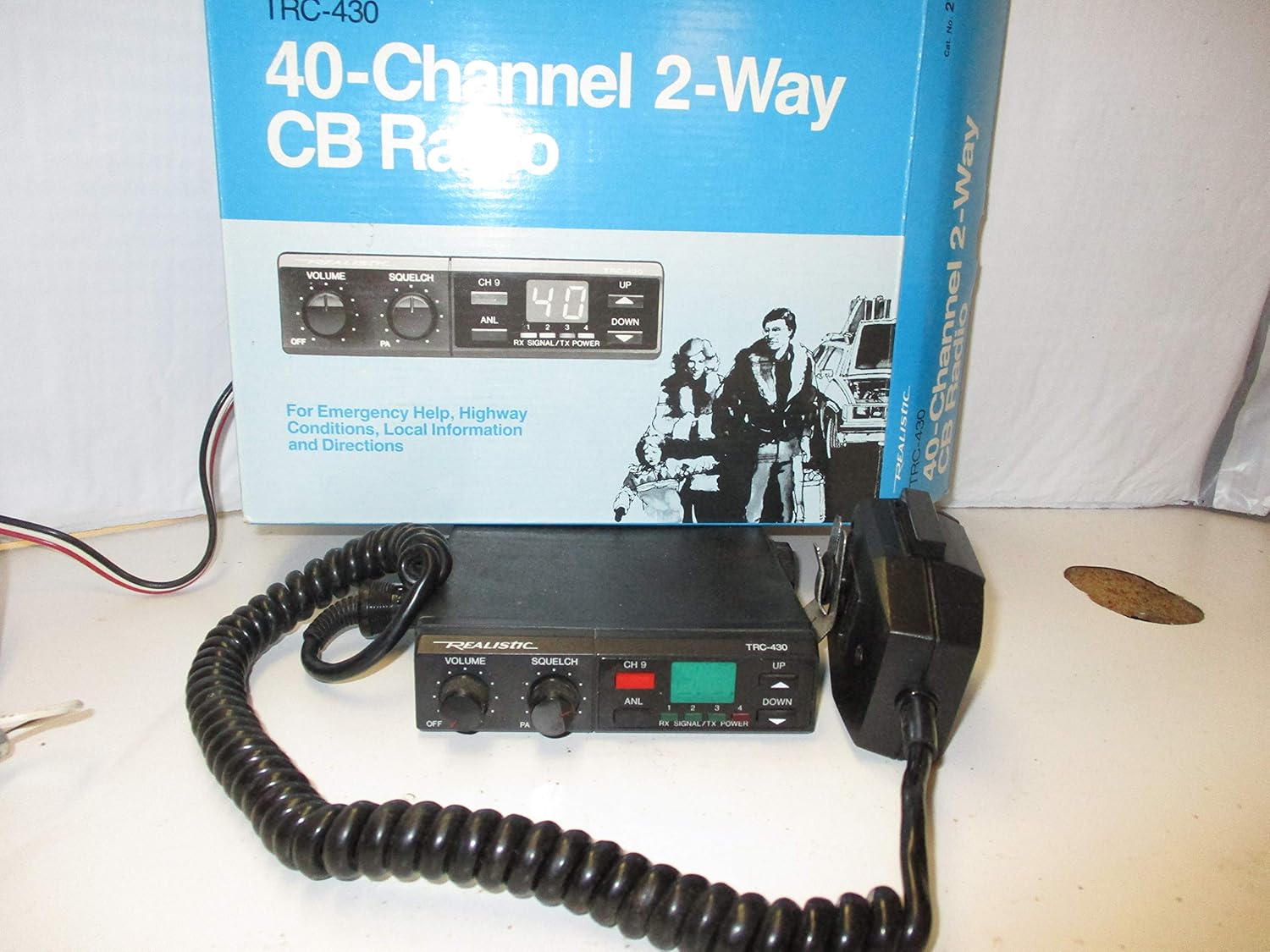

      A Realistic TRC-430 CB radio, with car antenna;

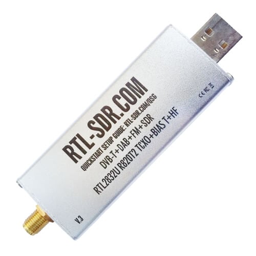

      An RTL-SDR.com Software-defined radio dongle.

    Now as to the CB radio: A well-regulated power supply that has at least a 7 amp/12vdc rating will be good to run that. Those will cost $40usd roughly. Even an old still working car battery and charger will work for now, but I would suggest if you go that way the battery should be inside a well suitable enclosure as they use on boats, etc.

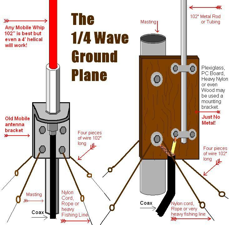

    Antenna wise: Here is a good basic, Transmit/receiving antenna set-up that is easy to build and work effectively.:LOL:
    More questions? Ask away...many here to help!!!

    As for the CB: I read that you can connect the red and white wires to the hot end of an AC adapter, and match the black, and just plug it into the wall. The unit takes 13.8 volts, and the adapter I have is 13.5. It turns on fine, and some channels even get 3 bars of signal, but I don't hear any activity.
    I don't have a spare car battery, but I do have this deep cycle batter connected to my solar panel. Would this work better than an AC adaptor?
    In the meantime, I'll have to get started building my CB antenna.

    "Wall Warts" have TERRIBLE regulation...I have seen 12-volt wall warts run 15++ volts.
    Transmitting out of the question unless you are using a computer grade adaptor that has a current rating of 5 amps or greater.
    I would not advise this MHO
