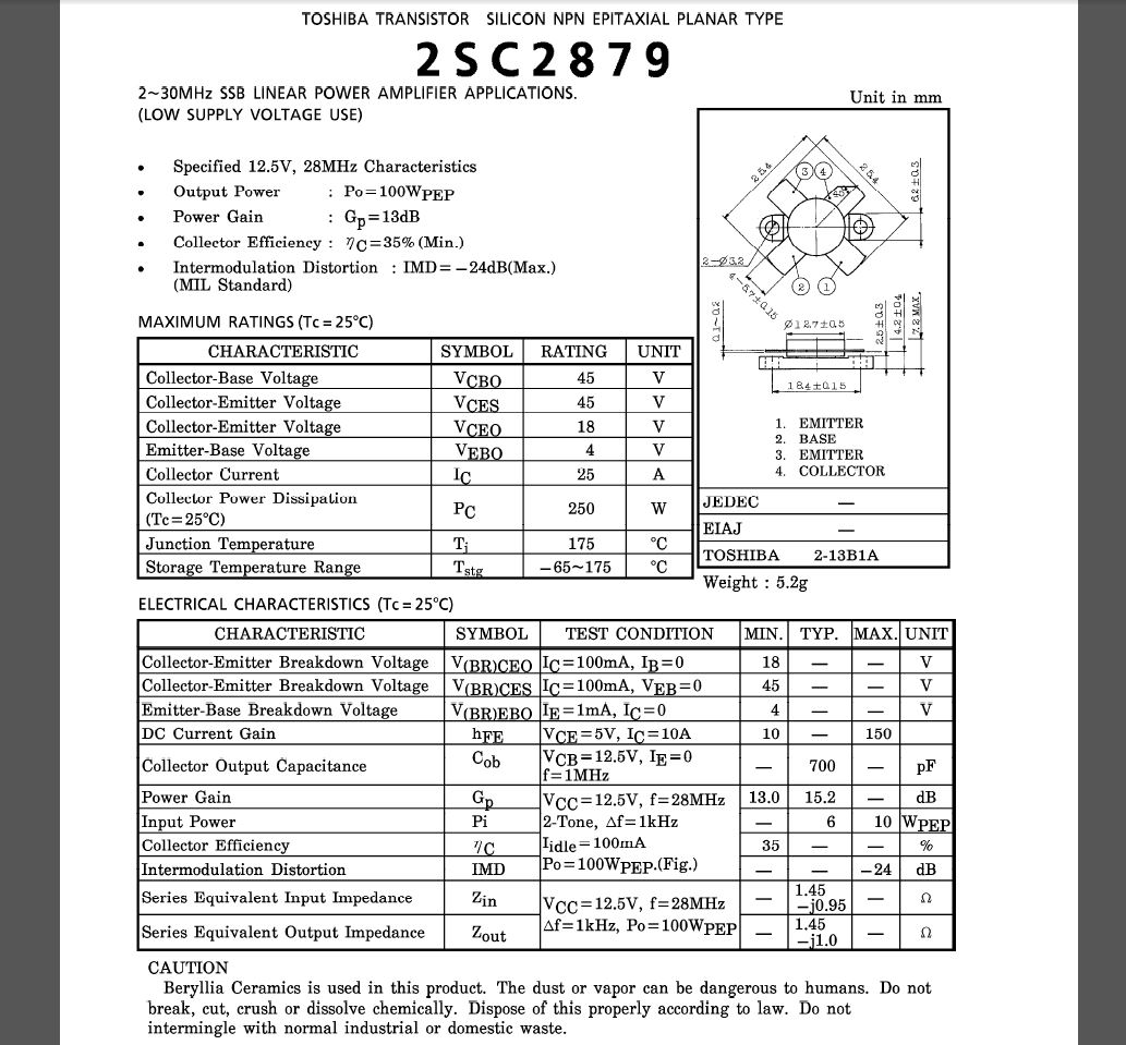

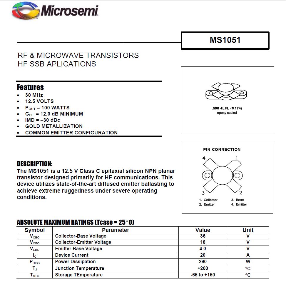

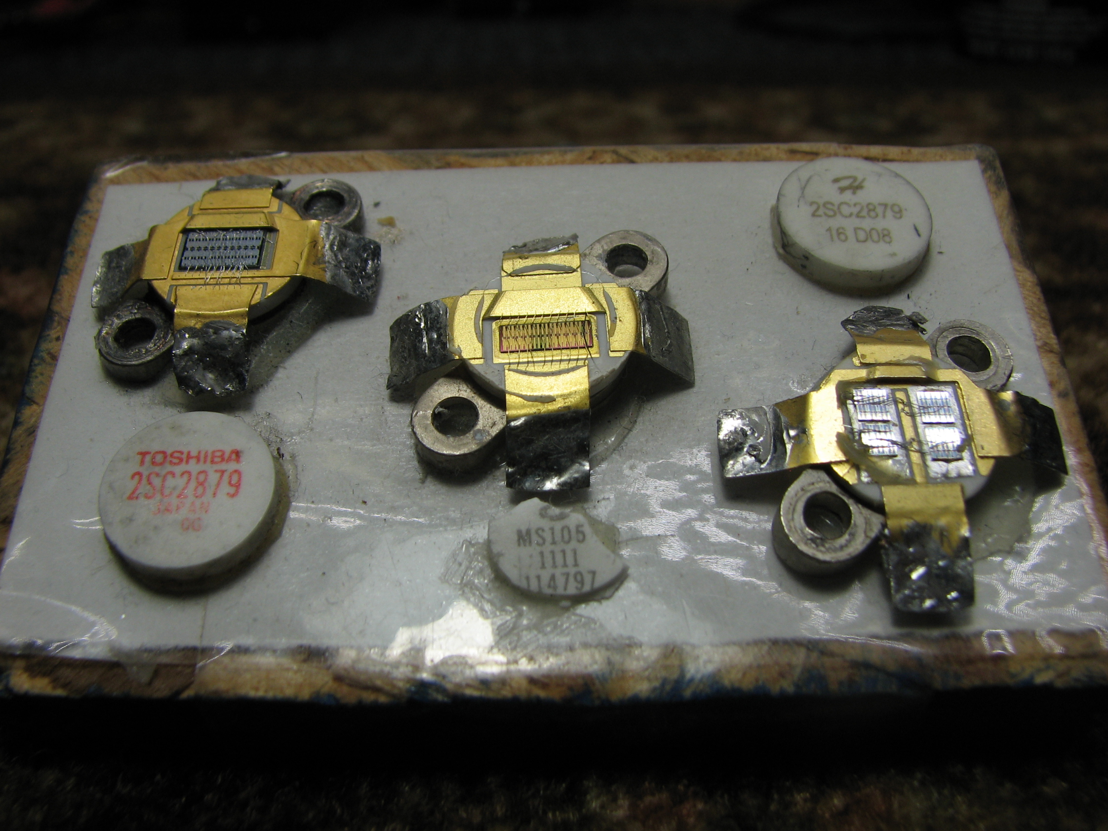

The MicroSemi, MS-1051 is a quiet good / rugged replacement for the Toshiba's (FYI: Actually, the non red-dot Toshiba's were better than the red-dot devices, as they had Beryllia-Ceramics for better chip to substrate heat transfer)., though the MS-1051s are a bit "pricey" ($50+ ea.) as compared to the poorly made HG / DEI devices...
(spec sheets & internal photo captures attached., as there are NO actual factory spec-sheets to be found for the HG / DEI devices...)
View attachment 38790 View attachment 38791 View attachment 38792
Looks interesting. Where would be a good place to get them from?
I imagine they will be just as difficult to get as original Toshiba transistors.
Yeah, looks like another long obsolete part, no thanks. My choice is the hg 2879C. At 150w pep i can loaf along and never strain the amp. Yeah ill need a bigger supply but so be it.
