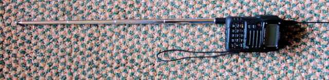

The telescoping 5/8 wave that Diamond makes is a superb performer. However, fully extended, it's quite unwieldy. It also puts a lot of strain on the antenna jack.
I'm using an Diamond SRHF40 on my Yaesu FT270R. It was a bit too flexible, so I put 2 layers of heatshrink on it to stiffen it up a bit. I also put a third layer at the base to take some strain off of it.
Zero complaints, seems to receive a little better than the factory antenna, but the gain is minimal at best. Probably not worth the $30 it cost me...oh well.

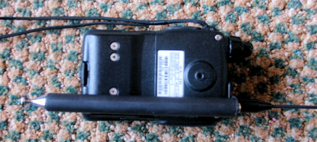

I always take the manufacturer's gain specs with a grain of salt...or two. I do know that the addition of the SMA-24 and tiger tail did help a bit for both rx/tx to distant repeaters. There's one approx. 20 miles away that I could hit with the original rubber duck from my front yard, but I needed a full 5 watt output. Even then, I didn't get full quieting into the repeater. With the tiger tail and rubber duck I still need 5 watts, but achieve full quieting. With the SMA-24 and tiger tail I get full quieting at 2.5 watts output. So my "gain" (pun intended) is a tad bit better rx/tx and my batteries last longer because I don't need to use full output. Here's some pics of the tiger tail I made from recycled junk drawer parts:
