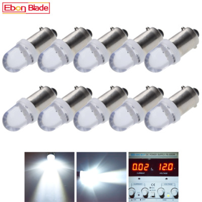

You might try something like these LED dome lights. I suspect they would be too bright. Adding some series resistance to each of them would solve that issue. Finding the ideal resistance value will take a little experimentation. I usually start high like 15K, then I work my way down from there.
