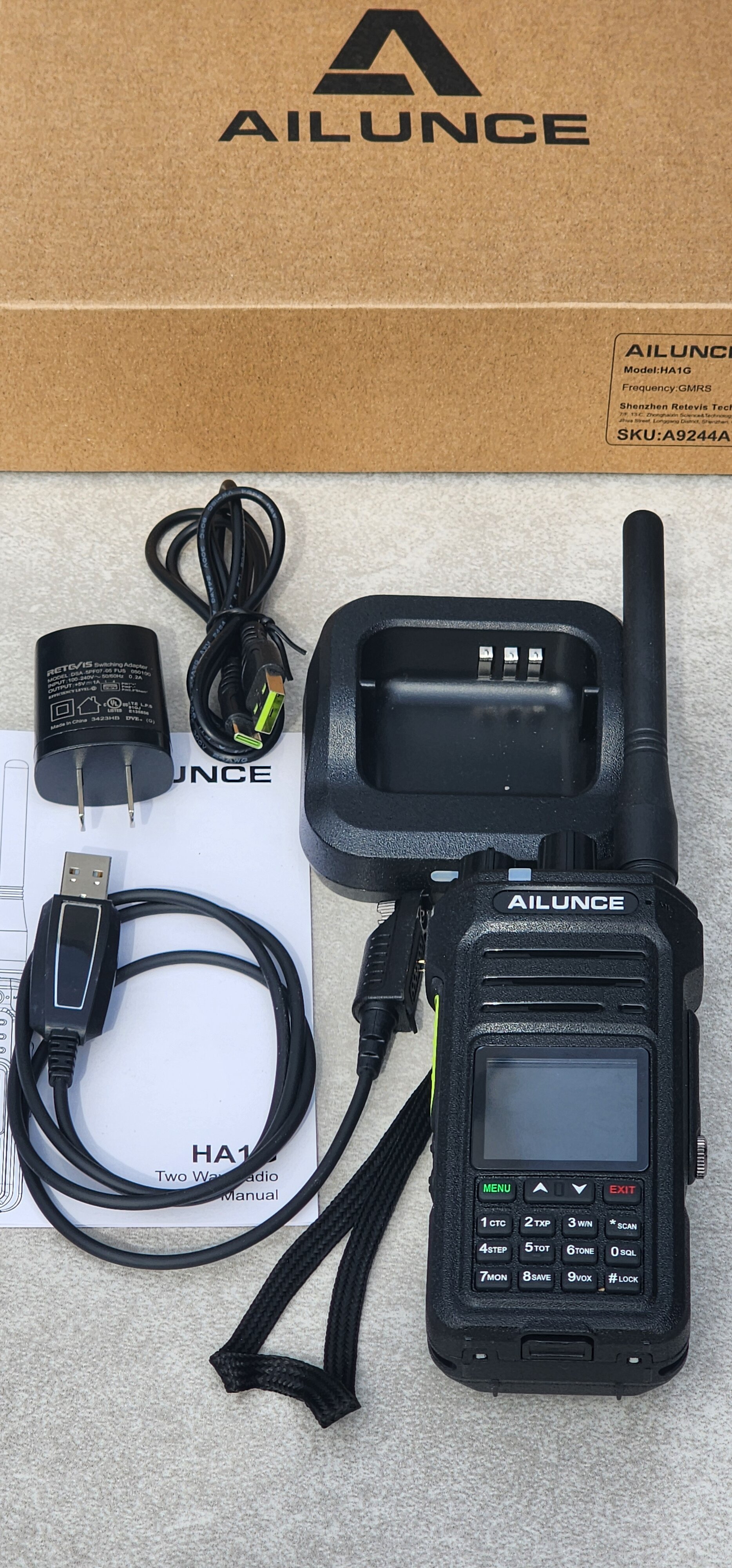

The first thing to know is that the HA1G is dust proof and water proof as indicated by the IP67 rating. This rating means that it can survive submerged in 1 meter of water for 30 minutes. I have not tested this rating yet, but I have no doubt that it is valid after testing another radio from Retevis with a similar rating that survived the Pacific Ocean surf. The HA1G comes with all of the typical accessories that you expect. The package I received did not come with an external speaker/mic, but it includes the typical desk charger, programming cable, USB cable, belt clip, etc.

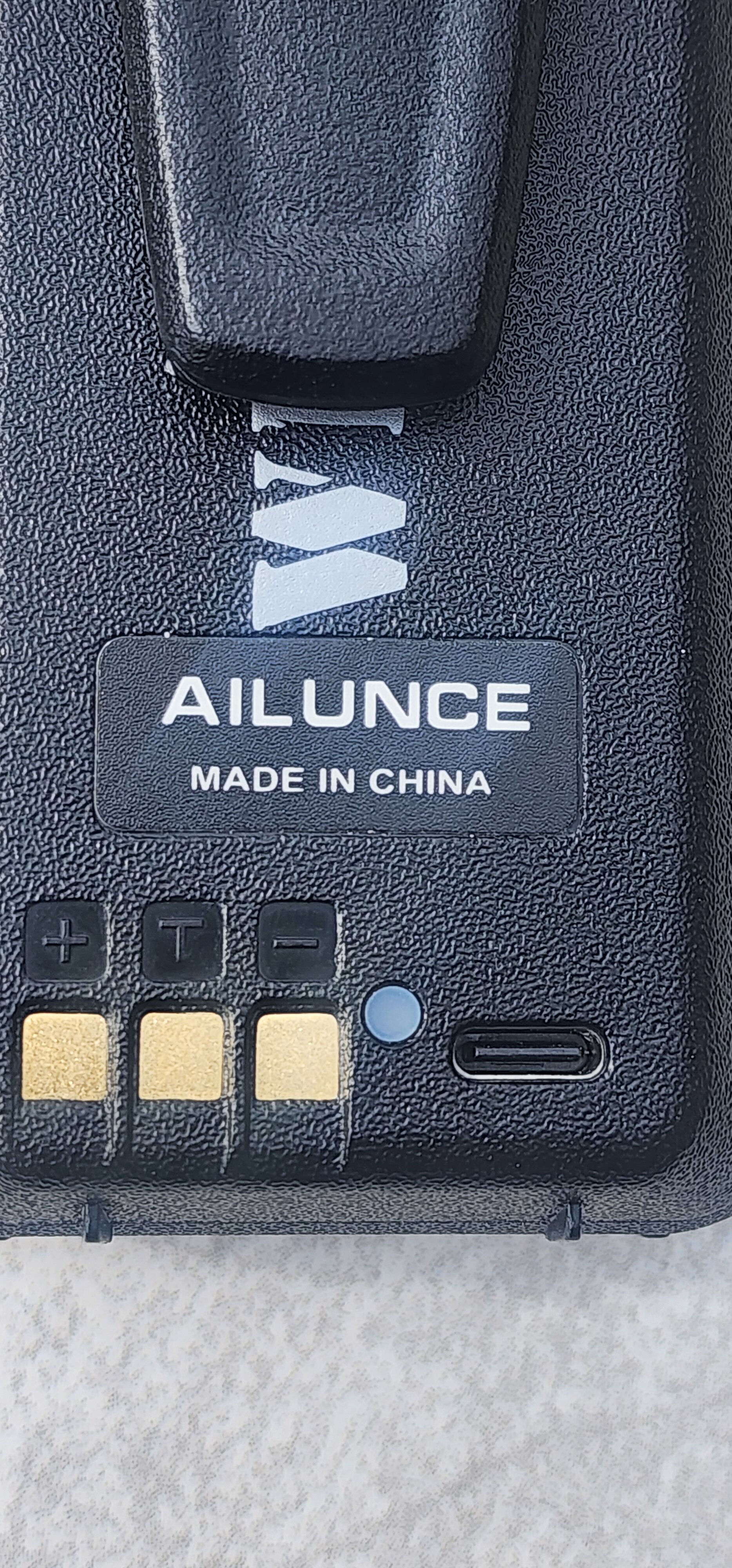

You don't need to use the desktop charger to charge battery because the battery has a USB-C port. Because this port is attached to the battery, it is only used for charging and not programming. Also, my tests found that using a PD (Power Delivery) USB-C port did not work; you need to use a standard 5v USB power source.

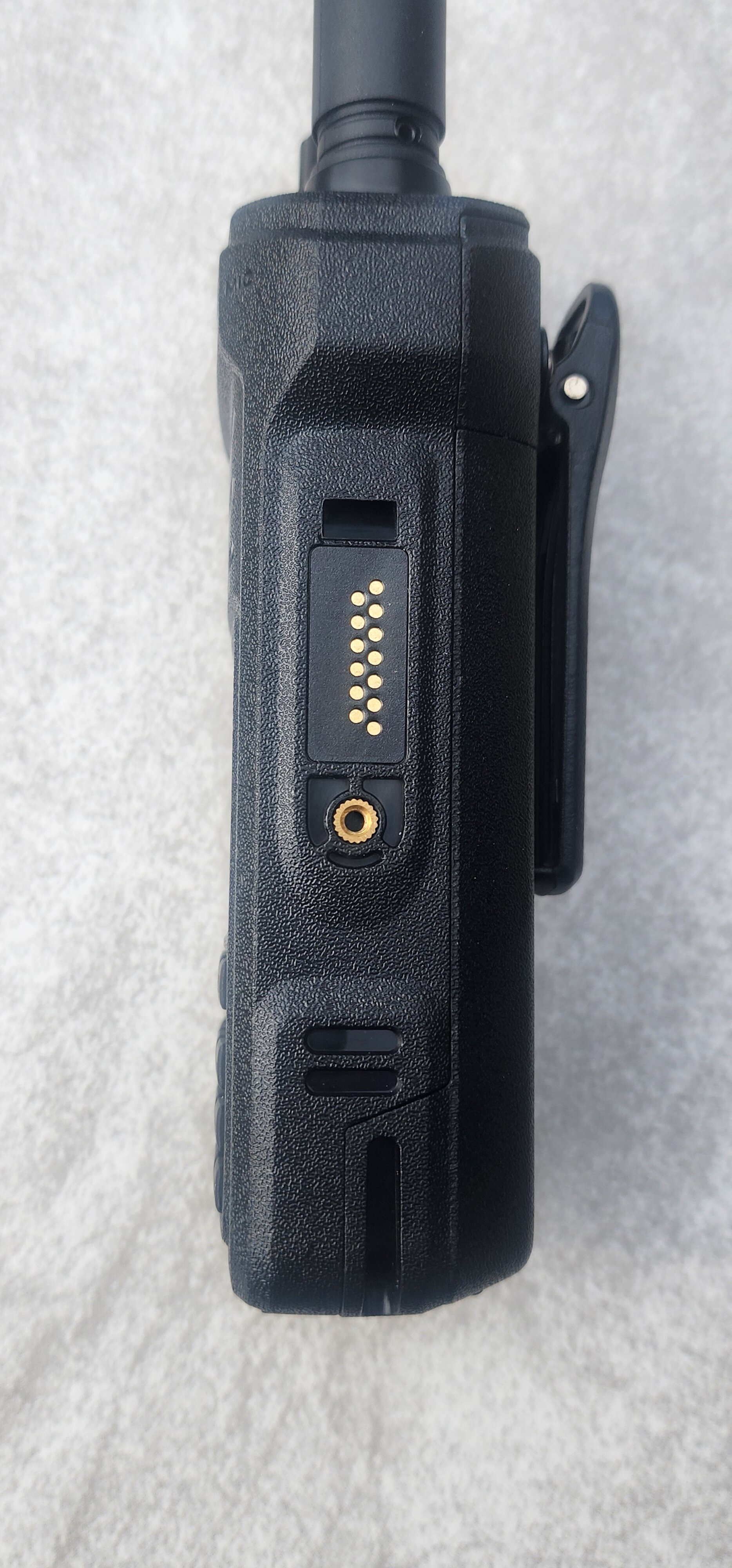

The HA1G is VERY rugged and design choices have been made to enhance its durability, such as the decision to use a Motorola-style speaker/mic connection on the side instead of the more common K2 connector. This is the same connector that is used with the programming cable, as well. This image has the side cover removed to expose the underlying connection. The way the battery is secured ensures that it won't pop out because of an accidental drop.

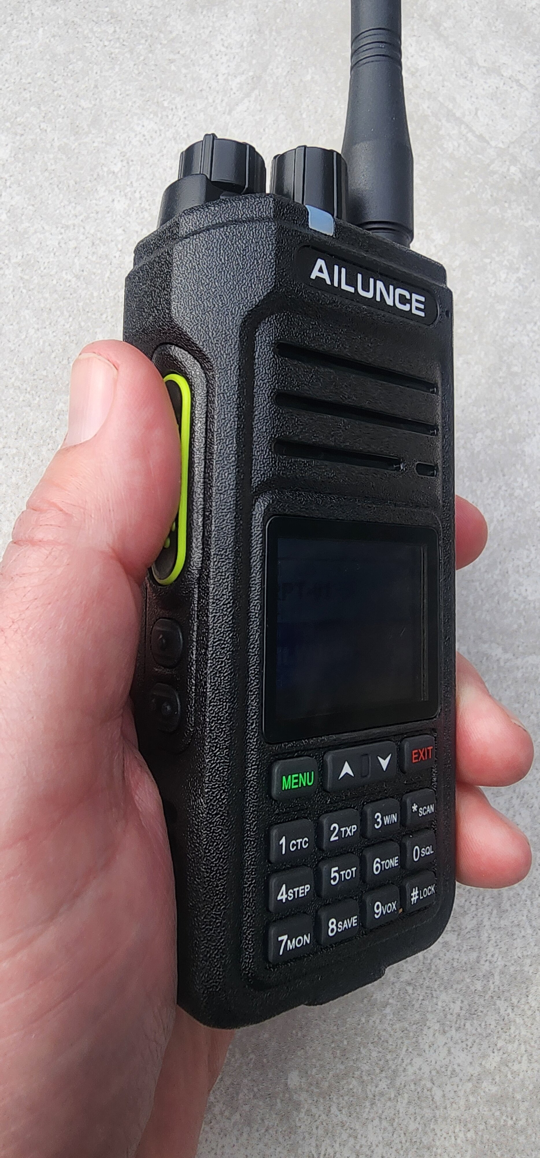

The PTT button is massive; you won't be able to accidentally miss it when picking up the radio to talk. Below the PTT button are two buttons that can programmed to respond to do different things based on a short or long press. One cool use for this is to make one of the soft buttons the Band A PTT and one the Band B PTT, regardless of which band is activated. Activating the built-in FM radio is a good function to program onto one of these buttons for long press (it comes like that from the factory). But you can literally program these buttons to do whatever you want.

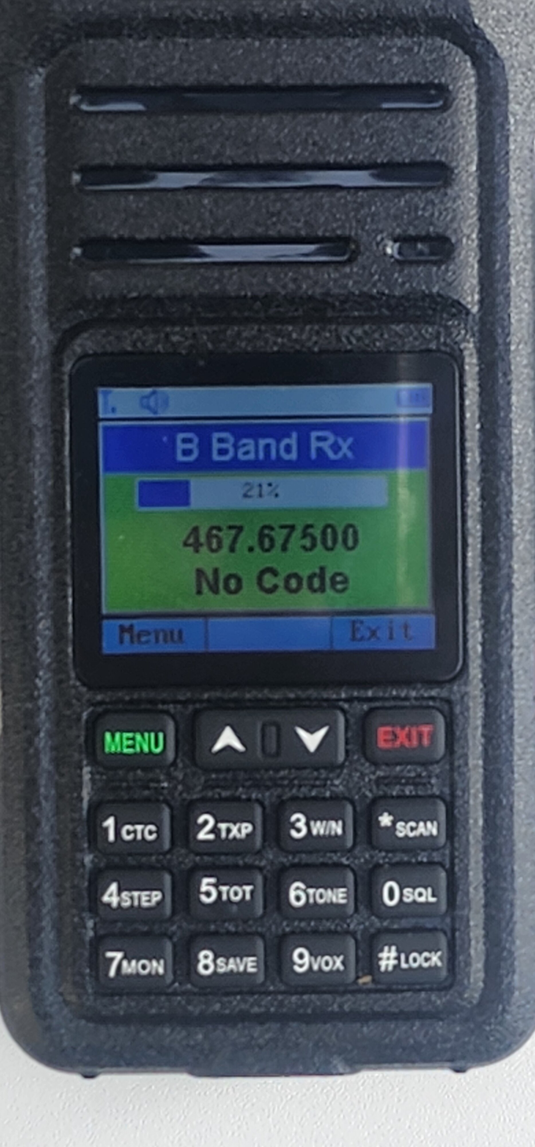

When the radio transmits or receives, the screen changes to tell you which Band is in use, the frequency, as well as any CTCSS or DCS code. The percentage indicator at the top is a version of an S-Meter, although I'm not entirely sure what it represents.

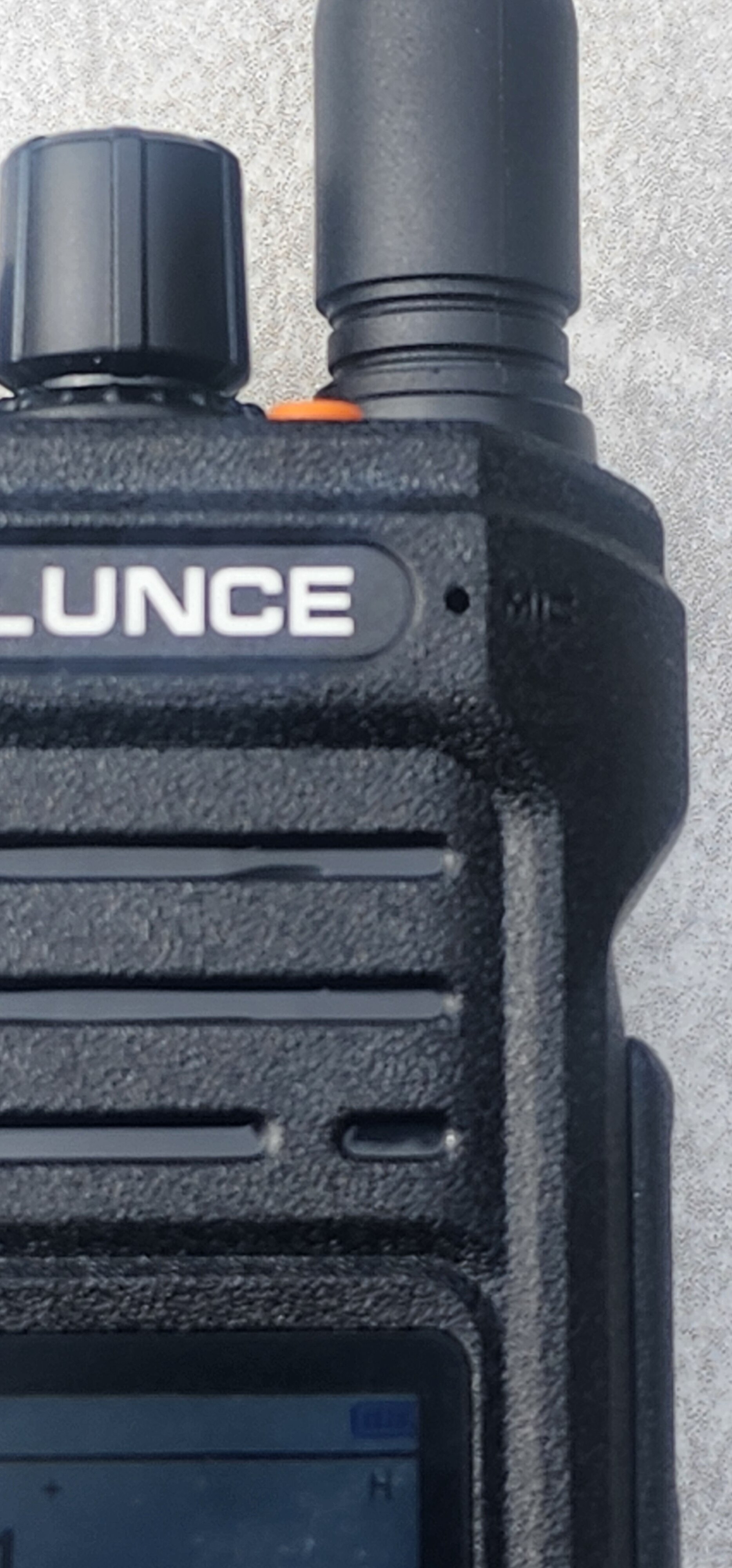

One unusual thing I discovered is the location of the mic, toward the top right below the antenna. This approach is fine, but the user needs to be aware that it's in a different spot than on most HTs. Note the location in this picture, right below the removable SMA antenna.

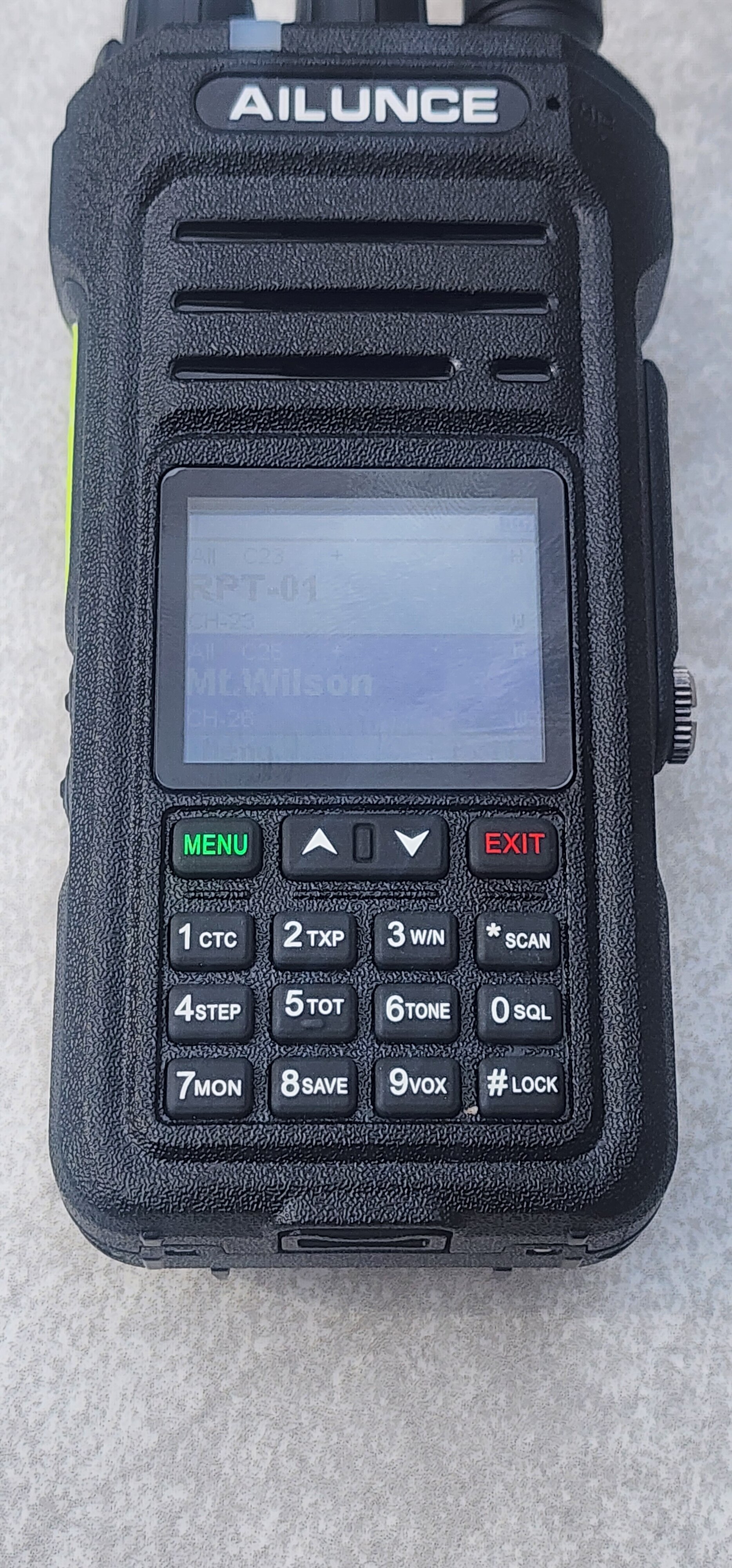

The audio produced by the built-in speaker is very LOUD, but it does have a bit of a very slightly muffled quality which is normal for waterproof radios. I've certainly heard much worse on much more expensive radios. One thing that could use some improvement is the contrast of the display outdoors. Overall, the HA1G has a very nice, well thought out display, but it can be a bit difficult to read in the direct sunlight. This is a common problem with color displays on radios. This photo of the radio outdoors in the direct sunlight is a bit exaggerated by the camera aperture and white balance, but it illustrates the point.
full

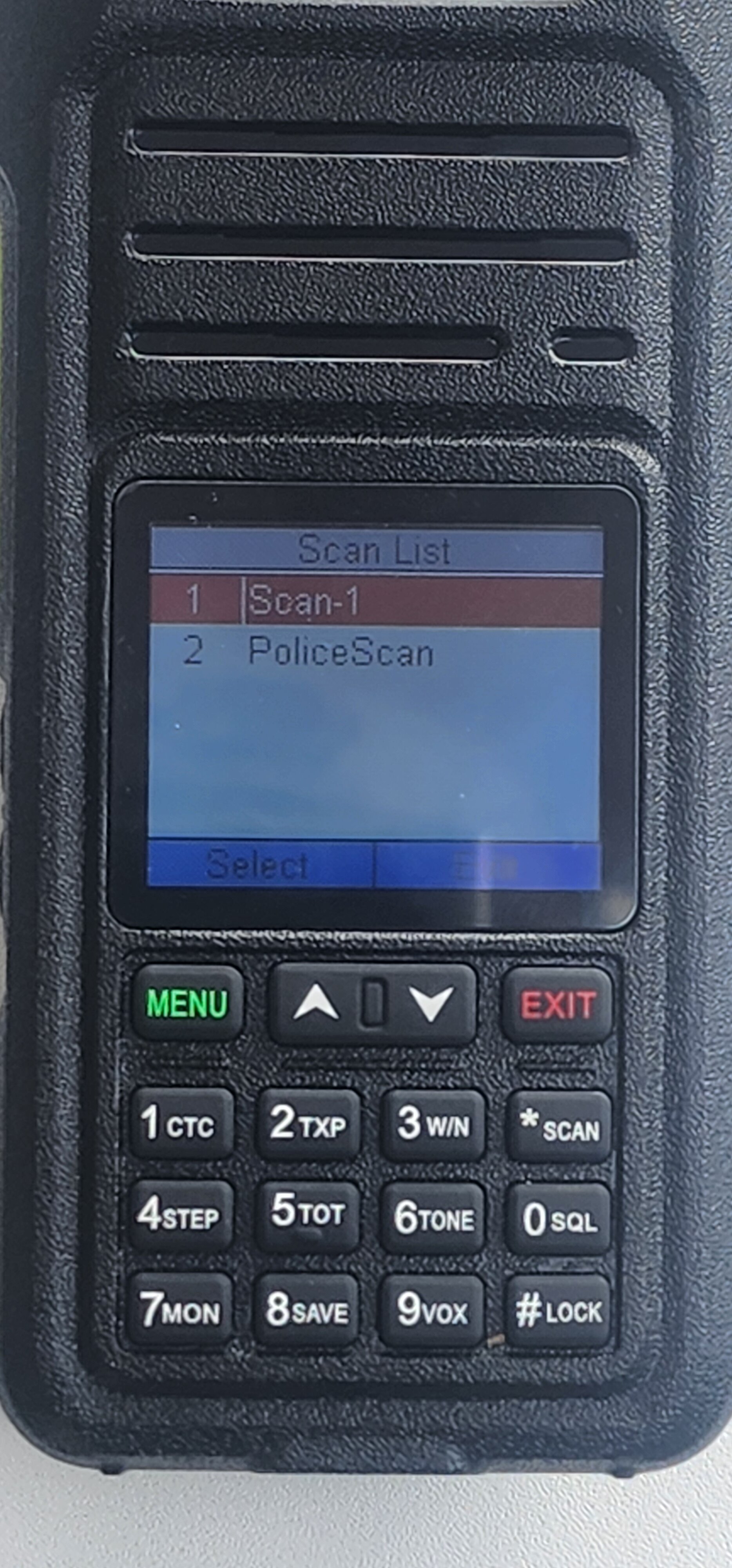

Looking at the above picture, you can see that you can quickly access the most common radio parameters directly from the keypad via a long press. I found this to be one of the most useful features. You can also see in the photo above that the radio can display two bands at once. You can also toggle it to display / listen to only one band. Why would you want to have two GMRS bands active at once? Well, one use case is the built-in scanner. Using the free software, you can create scan lists which can be any frequency in the VHF/UHF RX coverage area. That's right, this radio will RX VHF frequencies as well. Here's an example where I programmed my local Police VHF frequencies into a Scan List that I use to listen on band B will using band A for GMRS TX frequencies.
full

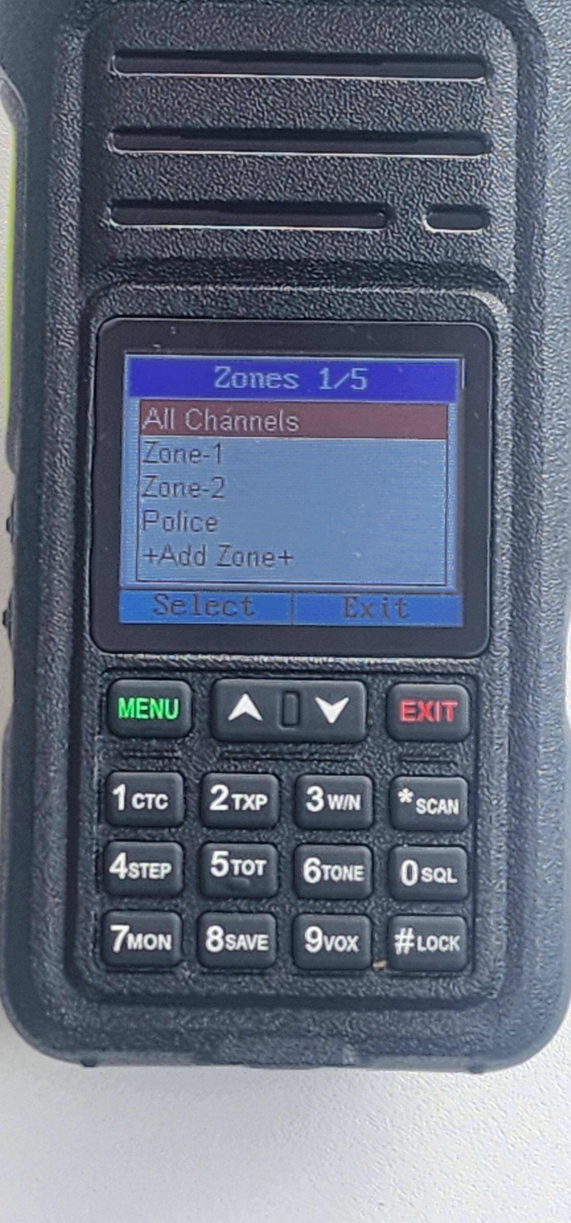

BTW, I feel that the scanner itself is a little slow, but it's about the same speed as most radios in the price category. Another neat feature is the ability to create Zones, much like you might do with a commercial radio. This is especially useful if you travel; you could create different zones that represent the GMRS repeaters in different cities, for example. You can create 16 zones, with 16 channels in each zone.
full

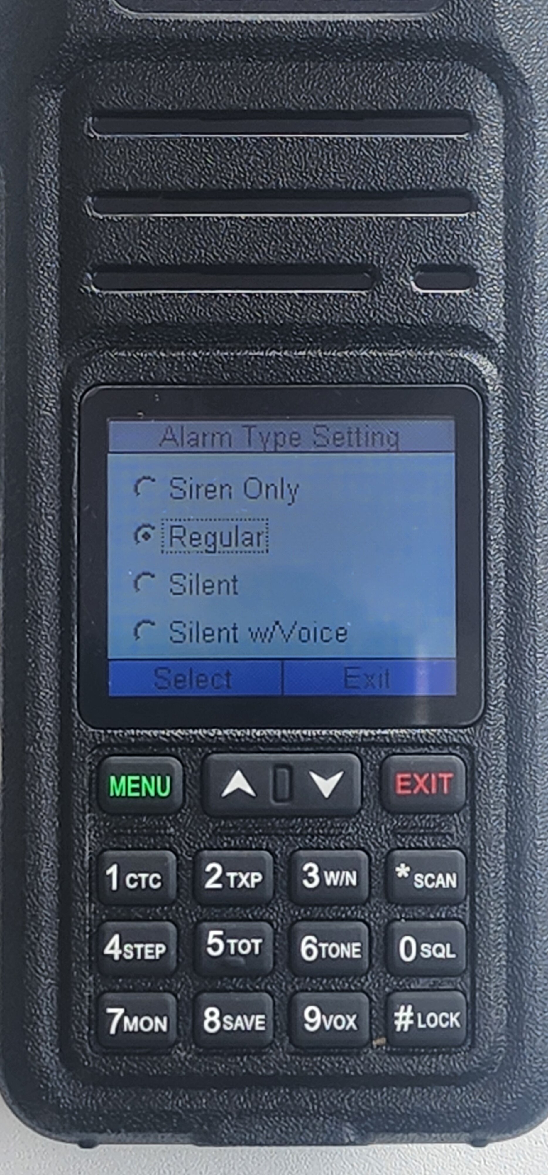

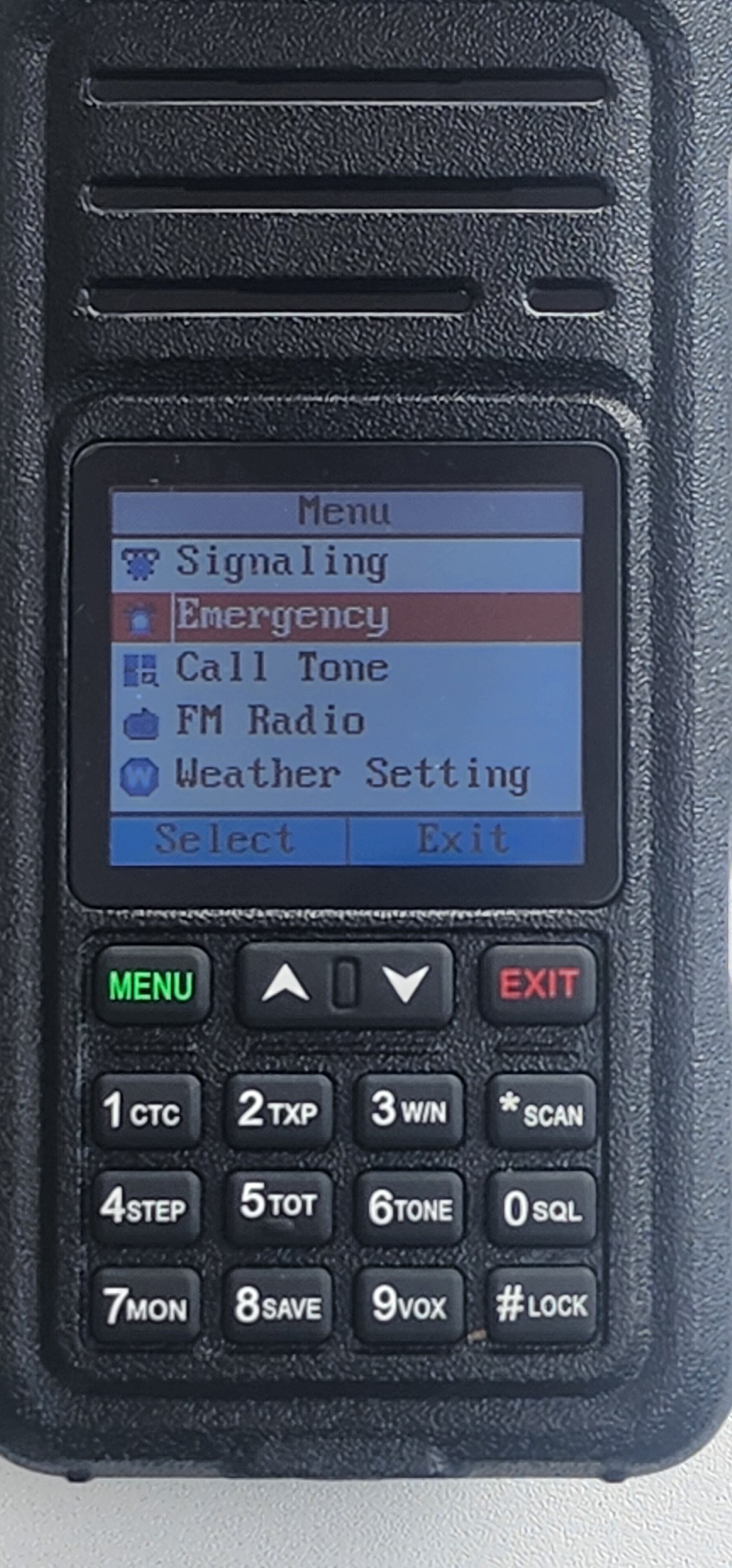

In addition to the standard scan list and zones feature, you can create a special "Emergency" scan list / zone, complete with a specialized alarm if that frequency is heard.
full
full
