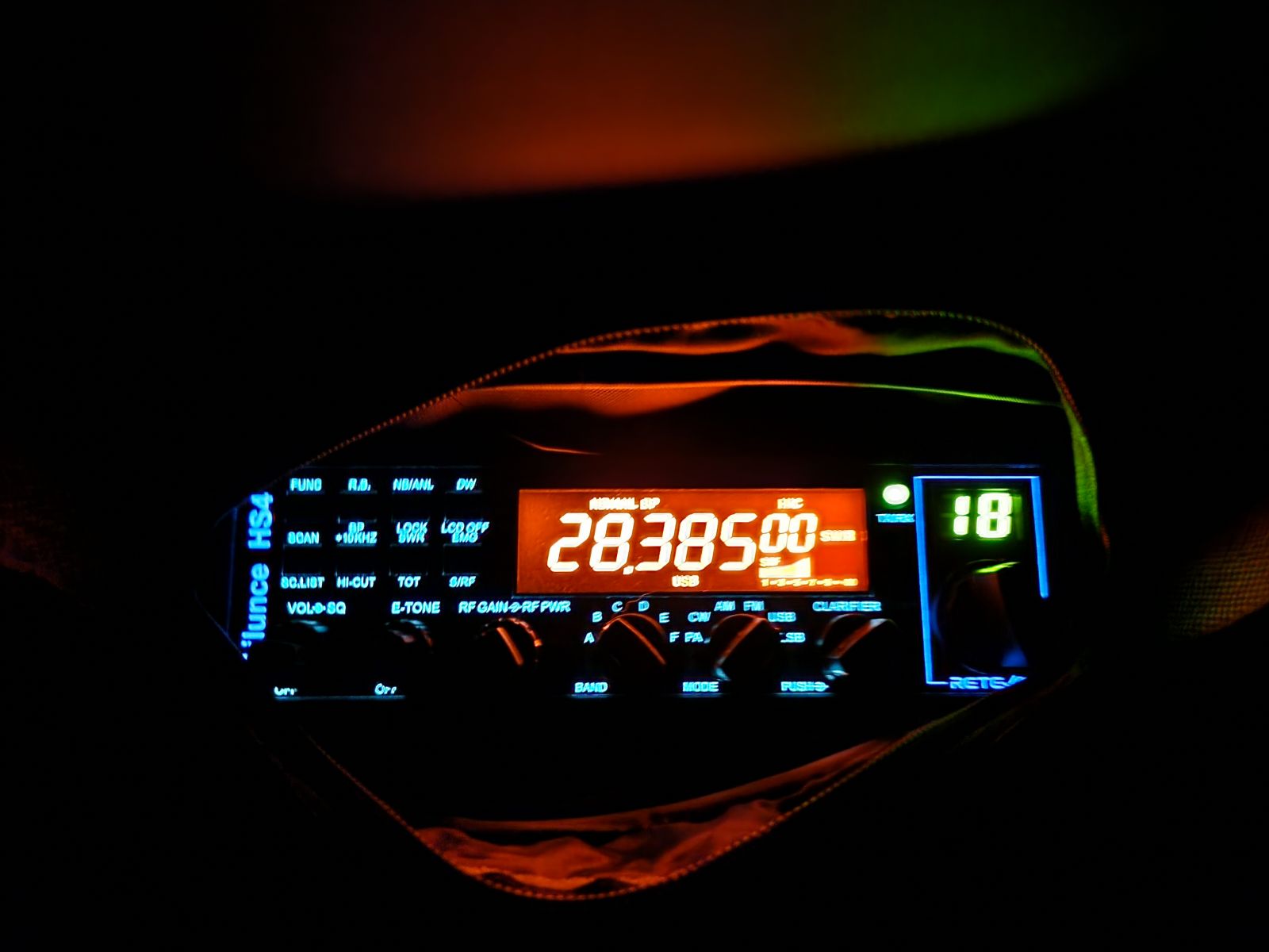

A couple of months ago, Retevis sent me a pre-production Ailunce HS4 10 meter radio to evaluate and provide feedback on. I've been playing with it for a while, and now that the radio is released, I can publicly review this radio.
full
Let's get the obvious out of the way: This is a 30 watt CB style radio, sold as a 10 meter radio but it can obviously be converted for use on 11 meters. What you decide to do with your radio is your business, not mine. For the purposes of this review, I've spent a lot of time using it as a 10 meter radio, to see how it performs and also pass along to others how to effectively use a radio like this on 10 meters.

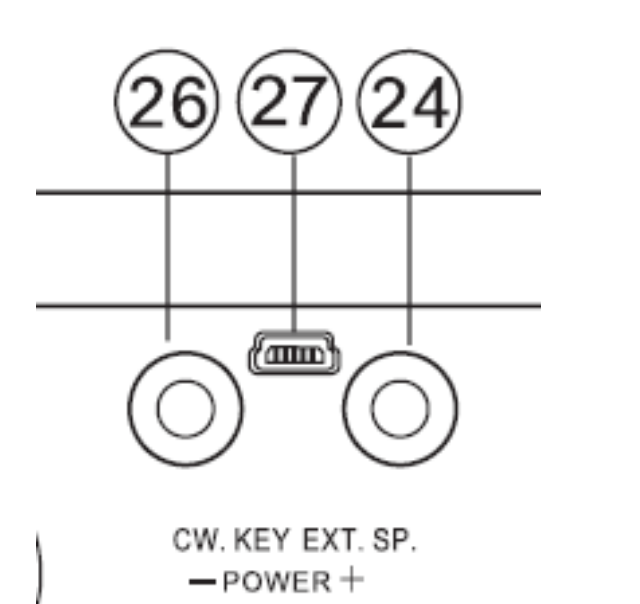

This is an all mode radio, as evidenced by the mode knob on the front. There is an 1/8" CW input on the rear, next to the speaker output and micro-USB, which is used for programming:

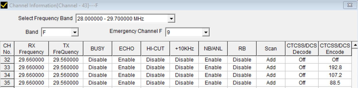

You really need the programming software to set up the radio to use FM repeaters. Without the software, the only way to setup a transmit offset is changing the clarifier to adjust the TX frequency. The CTCSS tones and DCS codes are set using a numeric value (1, 2, 3, 4, etc.). The manual I received with the radio was also pre-production and they accidentally left out what the numeric values represented, but a quick email to the company solved that problem. I'm told the manual now includes a table of values. If you want, you can program a bunch of different channels with different tones that equate to the various repeaters you regularly use. Here's an example of how you might do that:
full
In reality, in North America there are only a few RX frequencies used by FM Repeaters and they all have the same offset. Some people might want to just program in the main RX/TX pairs and then use the menu to change the CTCSS when working a different repeater. If you choose the latter, you'll need to keep the CTCSS lookup table handy. And since there's no way to rename memories on a radio like this, you'll need to make a table of anything you program using the example above. Regardless, it works and I've checked in a few times on a local 10m repeater.

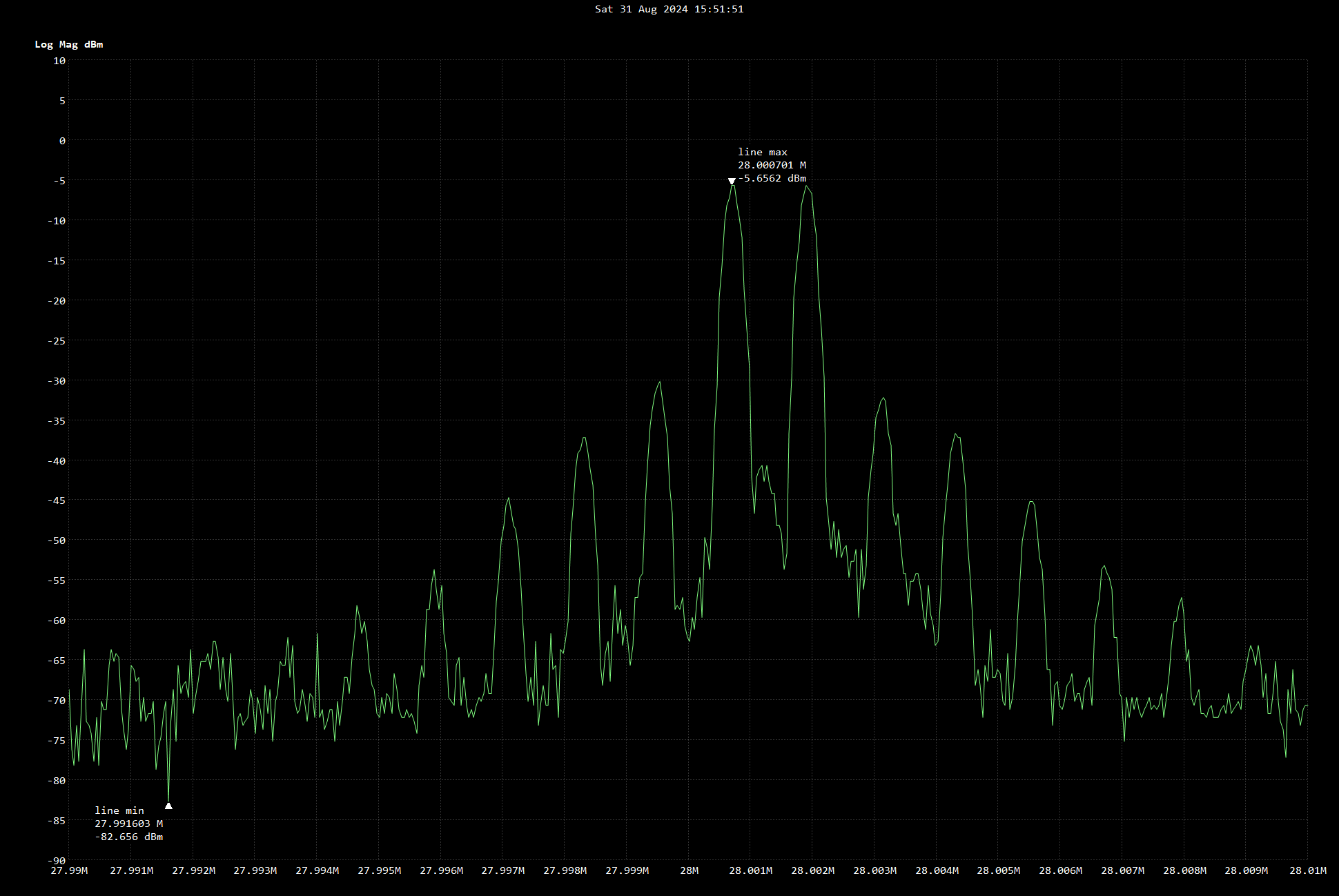

IMD Test
Retevis asked me if I have the ability to perform an IMD test. While I don't have a "lab grade" test setup, I do have the ability to do a rudimentary test. I have an Aursinc TinySA Ultra that is capable of doing some basic SSB IMD testing. (Note, the original TinySA cannot do this). I put a homebrew RF sampler inline into a dummy load and set the RF Power at about 1/2, ran into a 40 db attenuator into the TinySA Ultra. To generate the necessary 700Hz and 1900Hz tones, I used an Android app called "Frequency Generator", which also lets you set the volume balance of the two frequencies. I simply coupled the phone speaker to the mic and took a reading. In the results, you can tell that I didn't get the balance set perfectly, but it's still good enough to get a reading:
full
The HS4 is advertised as -25db or better 3rd order IMD and -35db or better 5th order. This plot shows that 3rd order is exactly -25db and 5th order is about -32db (I forgot to put the markers on the graph). So, I would say it performs as advertised. More expensive HF rigs will perform better than this (and they should) but at this price point, you're getting the same performance that is considered acceptable in a CB radio.

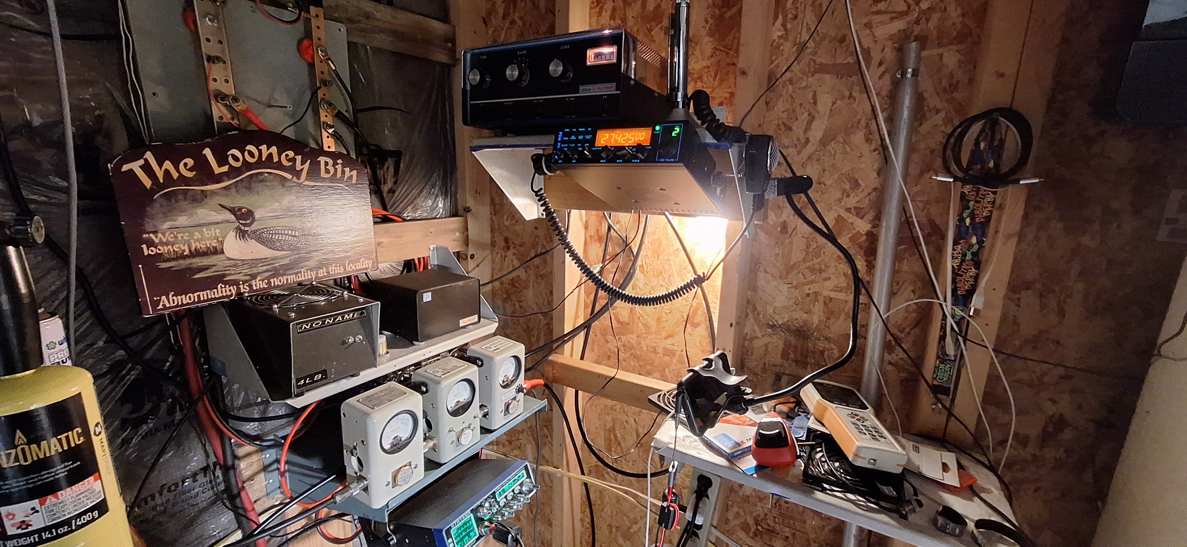

So a couple months ago Mr Panic Attack sent me an hs4 that was cosmetically damaged during shipping. Before sending he totally decked it out with his tx/rx mods. Its showing 50 watts pep and 20 watts average am. Gotta say im absolutely impressed with the recieve and tx audio quality. Ive had several sideband gates played back and id never guess the gate was from ssb. I don't beleive hes on here but if he is Thank you Mr Panic Attack for another high quality tune and mod.
So a couple months ago Mr Panic Attack sent me an hs4 that was cosmetically damaged during shipping. Before sending he totally decked it out with his tx/rx mods. Its showing 50 watts pep and 20 watts average am. Gotta say im absolutely impressed with the recieve and tx audio quality. Ive had several sideband gates played back and id never guess the gate was from ssb. I don't beleive hes on here but if he is Thank you Mr Panic Attack for another high quality tune and mod. View attachment 72369
"Abnormality is the normality of this locality" :ROFLMAO: :ROFLMAO:
Yeah he's around. I've bought and resold probably 4 or 5 of these radio's. Never had any problems. I saved the software setting I use so it's pretty easy. I used the same software as my Anytone Q5555 Plus so its easy peazy. Dont talk much if any on SSB anymore so not sure why I even keep ssb radio's. I tell ya though for a starter radio for 10-12m it would be dandy. I used to do a lot of 10m back when I still had a license. I been trying to get back into the swing again, since my cataract surgery and later a retinal detachment. Sure changes things when your blind for a while. Panic, and Hammer J, are good folks. Keep them on speed dial myself. Over the past few years I added BBI to me list as well. He really helped me through my tough time with my eye's. I drove over and he worked all night on my amp, and I left with it the next day! Who does that!! We talked more about life and our trucks than radio. Just awesome guy. Anyway, have a great day over on the Sand Pile. I've talked to ya before on 28 maybe sometime we will talk again take care, Dirty Ole Man in the NW corner oregon.
