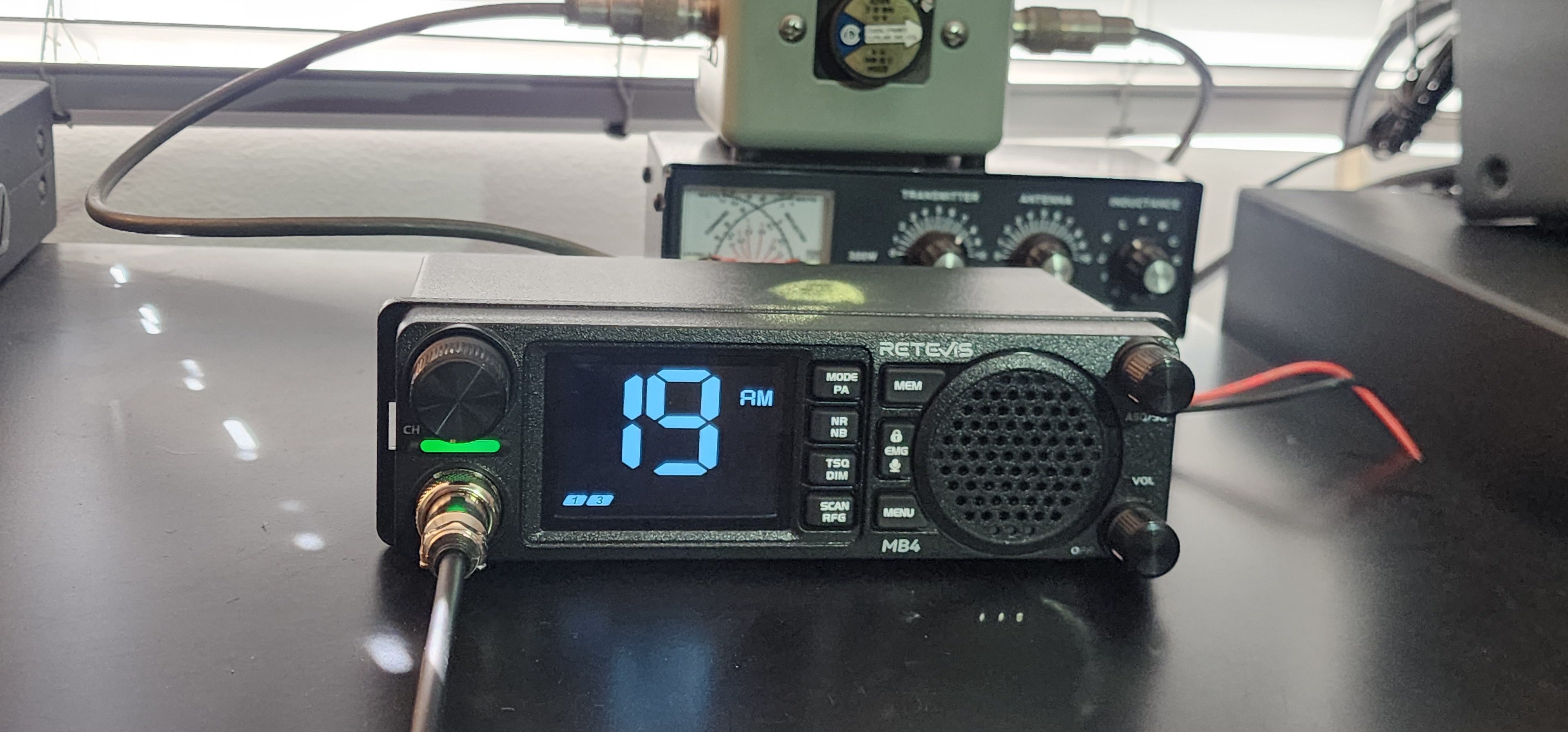

I’ve been around enough CB radios to know when something breaks the usual pattern, and the Retevis MB4 definitely does. The moment I pulled it out of the box, it was obvious this wasn’t just another compact black box. Even though it has all the same features found in most modern CB's, what's different is that it’s a true single‑DIN CB radio, the kind you can slide right into a dashboard slot like a car stereo. That alone makes it stand out, and it gives RVers, truckers, and big pickup truck drivers a new option for a CB. Once I started using it, the MB4 turned out to be a surprisingly capable little unit with a mix of modern features and practical design choices that actually make sense in real‑world use.
full
A Big, Clean Display and Straightforward Controls
The first thing that hits you when you power it on is the display. It’s huge, bright, and easy to read from anywhere in the cab. All of the main controls are simple and intuitive — channel knob, volume, squelch, scan, dimmer, RF gain, NR, etc. Nothing buried, nothing confusing. The dimmer only has three levels, but they’re enough to keep the screen from lighting up the whole vehicle at night.
The Forward‑Facing Speaker Is a Legitimate Advantage
One of the smartest design choices on this radio is the front‑facing speaker, which is not only a nice touch for DIN mounting, but also if you just want to include the regular, included mounting brackets. You almost never see that on CBs or even ham mobiles, and it makes a huge difference. The audio comes straight at you instead of firing downward or sideways. It’s loud, clear, and in most vehicles you won’t need an external speaker at all. For anyone who drives a noisy truck, Jeep, RV, or anything with a less‑than‑quiet cabin, this is a real quality‑of‑life upgrade.

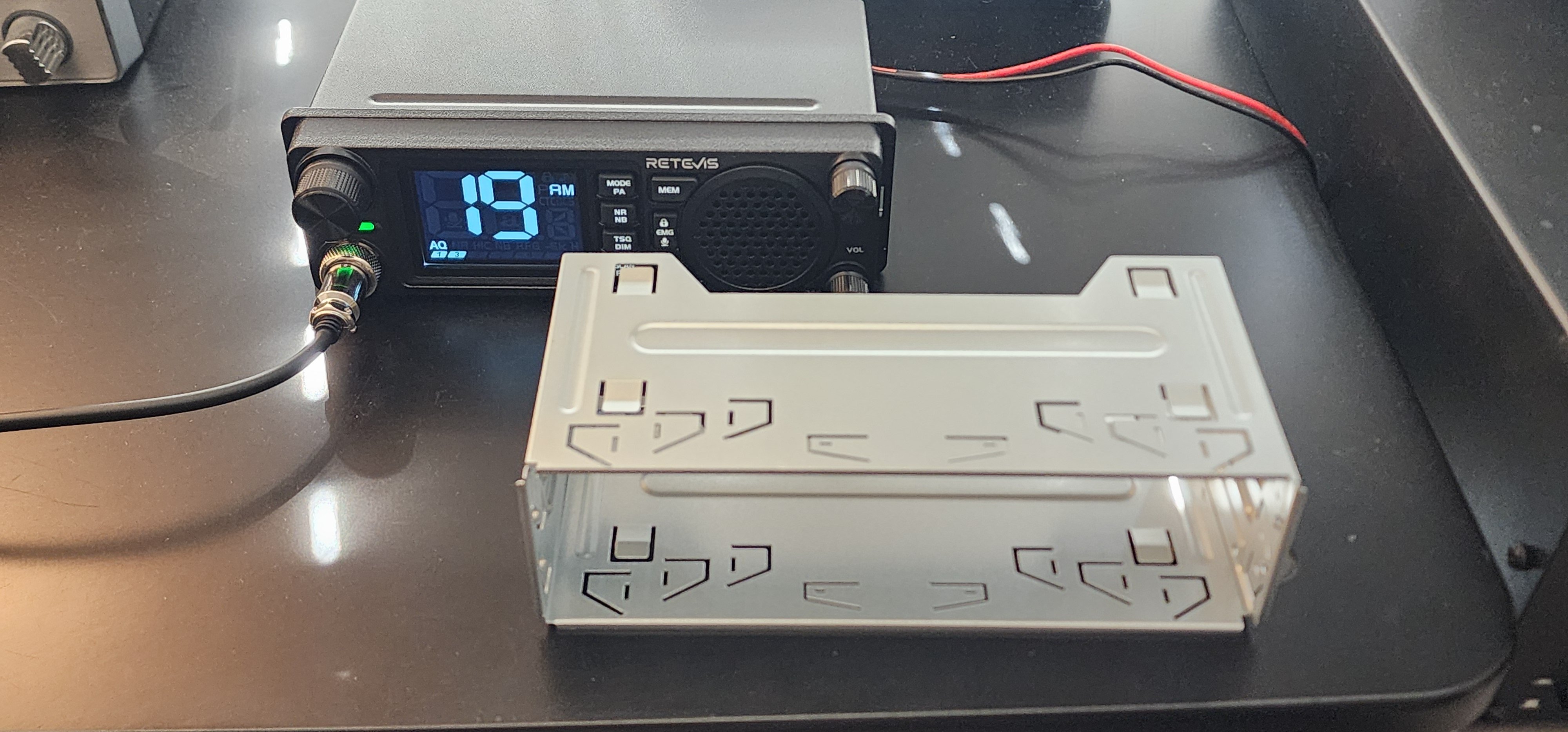

Both DIN and Bracket Mounting Options Included
The MB4's uniqueness is the optional DIN mounting but it also includes all the standard brackets. The DIN bracket includes the keys for radio removal. Here's a pic of what the DIN bracket looks like:

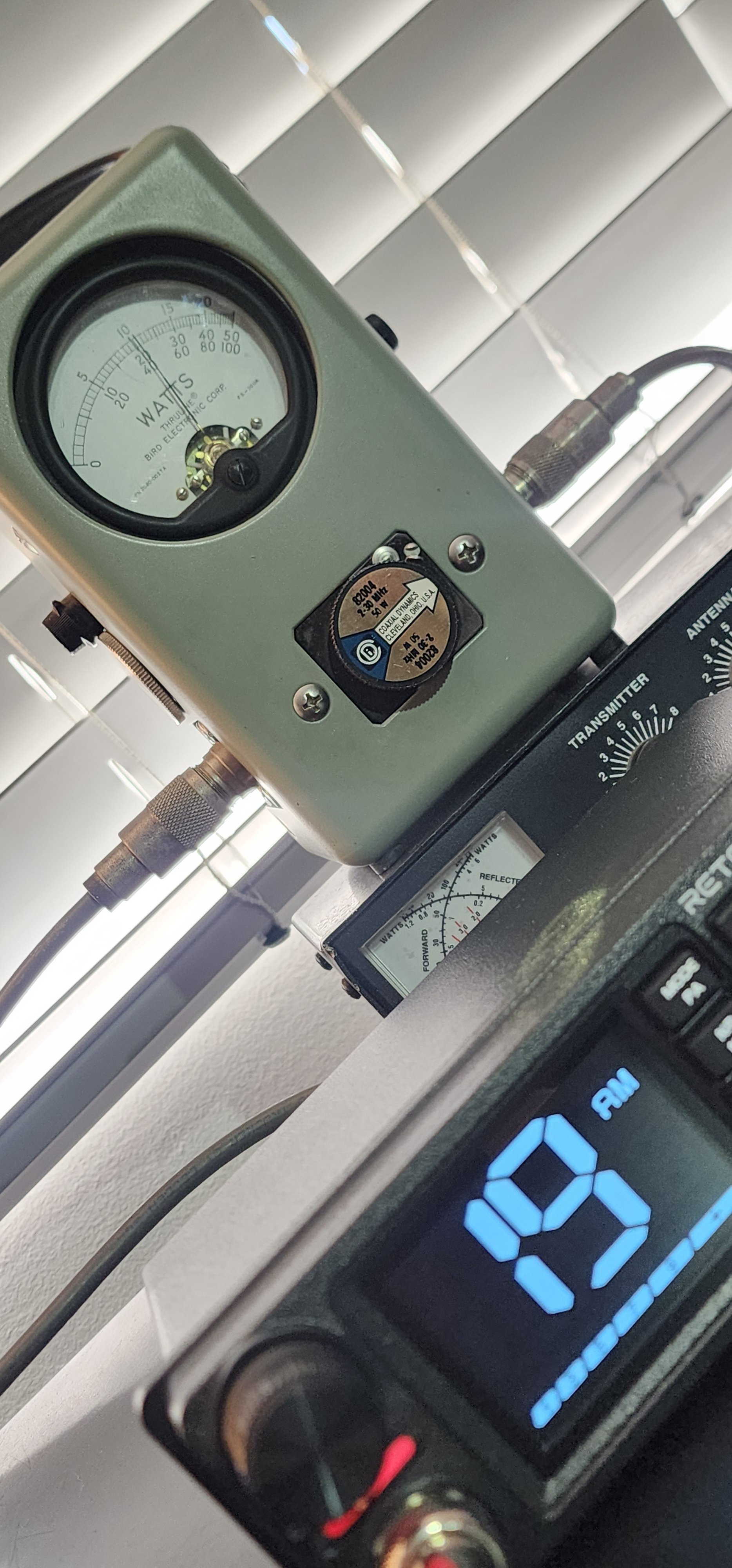

Power Output: Exactly What It Should Be
With a 12 volt supply on the meter, the MB4 does exactly what a legal CB should do. It puts out a solid 4‑watt carrier and hits 16 watts PEP on voice peaks. That’s textbook 4:1 modulation. when I used a supply voltage closer to a typical vehicle (14 volts), I saw 5 watts peaking at 20. All measurements were made using a Bird 43P meter with a 50 watt element.
