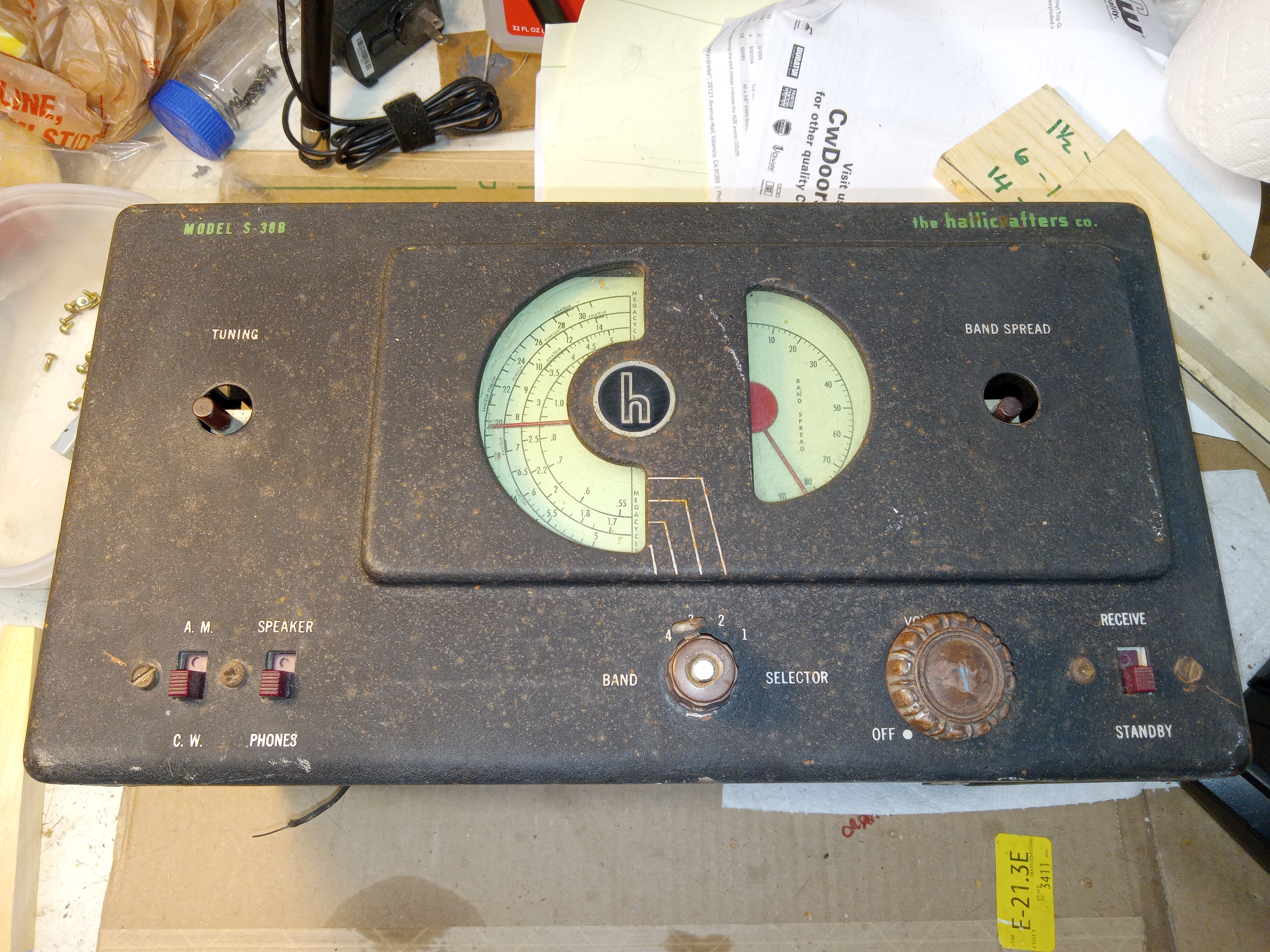

I posted about this on Facebook, and through a series of conversations I ended up being gifted an S-38B. I'm thrilled to have it and am looking forward to fixing it up. There are just a few problems...
This poor thing is the victim of both neglect and abuse.

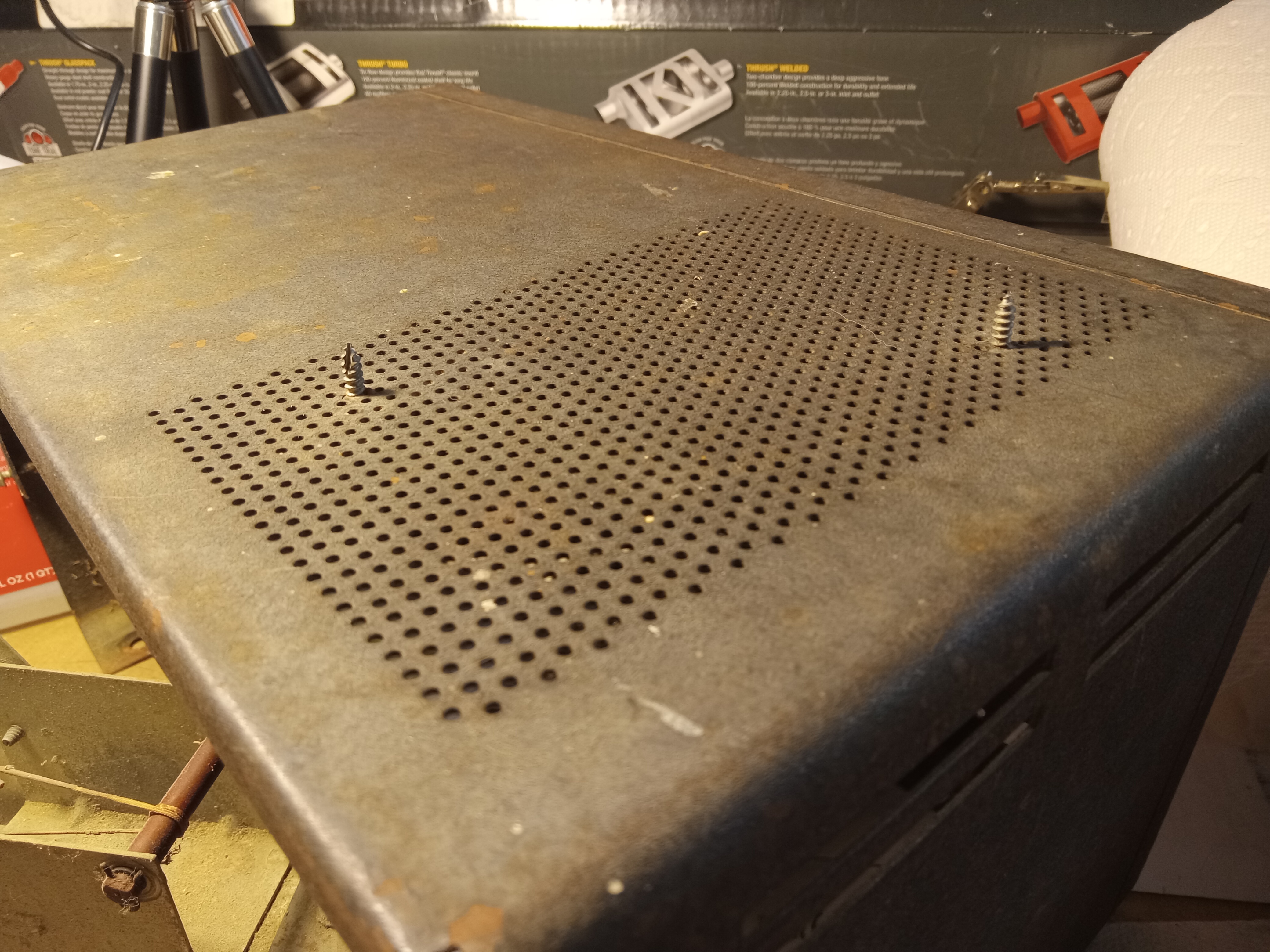

The original 5" speaker is long gone, replaced by a 3 x 5" speaker bodged into place with sheet metal screws. Of course, the cone is a wreck and it doesn't work.
The radio was apparently dropped on its face, punching the power / volume switch into the case.

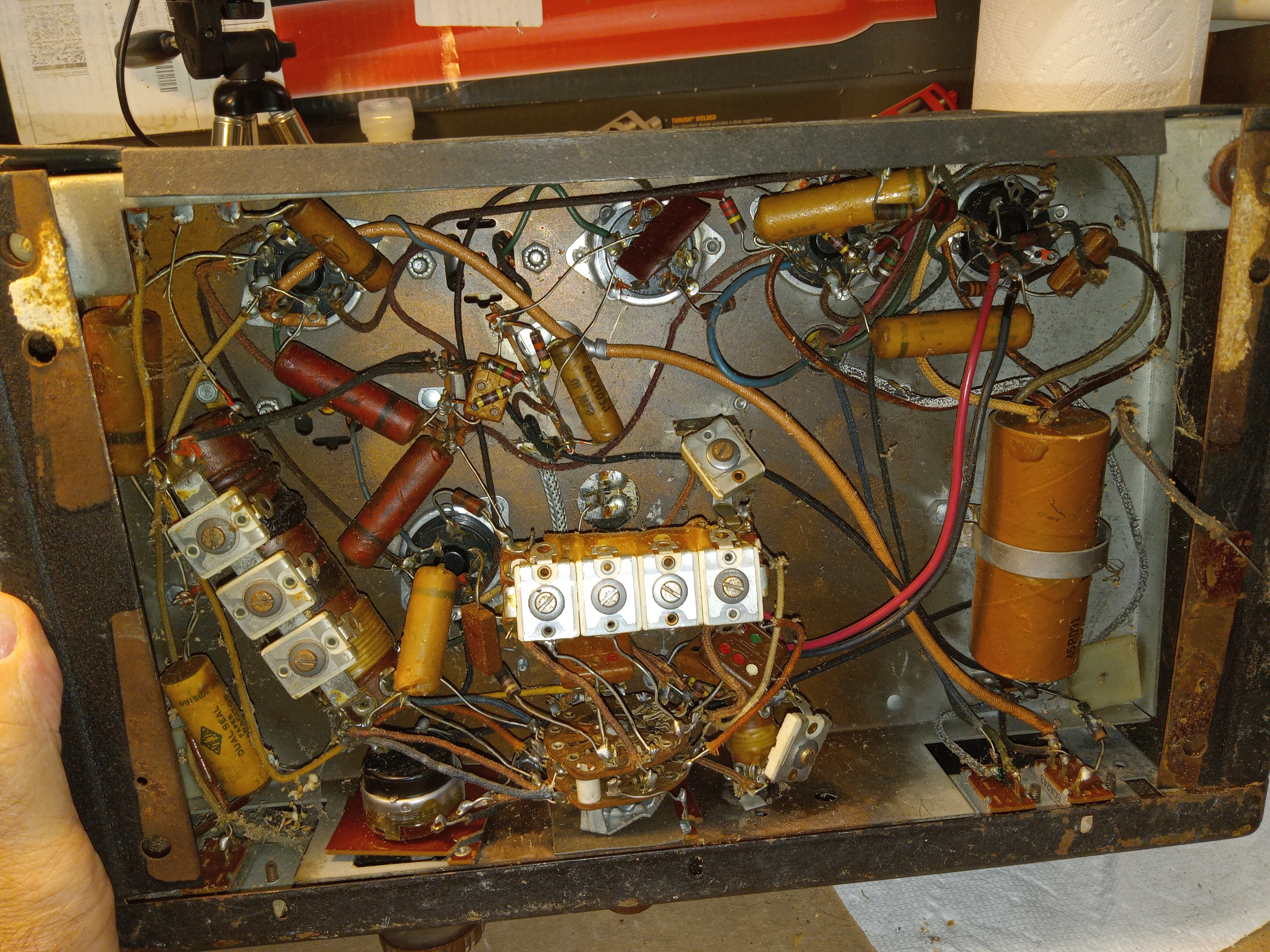

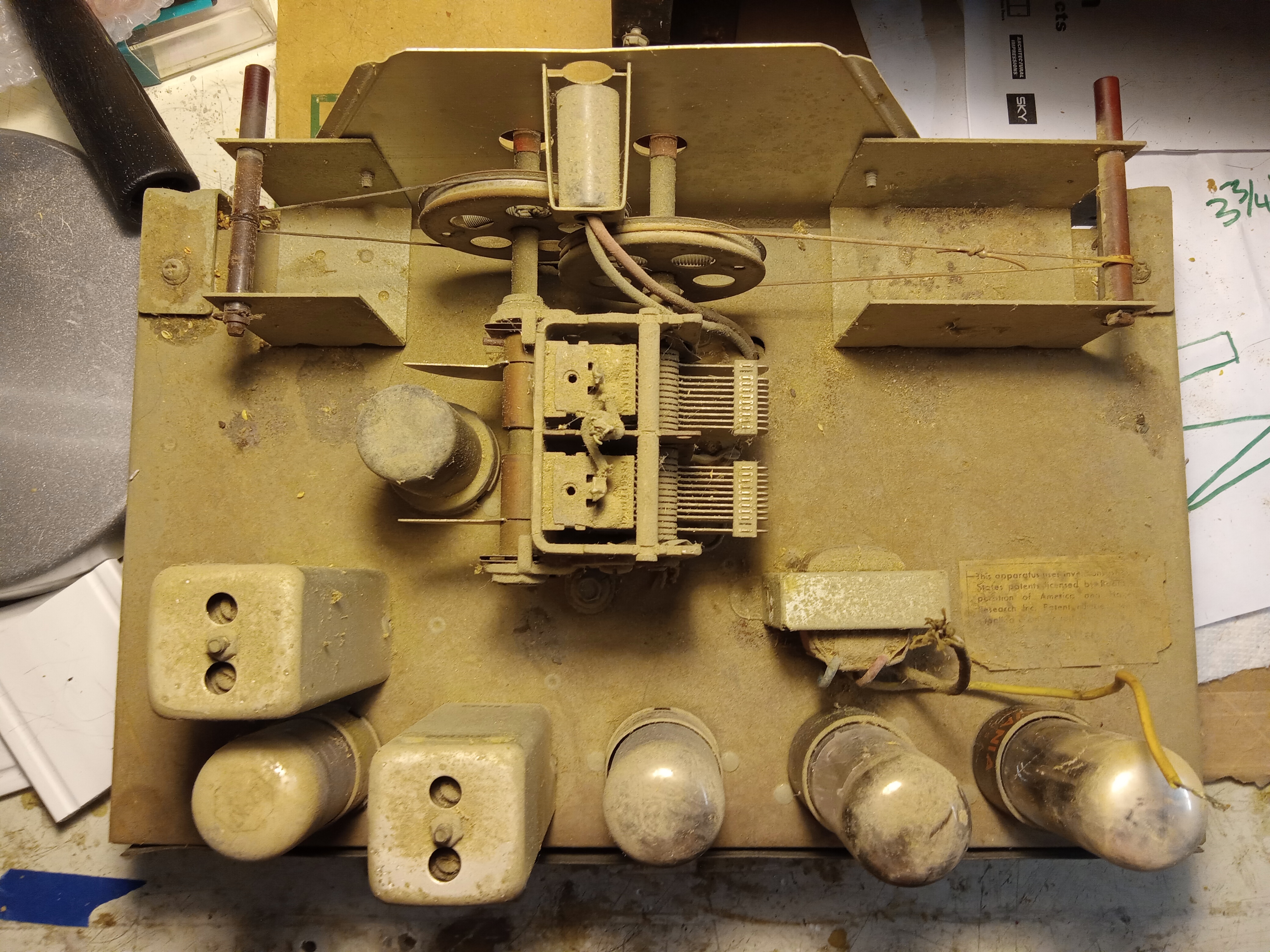

Other than that, the innards appear to be largely intact and unmolested...

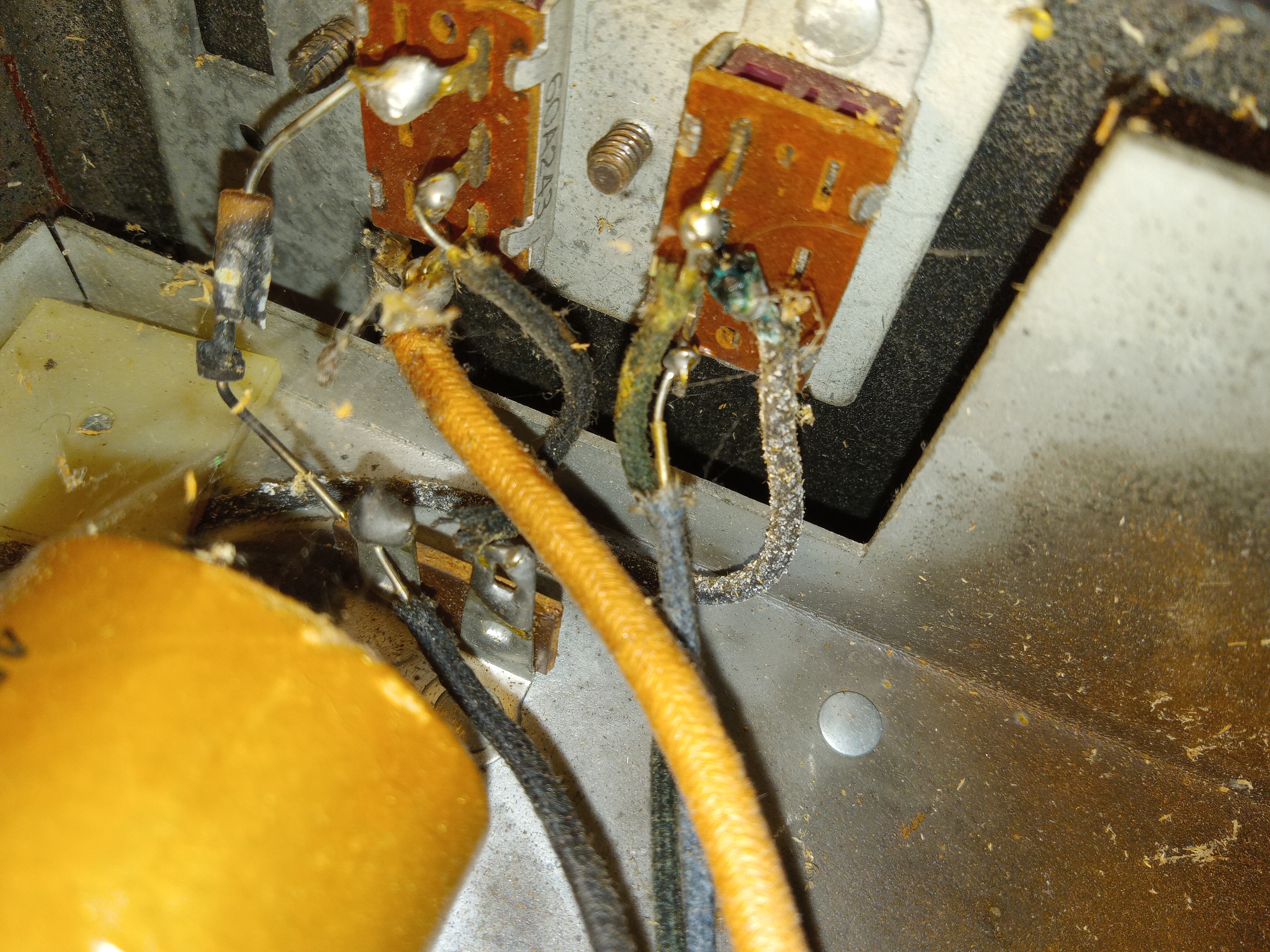

...except for this detonated resistor that's attached to the AM / CW switch. What could have caused this?
First thing to be done will be to vacuum out a bit of dust...

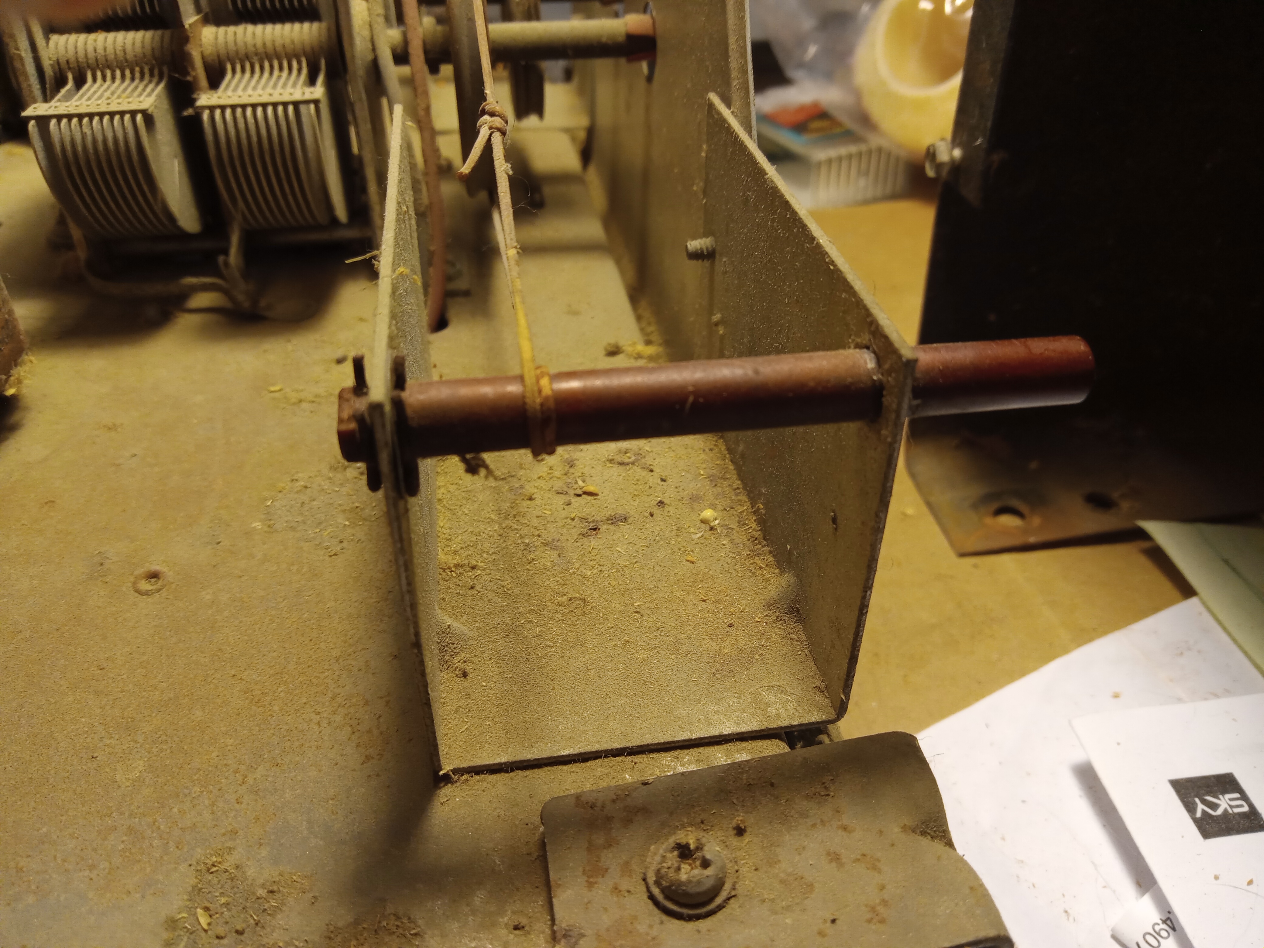

...and maybe use a lathe and some 1/4" Delrin rod stock to replicate a pair of these rods, both of which have fractured (the other one is completely missing its end).

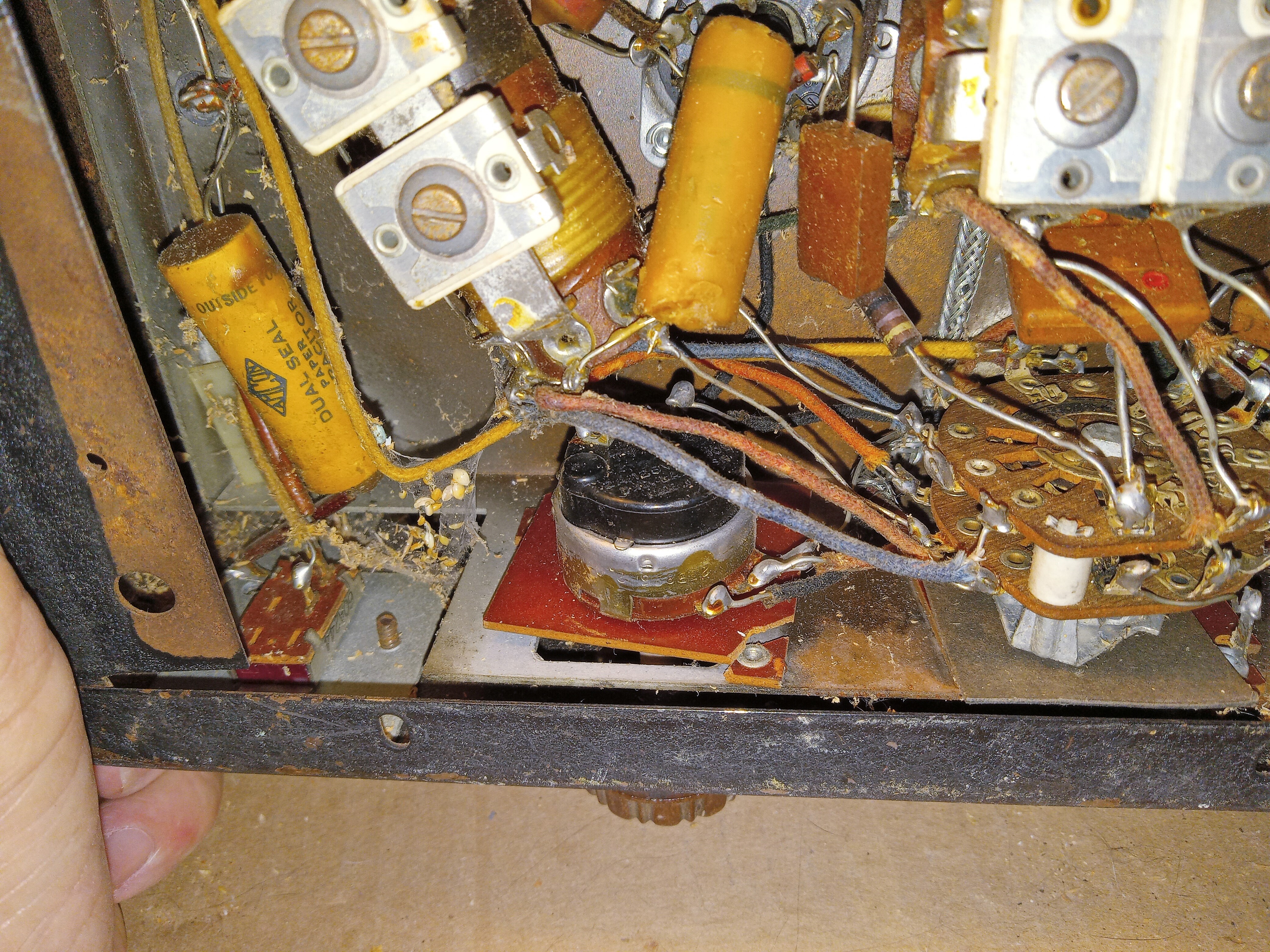

So... a fun and educational project, no doubt. I plan to replace all of those volcanic capacitors, of course, and the badly rusted case will get stripped and treated to a fresh coat of paint. I see there are both water decal and dry transfer options regarding the graphics. I have previously fabricated bottom and back panels out of polycarbonate to show off the "warm glow of electric sex" workings of tube radios, and will most likely do the same with this one. Since the knobs are all missing, I may opt to go with some retro but non-stock alternatives. Same goes for the paint finish (hammertone emerald green, perhaps?). Lots of possibilities.

I would recommend buying an isolation transformer to reduce the shock hazard. This is a "hot chassis" radio that has no transformer in it to isolate the wall socket from the chassis. Clever use of capacitors makes the chassis a ground for RF but not for 60 Hz AC.
On a good day, downhill and with a tailwind. In the real world, there is always enough 60 Hz AC leakage current to give you a small "tingle". And if a capacitor goes bad, "ZAP!". This model's power draw is not a lot, so a small isolation transformer should not be terribly expensive. Considering the potential shock hazard, it's cheap insurance.
