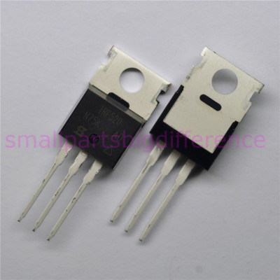

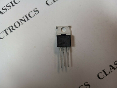

Comparing a RM3 currently sold on Ebay:
looks exactly like a genuine Vishay IRF520
The IRF530 looks a little different.
