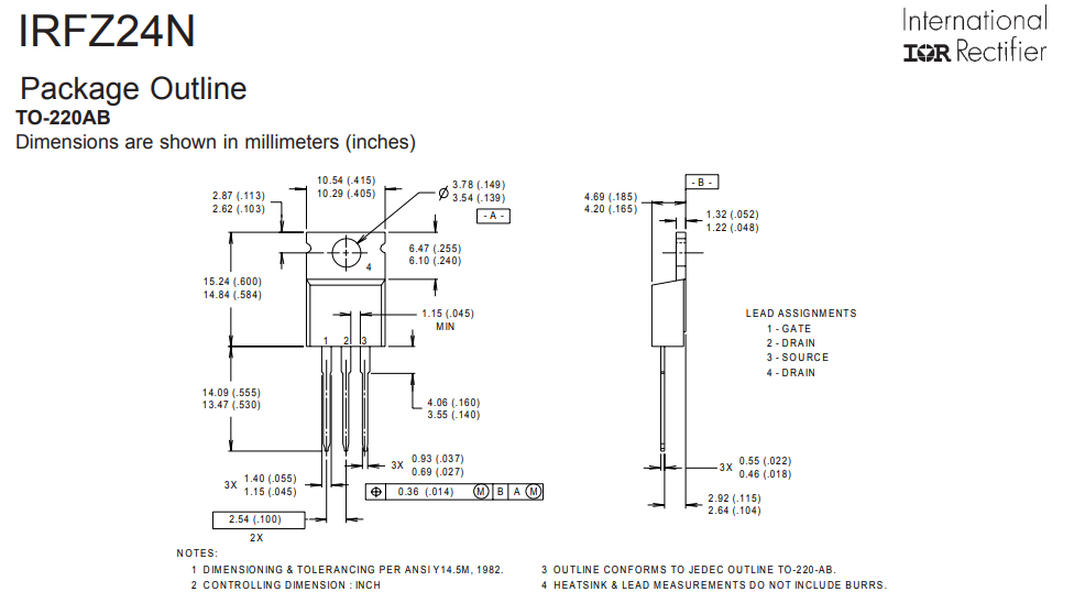

As said earlier - the part you're looking for is a MOSFET - I was only getting info for the user that cross referenced a different part for a BIPOLAR transistor
Although others will say this is a IRFZ224N part...

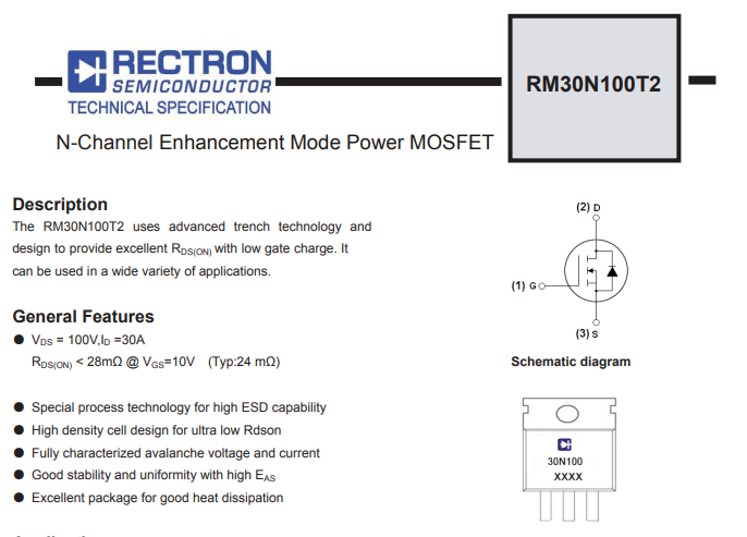

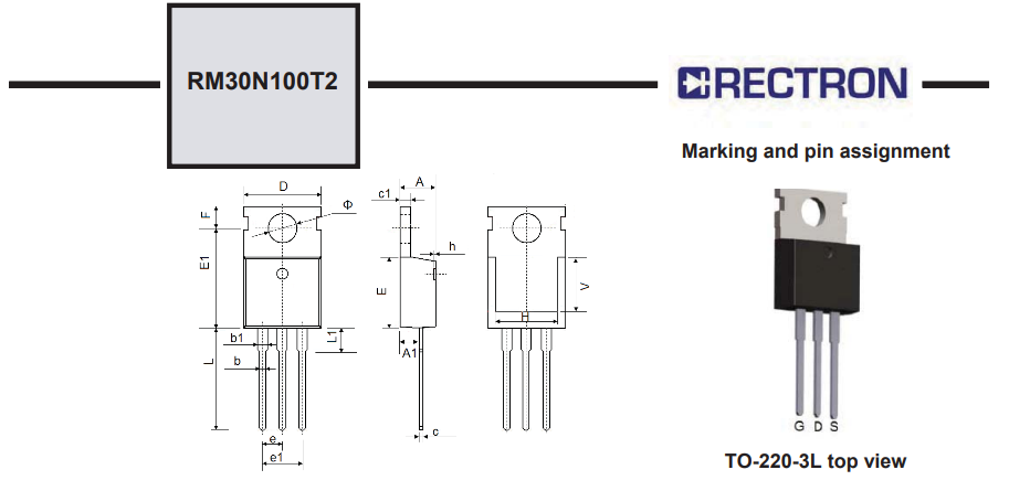

IT may also be RECTRON RM30N100T2 - a TO-220 package similar in performance...
Both Pinouts are similar Pin Assignment...
