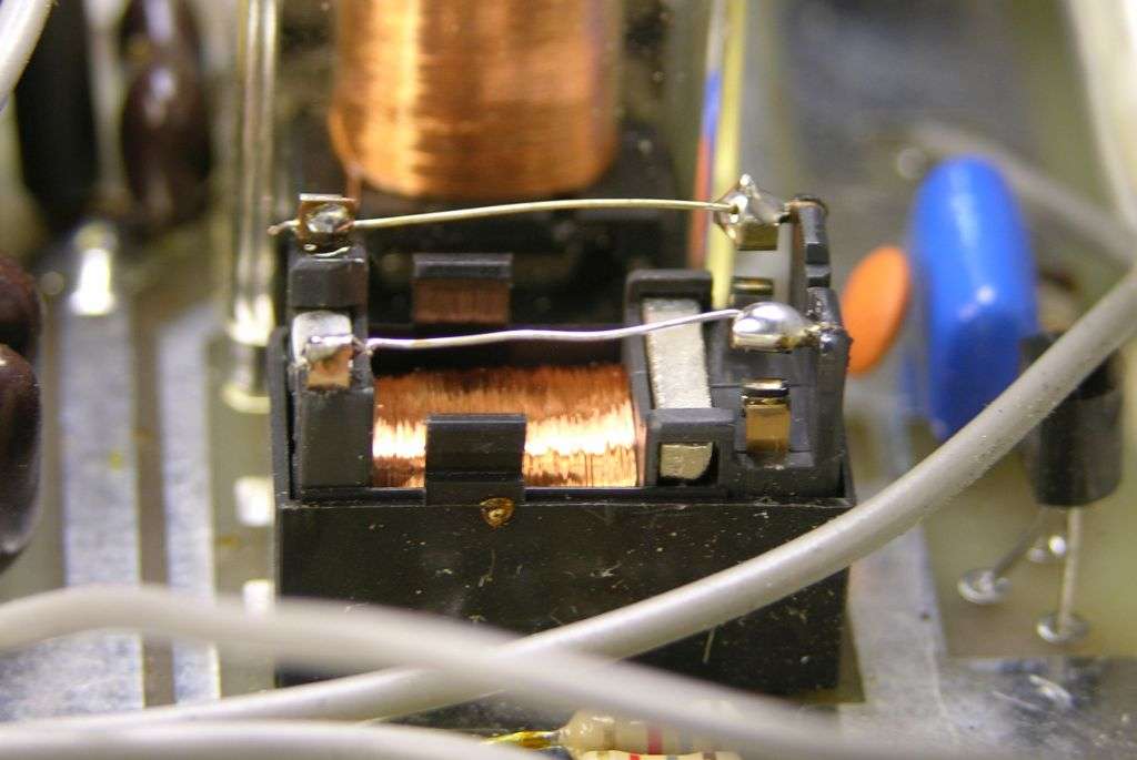

Here's our preferred fix for bad preamp relays. Mostly this is to remedy loss of receive signal with the preamp turned OFF.
If your radio can't transmit barefoot through the amplifier when turned off, this will fix that problem.
But only if the preamp relay has the transparent top cover that can be popped off to expose the contacts. Remove the lever section and solder a thin wire across each side as you see here.
If the radio receives okay UNTIL you turn on the preamp, the relay is probably not the problem. If you only have trouble with the preamp turned ON, the trouble is probably with the preamp transistor and/or protection diode.
But if turning the preamp off causes trouble, this fixes that problem.
