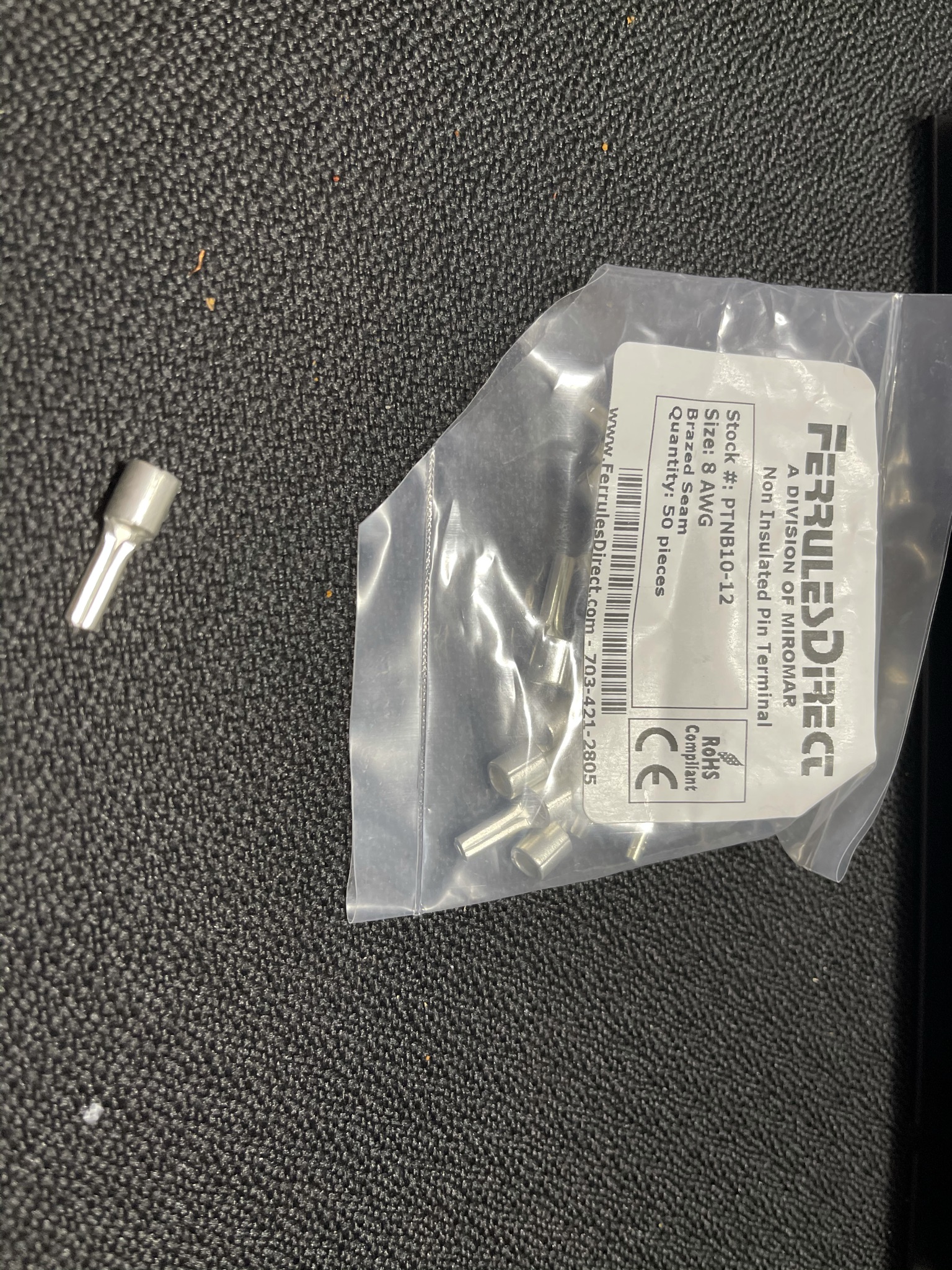

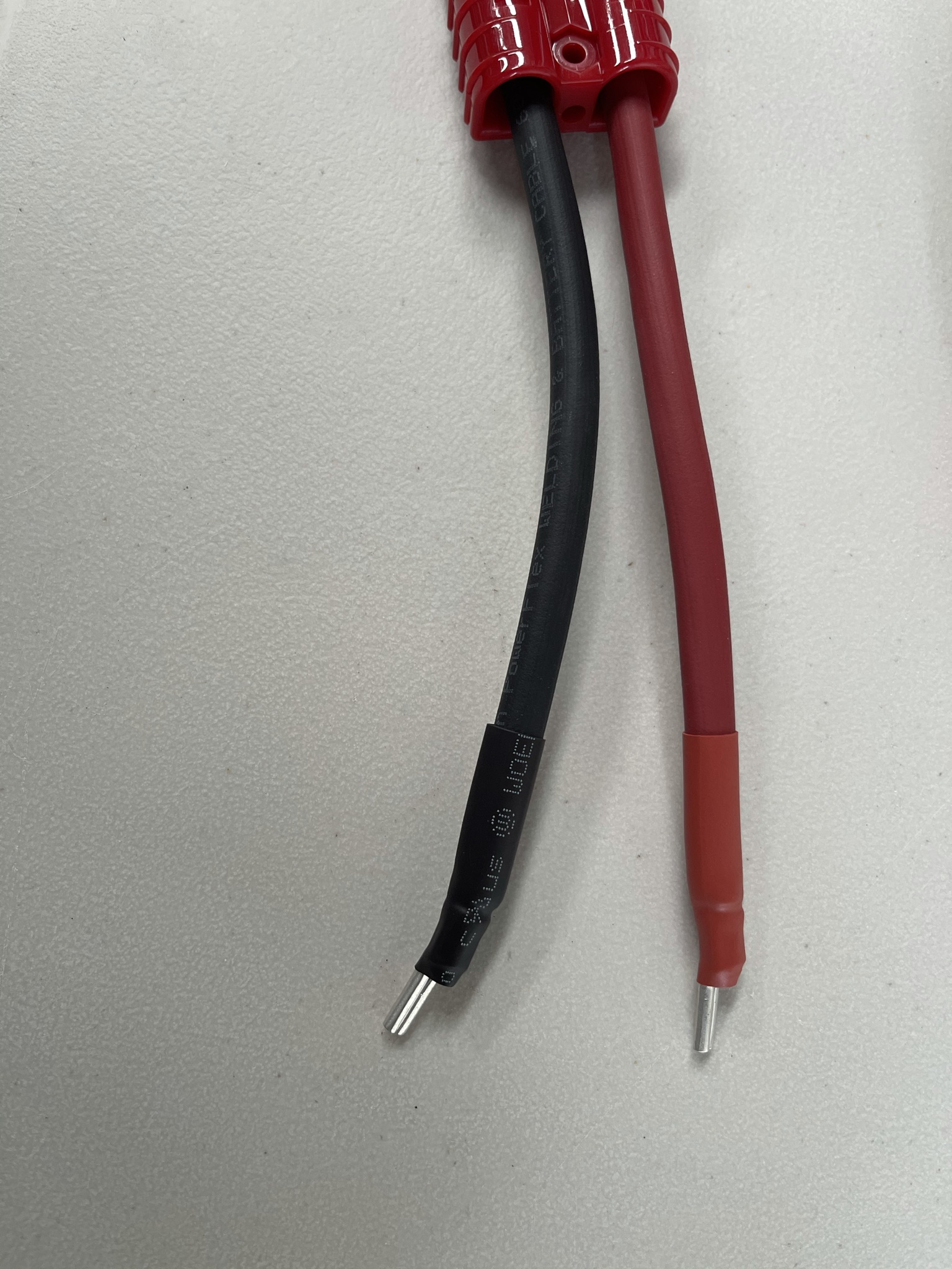

Here's how I cleaned up my DC input power. Seems the pin terminals hold the connection better and less danger of shorting since these connections are so close. I tried solder on bare copper, but they still came loose eventuality.

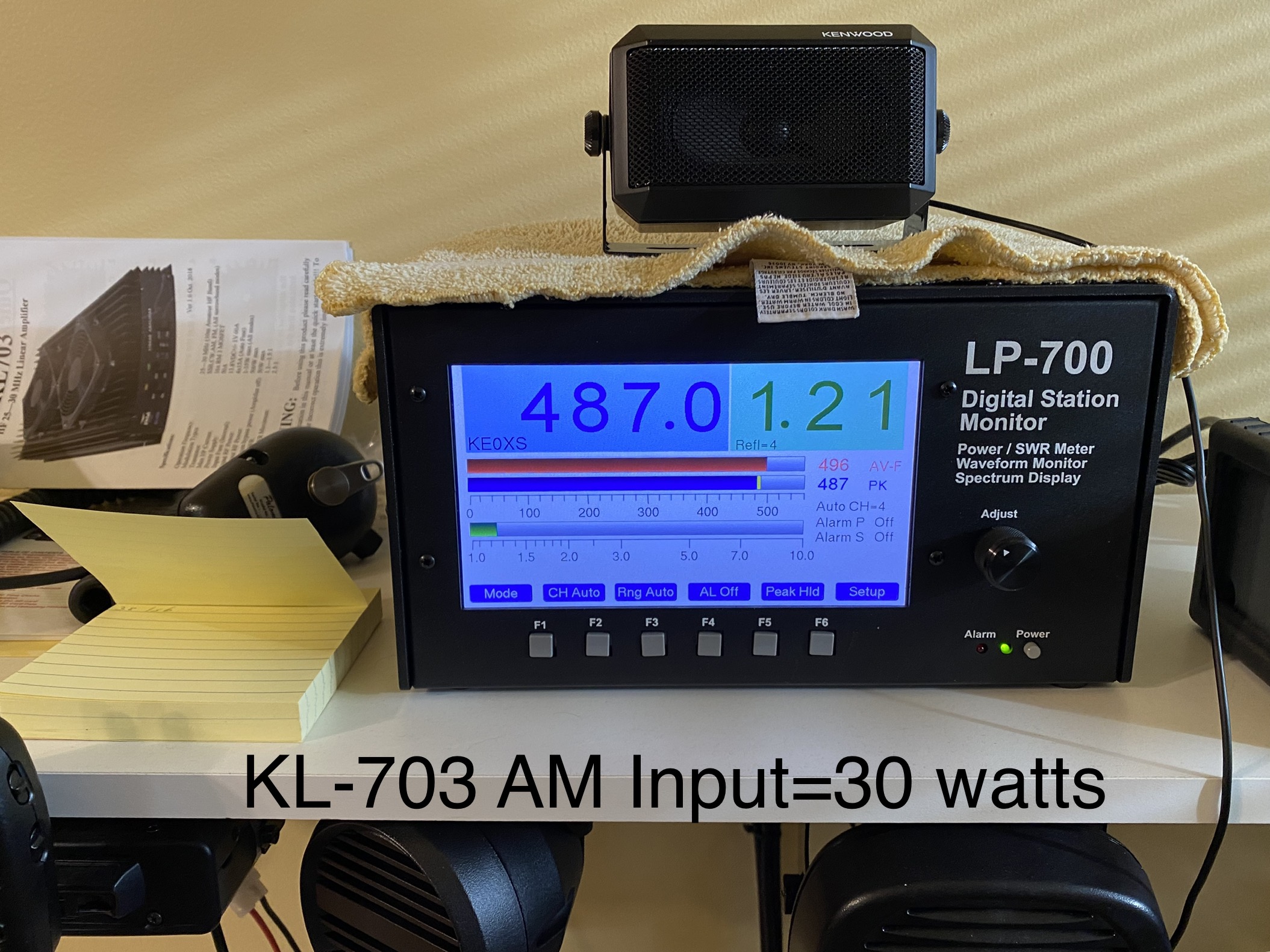

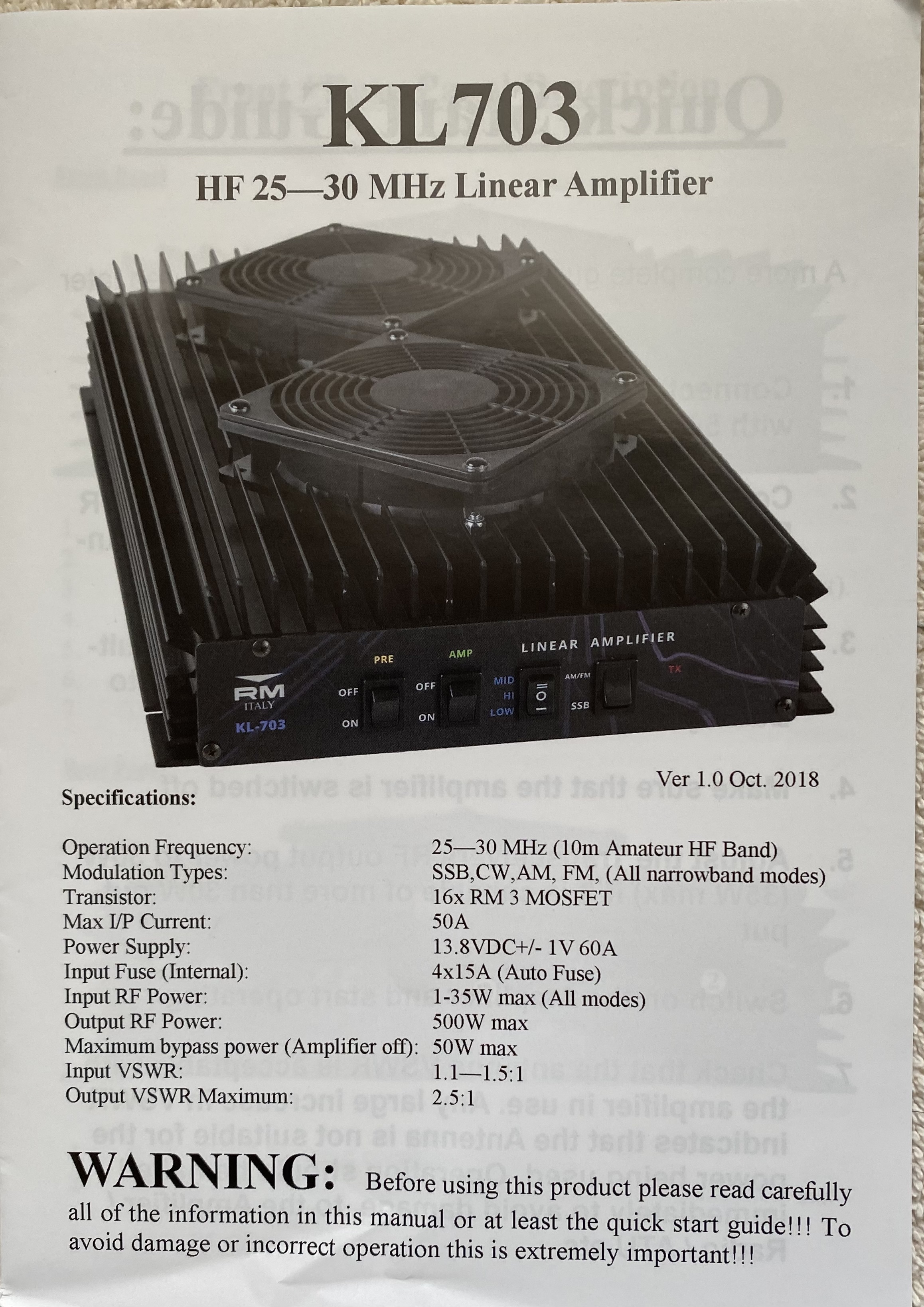

Shade…I don’t know about SSB but the 503hd does 300 on AM…I doubt seriously the 450 number. I have two 503hd. On NIB and the other seldom used.

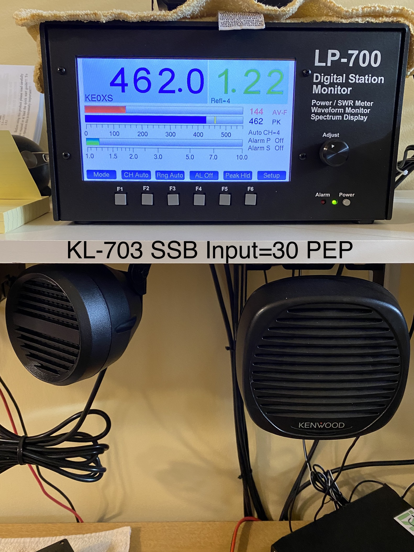

I’ll post pictures (in an hour or less) of output on the Telepost LP-700 of the 503hd output on AM and SSB…also of the KL-703 all into a dummy load

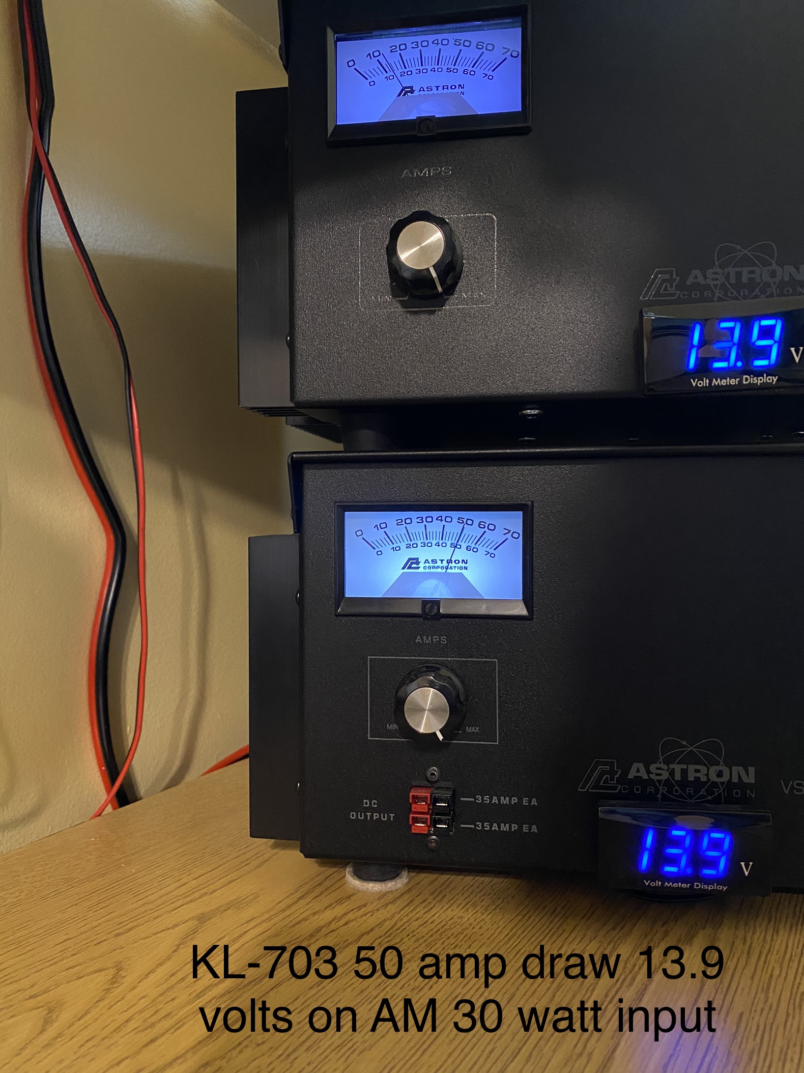

Ok as promised…here are the specs for KL-703 into my DL 2.5k Palstar dummy load running off an Astron VS70M power supply. All readings taken at 13.9 volts. Up nex KL-503hd
NON INSULATED PIN TERMINAL
Have asked at WALCOTT, HRO and a couple of shops thinking I might find on shelf
