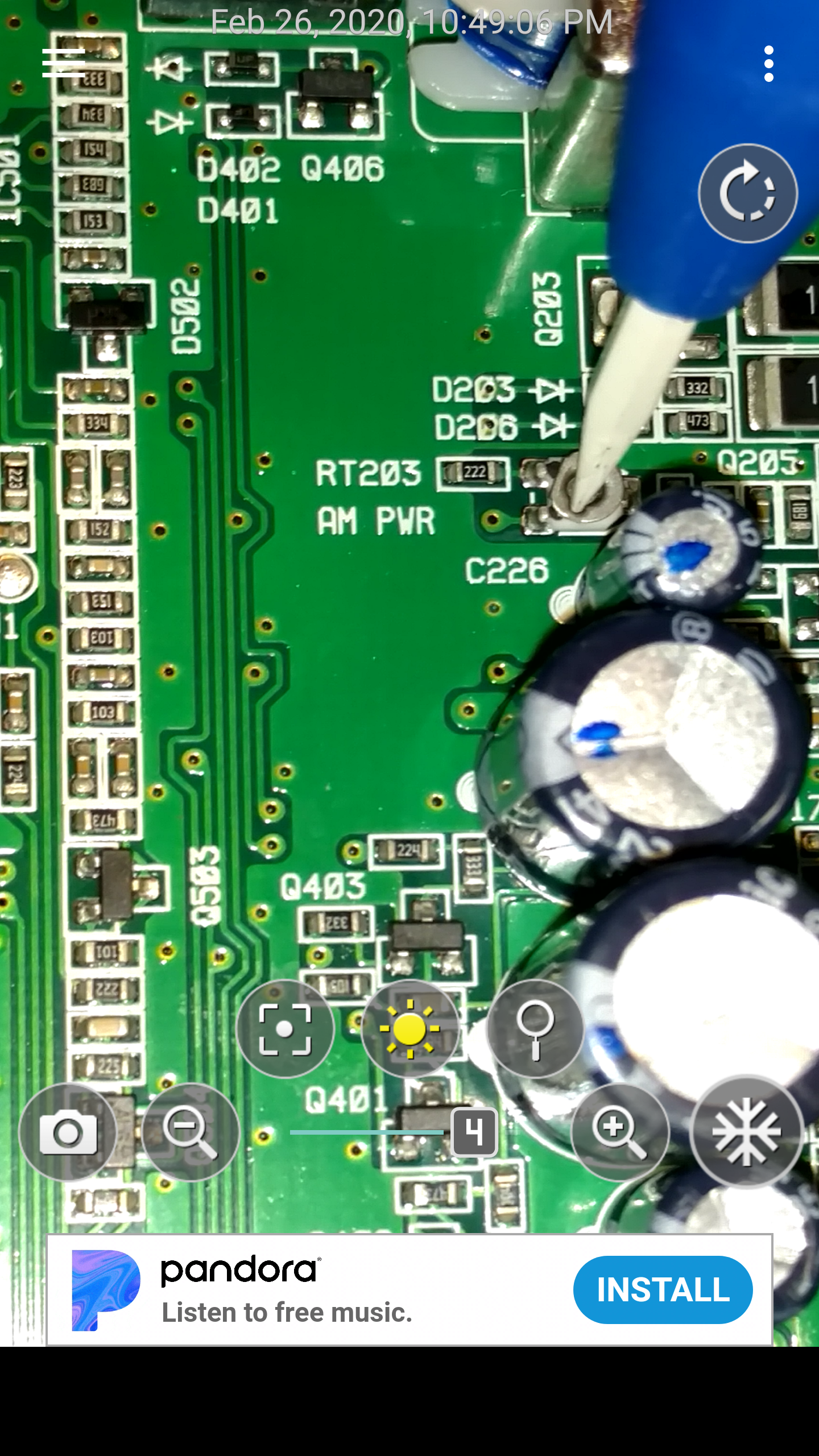

Here is the pot. Copied from another post
Cobra 18 WX ST II (don’t laugh)
ShadetreeMechanic posted this earlier.
