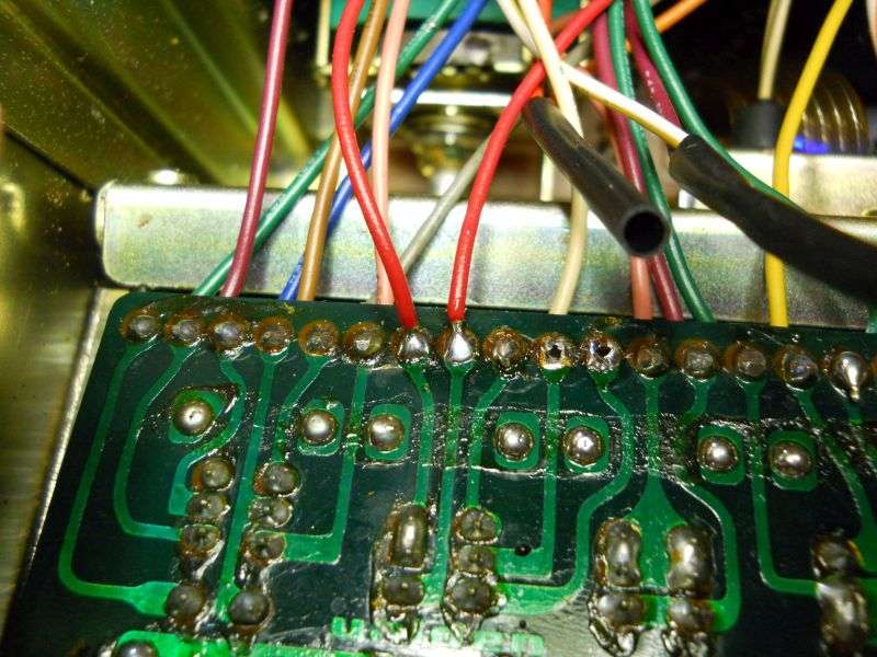

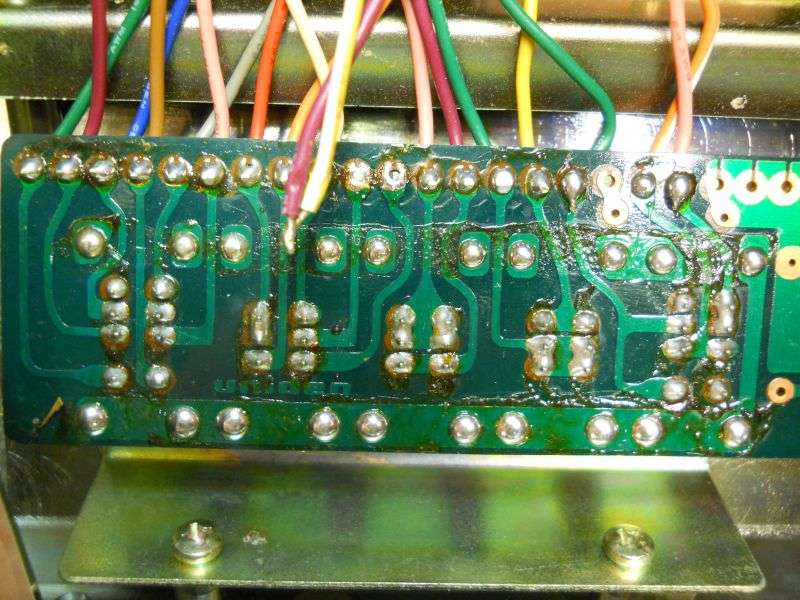

Hijacking the PA/CB switch is easy for this radio. The switch has only two poles. The pole on the outboard side removes power from the final and driver in PA. The inboard side selects between the PA jack and the external speaker jack.

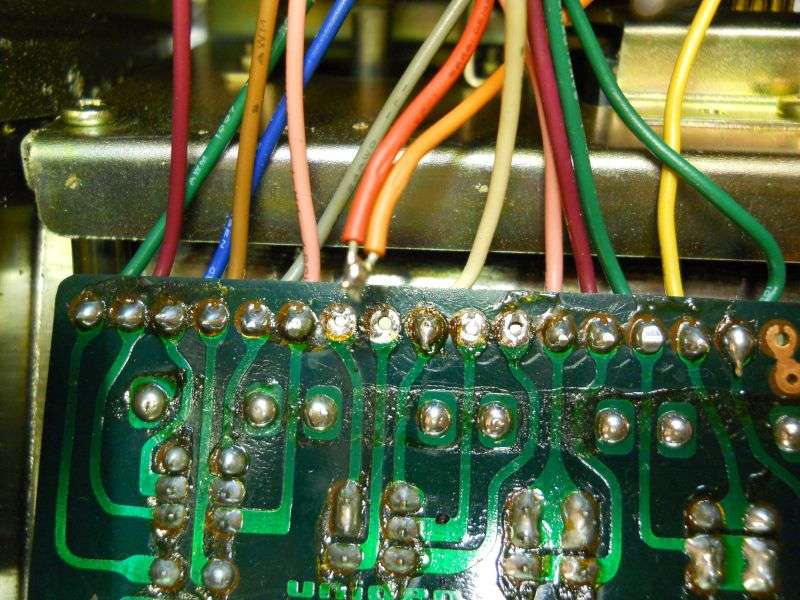

The white and violet wires are unsoldered from the pc board, and soldered together. You can slide shrink over it without a picture, right? This takes care of the speaker circuit.
The orange and red wires get unsoldered from pads leading to the outboard half of the switch. They get soldered together. This is the side of the switch we will repurpose to shut off the roger fart.

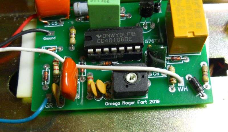

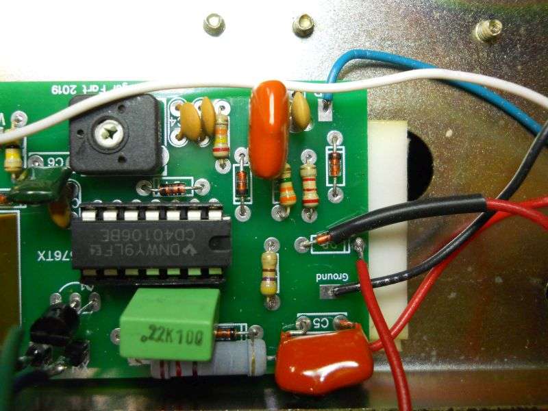

The transmit wire gets unsoldered from pin 3 on the mike jack, and soldered to the "Tx" pin of the beep. Pin 4 wire comes off the jack and goes onto the "Rx" pin.
The board's keying wire is usually green. This one is blue, but the board is marked "Gr" where it's attached. The other end gets soldered to pin 3 of the mike socket. The black wire gets soldered onto pin 1. The audio wire in this case is white. It got soldered to the clockwise lug of the mike gain pot. This should keep the beep loud no matter where the mike gain knob is set.

The green rectangular capacitor marked ".22" in the first pic is a mod. The original cap was a 0.1 uf. Made the beep about a half second long. Customer said make it longer. Doubling the size of the cap stretches it out to about one whole second.

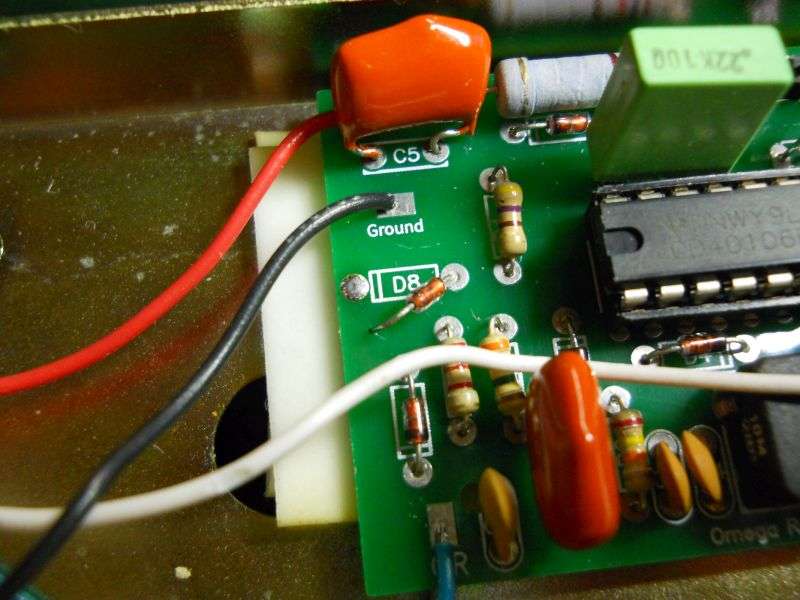

I find this a crude approach. Here is a diode that will provide a true "Off" for both the delay and tone. This diode, marked "D8" on this board, gets one lead unsoldered from the board. With this connection broken, the beep AND the delay will both be disabled.
A wire goes to the free end of the diode, and another wire to the pcb foil pad where it was removed.
And here we find ourselves back at the outboard side of the PA switch. Our two diode wires go to the foil pads where the orange and red wire were removed.

Those look like franks boards. There is another way to stop the Roger silence I do it on the solder side. I’ll have to try your way.
