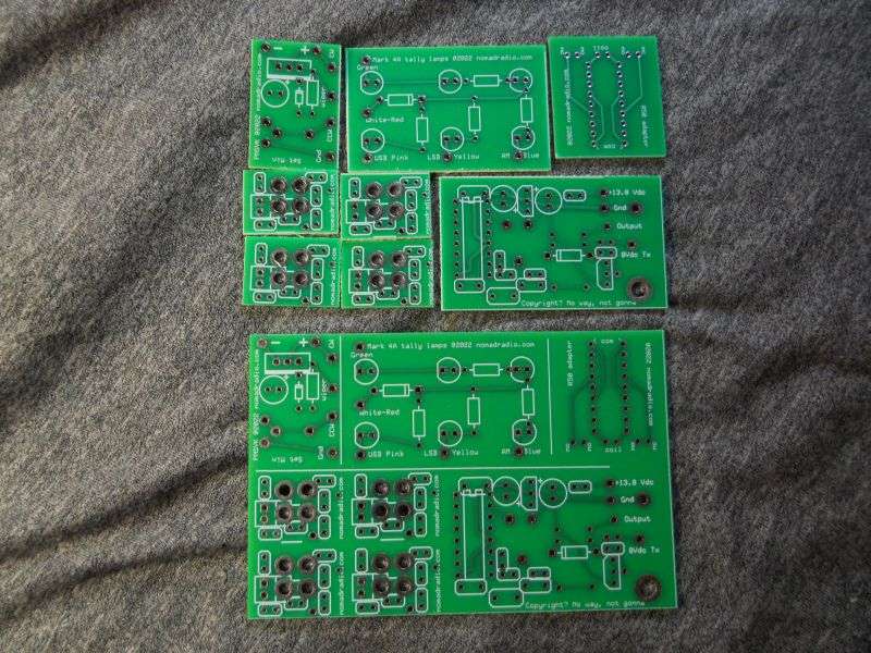

Once again, I have run out of or run low on some of the tiny circuit boards we sell. The only economical way to buy them is combined on one larger circuit board, to cut them apart later.
So here is this year's restock.
Some of them will look familiar from our fleabay listings, others won't. I'll only bore you with one of them for now.

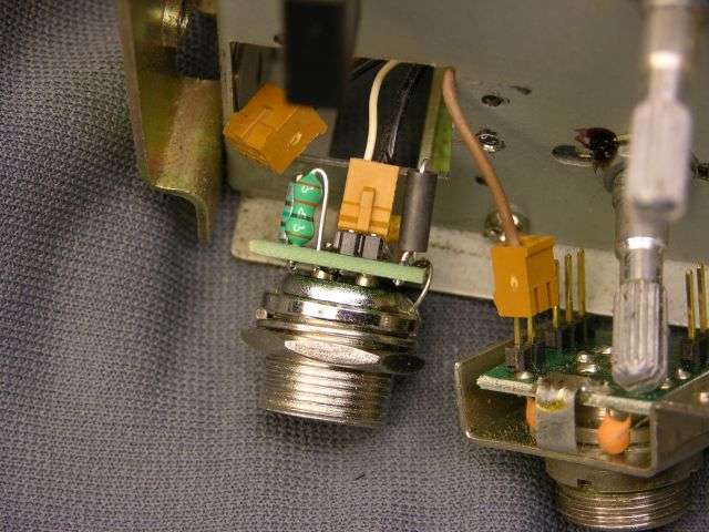

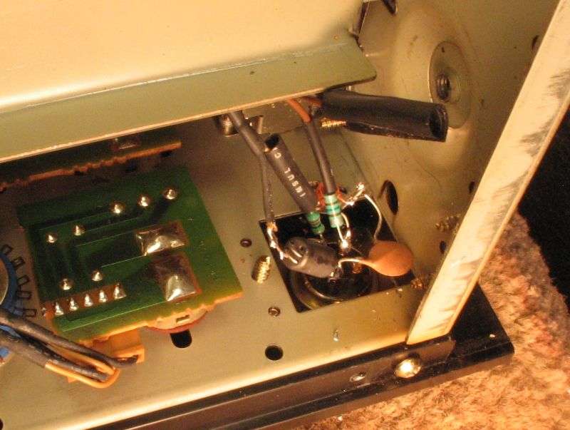

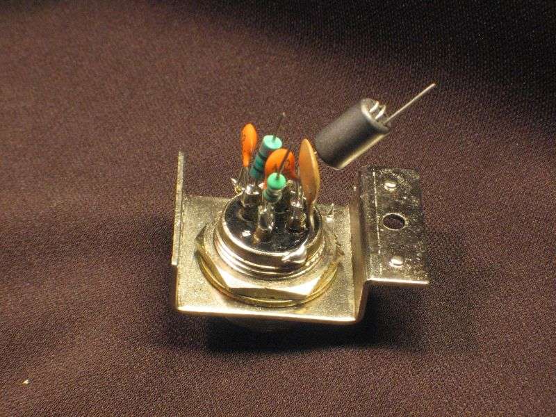

So we started copying the factory filtering/bypassing setup onto the back of a 4-pin mike socket. All very well and good, but a bit labor intensive.
The drawback is no more up/down buttons on the mike. The advantage is that the mike socket stops coming loose from the radio.

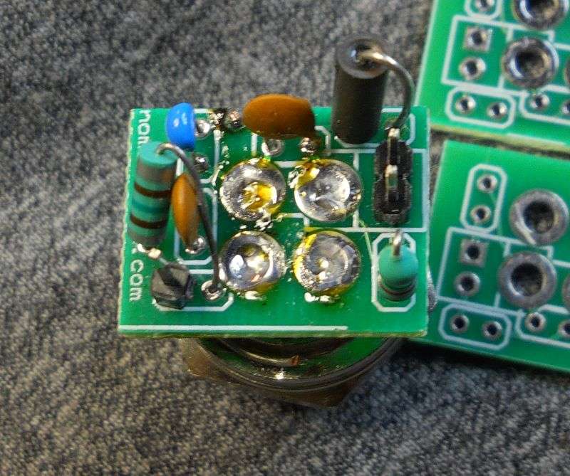

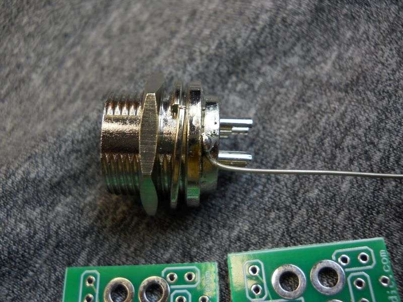

So the trick got moved to a printed circuit board. Saves labor, pure and simple. Made a dozen and a half of them, and they lasted almost a year. Made another batch that size and they lasted six months. Time to go for a larger quantity. Our circuit-board vendor has a discount at fifty units, so that's what we bought. With four of this pattern on one corner, we'll see how long it takes to actually built two hundred of them, let alone sell them all. It starts with soldering a chassis-ground wire to the mike socket. A real factory would use a fat ring lug under the socket, but this is cheaper.
Takes three RF chokes and three disc capacitors, since only three pins are connected. The RCI-made radios don't require a receive function on the mike.
And if you want to solder some custom feature to pin 4 you can do that, of course.
And this is the biggest selling point for this toy. No soldering required. The pins you see will match up with the two-pin audio plug and the one-pin transmit plug just as they unplugged from the factory mike socket's pc board.
Plug and pray, no soldering iron needed.
