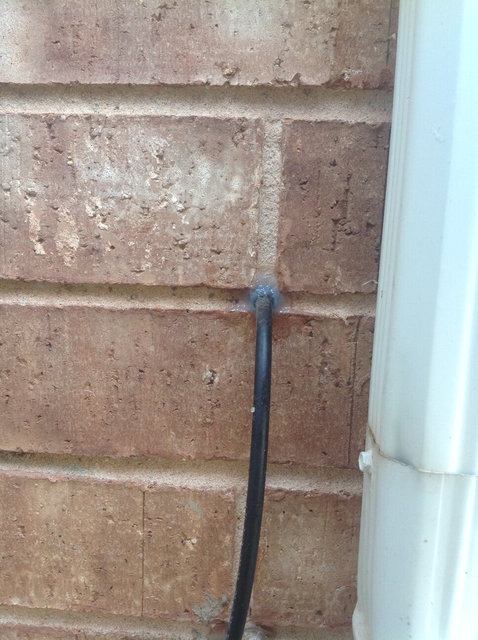

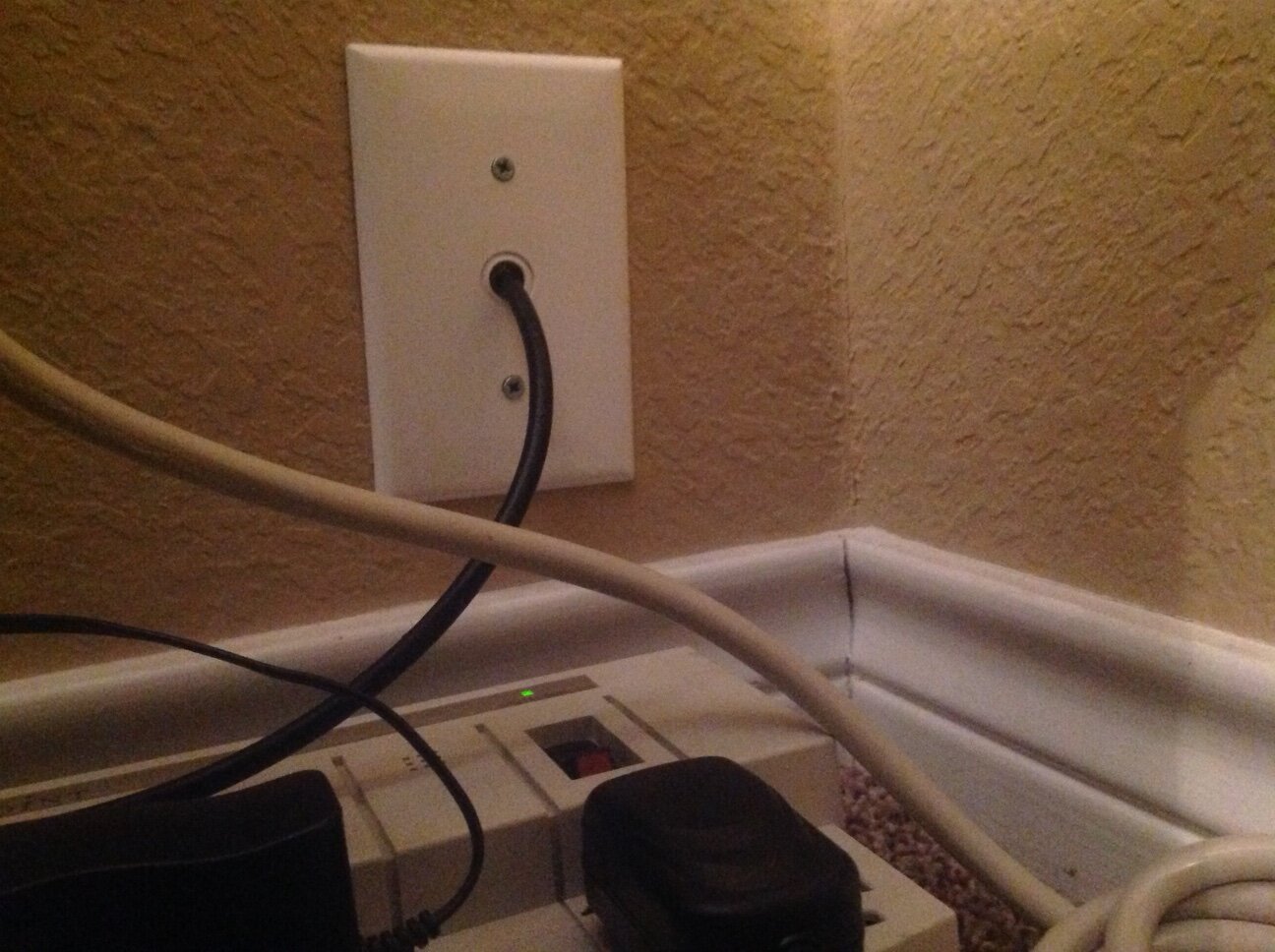

I simply drilled a hole through the brick mortar and inside wall. Sealed the outside with silicone and placed a plastic cover inside. Here's my question. If planning to build a new home or ham shack in back yard, what's a good way to handle this during construction rather than after the fact? Especially if using larger or additional cables. Pics would be great. Thanks!
View attachment 28044 View attachment 28045
This is how I have been able to get many of my satellite installs done on brick homes. Older brick homes and no coax to where TV was going to be. Easy peasy. I could also put a coax feed through grommet into the hole and seal it up with some silicone. A plate with F-connector inside and I was ready to install the satellite box.
