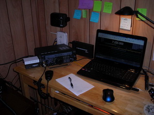

Here are some pictures of the shack now that the IC-7000 is back, I have everything situated the way I want it..
Looks really nice.
