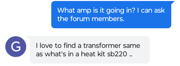

Thanks Nomad, I will pass that info on. I don't know what he plans to do with it, or if it's even going into a SB220, I just assumed. The Peter Dahl transformer is 860-1171 volts, and I guess he knows that. Maybe not. He said an original would be fine, and I'm guessing it doesn't go over 1200 volts so I don't know where he got the 1800-2200 volt figure unless he is dreaming. It could be a project box he's building, I remember being asked about a transformer about a year ago.
I asked what amp it's going in, and he said
He might have a plan, but I don't know and I could ask but I really don't care. My part is done.
