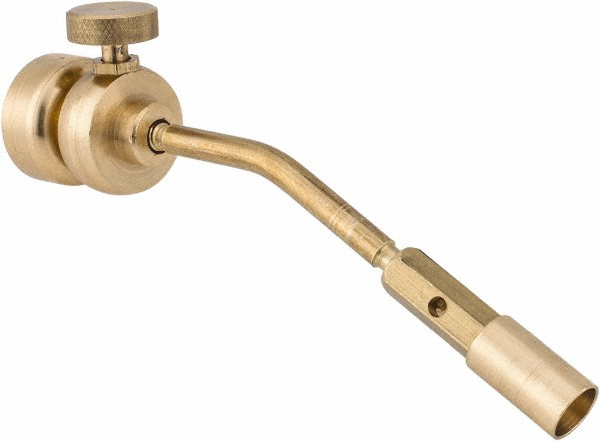

I've used this Butane Micro Torch on those crimps. You should be able to find for less than $10 if you shop around.
Doesn't the Hemp shops sell those for the crack pipe smokers? :ROFLMAO:
Those work great especially for quick outdoor solder jobs.
