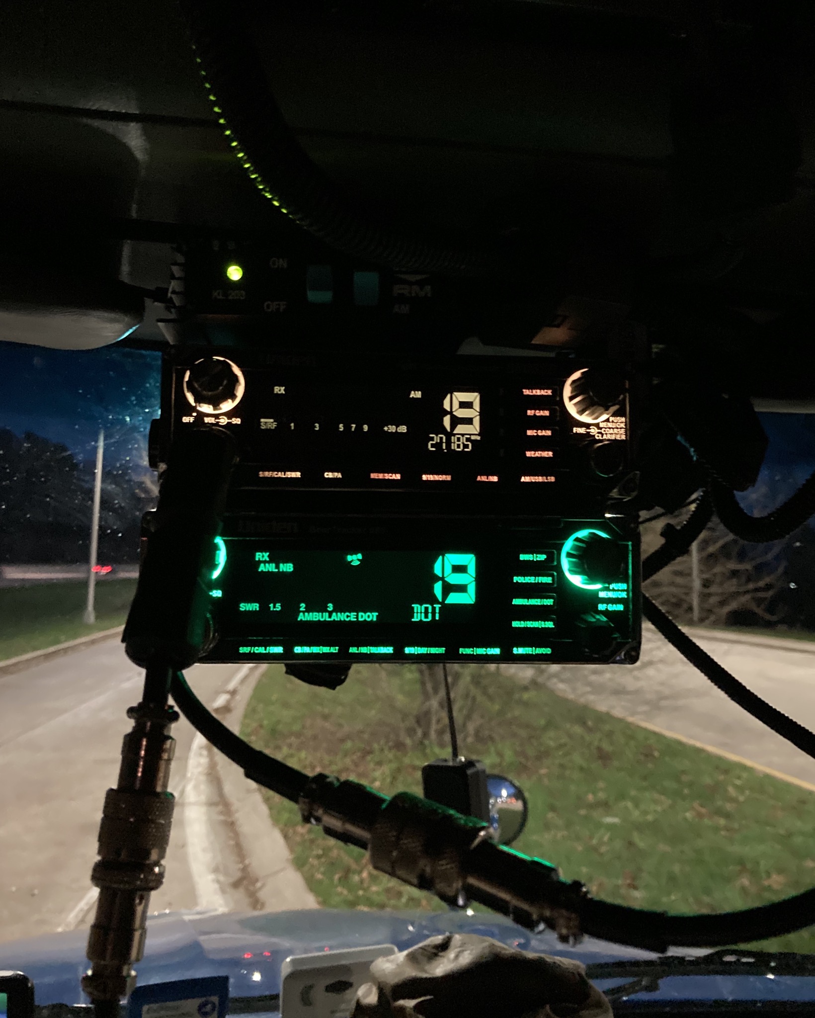

The 885 will be the AM-19 radio.
Always on and run thru the truck systems
The 980 will mount below it and used as the CB Scanner. Antenna is the spot mirror bird perch from above. RX only.
Two separate speakers.
I can switch coax between the two to use the 980 for TX.
Extended-length mount for both, radios Velcroed and zip-tied together.
Pic to come

The 980 is powered but I haven’t yet run the coax. Also need to place Speaker.
The 885 is a better scanner than the little 355 (no surprise; see specs of both), but two (2) hissy Unidens and my WM Radio ClearSpeech DSP Speaker temporarily out of commission is TOO MUCH.
Before getting underway again I’ll swap coax. Run the 980 as the main(TX) radio so as to get advantage of the better antenna system.
The 885 will (maybe) monitor 19, but I’ll use it primarily as scanner.
Reinstalled the little TRAM whip for the second radio and wound coax a few turns thru an FT-240/61. Mix 31 snap-on at radio end. With the Uniden ESP-20 Speaker sibilance is down. That speaker is across the cab.
When AM-19 has traffic, the AM Scanner has traffic, and the Scanner-scanner has traffic . . . wow.

Starting fourth day. Swapped coax.
980 (CB Scan) on main antenna.
885 on its three dedicated antennas.

As installed. The 885 gets disconnected and put away today. Will finish this trip with just the 980.
