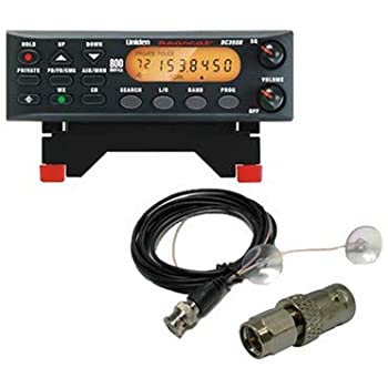

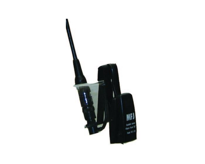

Bought the very basic analog Bearcat bc355n as it’s inexpensive, and took a little more time to also buy an MFJ 310 window-mount for a handheld antenna (compatible) to hook off the passenger glass.
A). Haven’t had a scanner before so the whole thing is new;
B). And the desire is to program in everything 11-Meter can do joined
to operating mobile.

I have an MFJ-310 on the way, and the first of a couple of antennas I’ll try. (Goes on window glass; coax stays inside).

I’ve barely run it on other bands. No real interest (and one needs to go up quite a ways in price to move from Analog to Digital), so that’s a topic for another thread.
It’s quite compact. The controls are easy to use and intuitive. Nice feel to Vol & Sq. LCD screen washes out in bright light, but that’s to be expected.

Scanner set to CB only (or 25-28 MHz) and using the supplied suction-cup wire antenna, I can get the VERY strongest signals at about 150-yards out ahead (same or opposing directions) the past 3-4000 miles.
Don’t have a UHF-BNC adaptor of the right type to connect the bc355 to a CB antenna. The antenna is an obvious weak point.

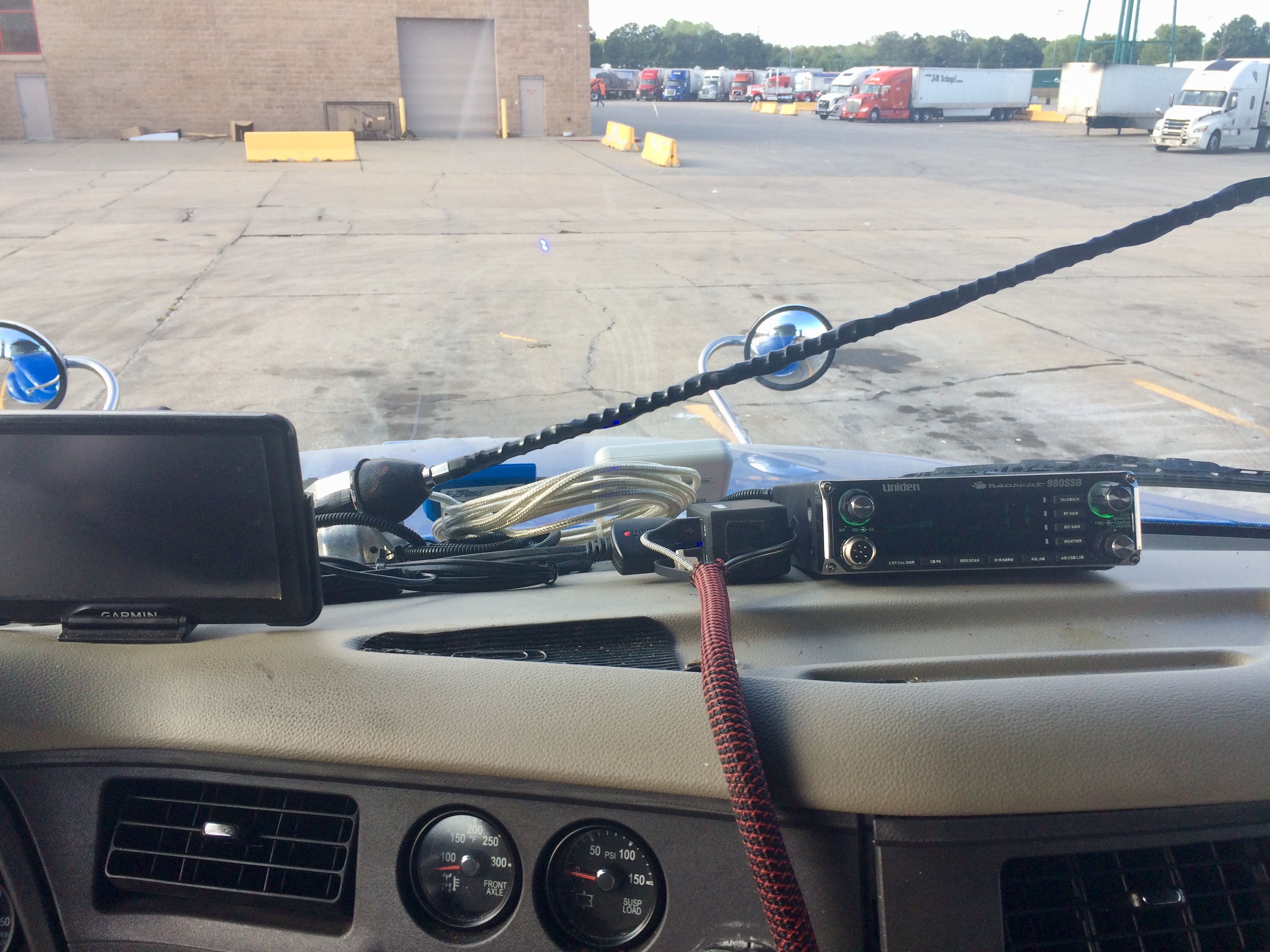

Using a factory antenna across dash as test this morning:
— Uniden 980 set to RF-Distant.
— Squelch is at 5/8-closed.
On AM, I get trapped on the Superbowl. Howling idiots.
On LSB it’s more effective (thus far).
With right adaptor will baseline using truck CB antenna pair.

2). and as against antennas I wind up trying to use with the MFJ-310.
