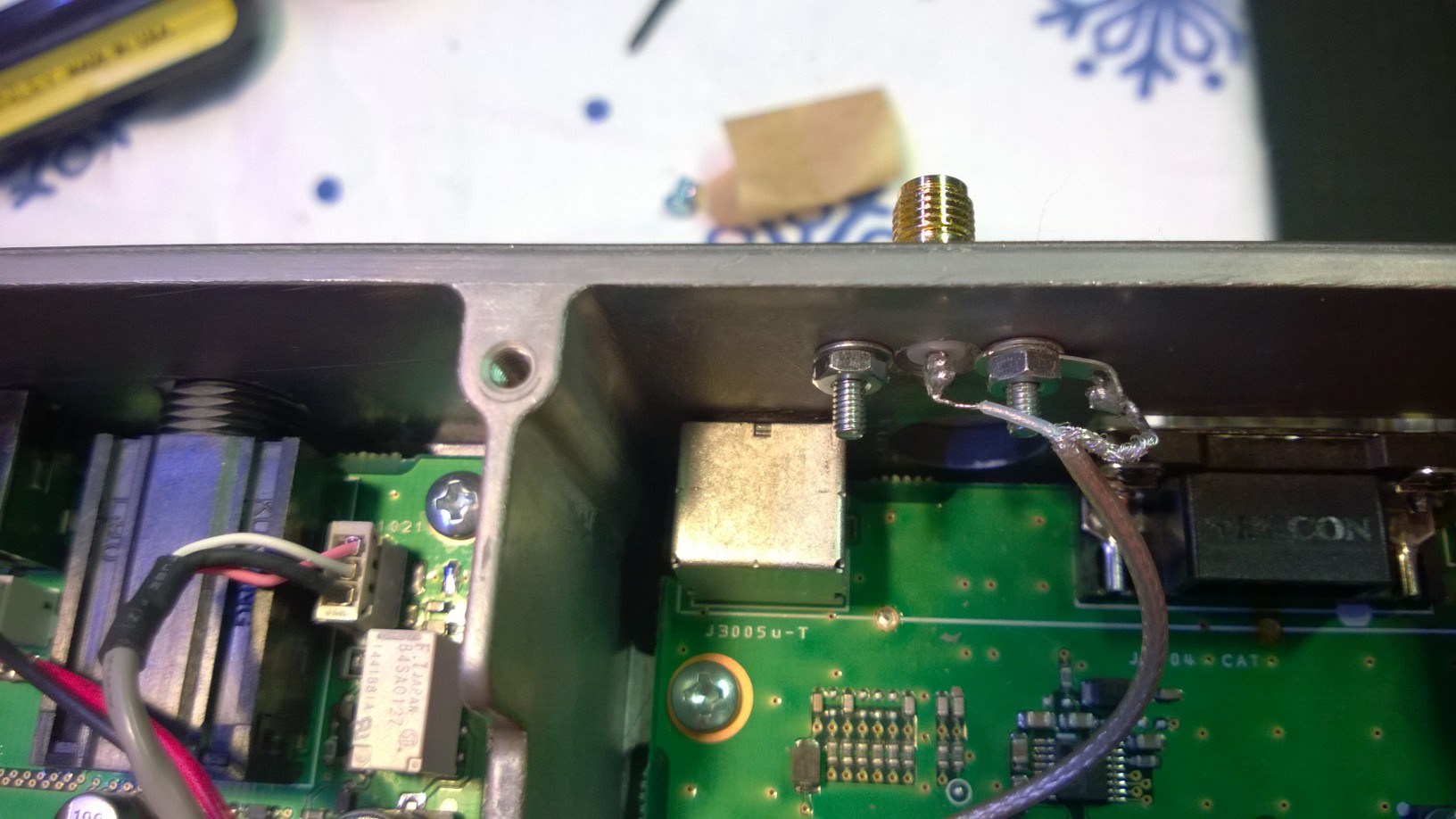

Well I did something I've wanted to do for a while now and that was to purchase an SDR dongle. I bought one from NooElec and got it working with the HDSDR software. Pretty cool but the dongle covers from 25mhz up and I wanted to use it on the lower bands. If I used it as a IF based pan adaptor for my FTDX-1200 then I could. So, the next step was order the IF tap kit from G4HUP.
The kit isn't for the faint hearted which I am when it comes to soldering around these tiny smt components and drilling holes in my pristine radios case.. But after an hour of sweating and careful hookup I got it installed. Soldering the wire to one tiny leg of a miniature relay was tricky. The rest was fairly easy and it works!
I have signal going to the dongle and it tracks with the rig but I can't seem to get the HDSDR software to read or track the correct frequency. It also doesn't seem to be exactly on the same frequency as the FTDX-1200. Close but not exactly and I know it's in the software configuration. There doesn't seem to be a good tutorial out there explaining how to set it up. I found a Youtube video that explains setup fro the FT-857 but the op is also controlling the rig/SDR software with HRD. DO I have to run HRD to have full use of the SDR software?
I'd appreciate any input from anyone using a similar setup. Thanks!
Here are are few pics of the G4HUP kit install. Total investment including dongle, IF tap it and cables was about $70.
