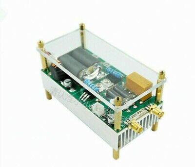

See thru amplifier
Might be a nice driver.:whistle:

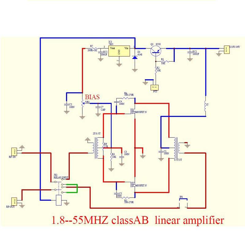

So how does a MRF 1920 work at 1.8-54MHz ?
https://www.nxp.com/docs/en/data-sheet/MRF9120.pdf
@Mudfoot However :) , See the similarities to ...

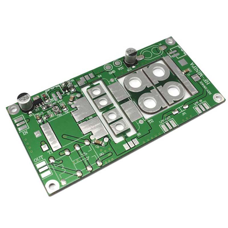

Anyway I was looking at the board and it seems to be used for not only the MRF1920 but the pair of plastic no name TO-220 devices as well.
My thought was (is?) to upgrade to 50V components and stuff the MRF101/AN-BN in it and see if I can saturate the output transformer

No, I wouldn’t operate the transparent version as is either. Besides RF issues, those SMA connectors would be replaced with SO-239’s. A metal encasement would take care of both issues. At least having the amp already assembled will save time and possible errors. The Chinese seem infatuated with using SMA on almost everything these days. IMO it’s bad enough they replaced the durable BNC’s with those fragile connectors on HT’s, now their using them on HF. We’re certainly not dealing with 900Mhz or higher. I particularly like the workmanship this guy did with his amp.

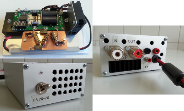

Sounds like a smoked RMItaly amp case would work good as a project box for the see through design.
I think it is a bad idea.
With no metal case, it has no RF shielding ........
Just sayin' ........
The MORON building & selling them does NOT care about anyone but themselves & any result of RF damage to them.It's CHEAP make a quick dollar & Run.
