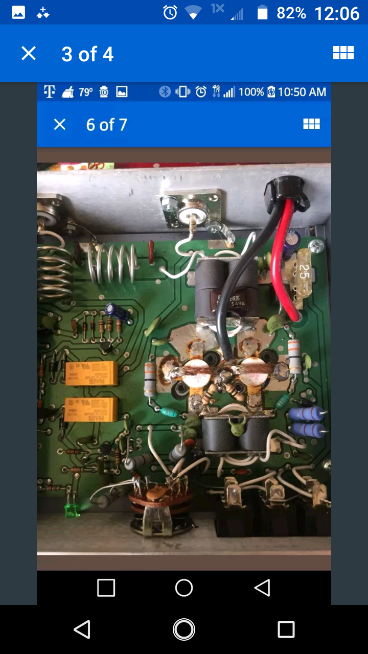

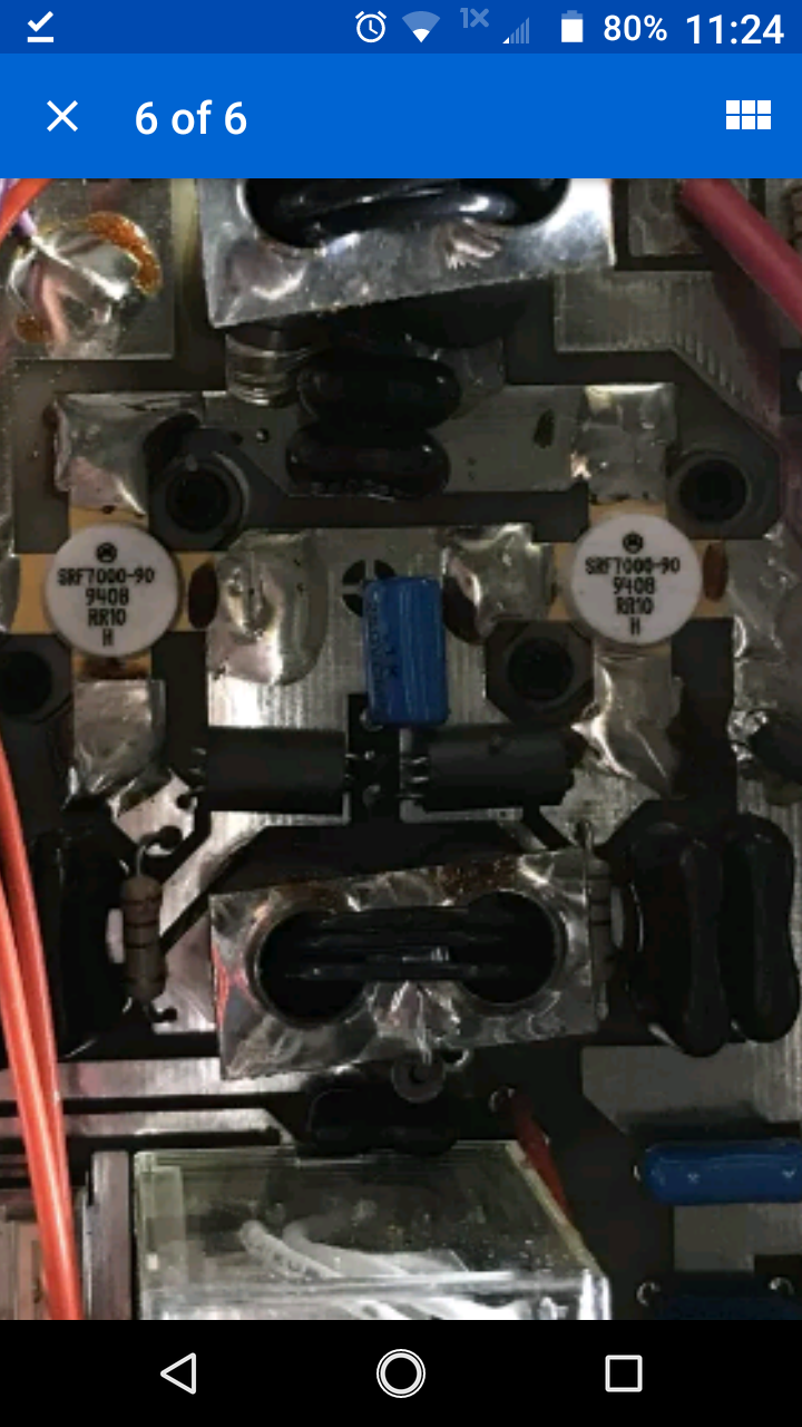

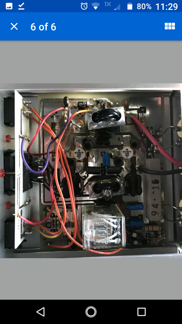

Found a Shooting Star 225 Plus online for a decent price (I think) of $170.
But it has SRF-7000 in it (MRF-455 equivalents).. which are like 60w max each.
Looks clean otherwise.
Opinions please..
It's going to be something like this.. or an RM Italy 503/7505.. I don't want to spend over like $200 for an amp.. this would be for a base radio setup with 2w dkey on AM..

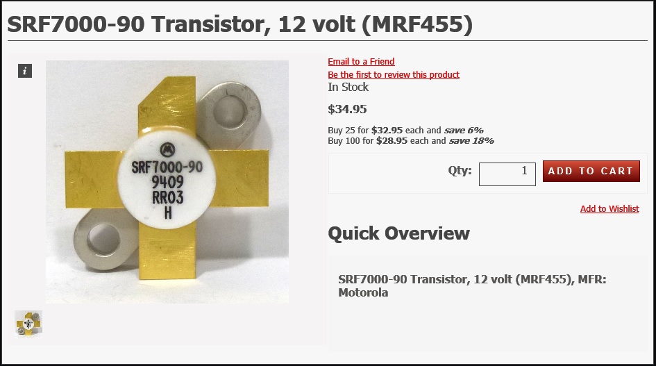

Oh, ok, misunderstood the post. Yes, the SRF7000 is a replacement for the old MRF455. The SRF designation means that Motorola made this particular transistor for a certain company to be installed in their products, they are made in an (X) amount of batches, if I understand it correctly. It may also be an RoHS compliant version of the MRF455.
BJ Radionut is also correct, the amp is also a Class C amp, so it would be a splatterbox, too. I would stay away from anything that is Class C, unless you know how to properly add bias to the amp.

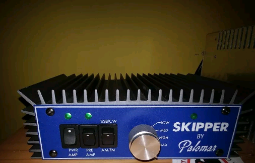

The Palomar Skipper is a good one, if it's the one I recall correctly.... it has AB biasing with thermal tracking, and they sound very nice over the air. Good SSB delay, too.
If you can snag one of those it would be worth it.
