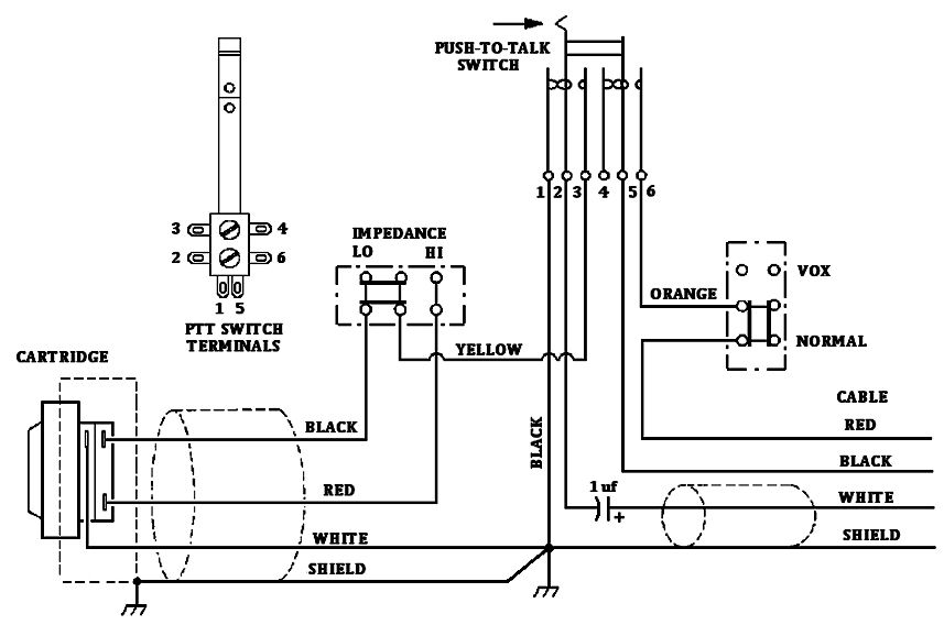

Shure 444D desk mic polarized cap value
Dr_DX
Well-Known Member
Jan 29, 2006
361
444
Anyone know what it is? Mine is missing and I don't see a value mentioned anywhere.
For future reference in case some one else wants to know. I reached out to Shure to see what they said. They didn't even have the owner's manual so I sent them a copy and this was their reply:
Case #: 01060282
Thanks for providing that. That is a 1uF coupling capacitor.
Please let us know if you have any further questions.
Blake Lanciloti
Customer Service Representative Sr
Shure Incorporated
So the polarized capacitor that is on the 444D schematic in series with the audio line has a value of 1uF (according to Shure).
