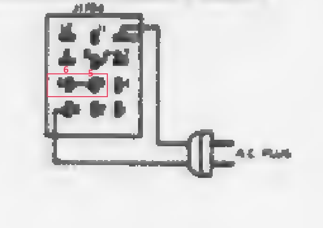

is there a acc. jack in the back that needs a jumper like yaesu?
ok its a jones plug. are you feeding it 120V?
looks like pin 6 and 5 need to be jumped to get the heaters to turn on
