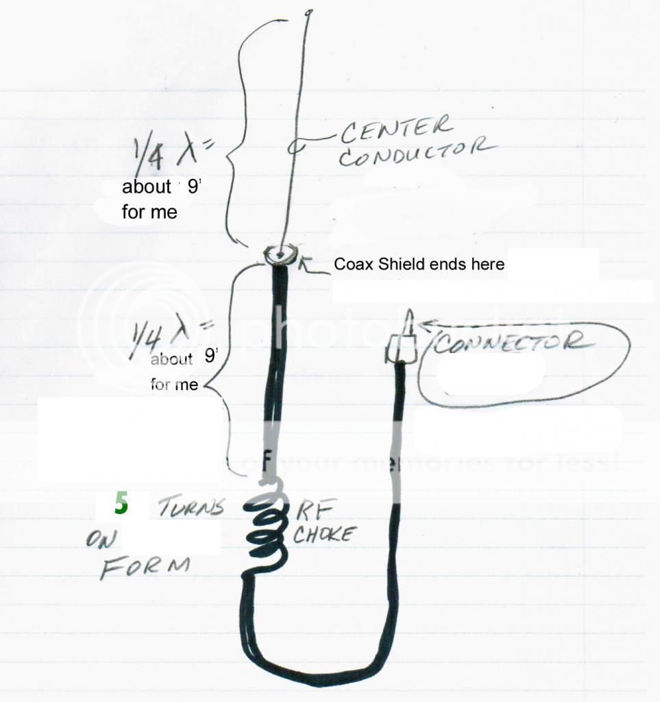

2. Coaxial dipole.
Peel the coax cover and braid back from the end of a coax 9' and cut it away. measure down from the peeled part of the coax where cover and braid now begins another 9'. At this point wrap 5 wraps of your coax around a 4" PVC coupler and secure the wraps with either tape or cable ties to keep it there. This one is also tuned by adjusting the length of the upper end.
These two require little to nothing more than a long piece of coax to make. The first is easiest hung horizontally from its two ends, and the second vertically.

Fixed it, LY. It will be on a 4" PVC form, or similar non-conducting form.
I was thinking about 8 turns on a 8" dia. Free space electrical taped circular loop according to another Ham/Guru. Any truth to that?

Using a 4" coil isn't a coax problem if it is RG-58 coax.
So, five turns on a 4" former for the 11m/CB band should fix ya right up.

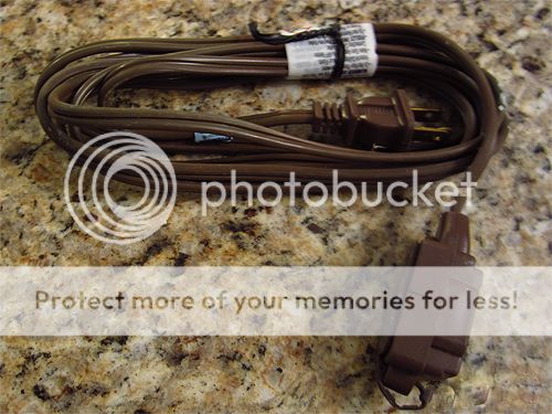

You can also waste less coax by using a couple pieces of zip cord from an old extension cord to make the dipole.

I agree, Doc. I have used nearly all of those. And, Robb, when I use a thicker coax than RG58, I choose a 6" diameter coil.
As for the zip/extension cord, I have a portable made of that I often carry on vacation with me.
Cutting off the female block of a 9' household extension cord and spreading the two conductors results in an instant dipole. Connect the feedline to the two male prongs of the cord, and tune by turning back each end of the wires equally.
Put a female cord receptacle on the end of the feedline and plug your dipole in it for easy portability. If it were warm and no snow and ice on the ground I'd demonstrate these outside.
