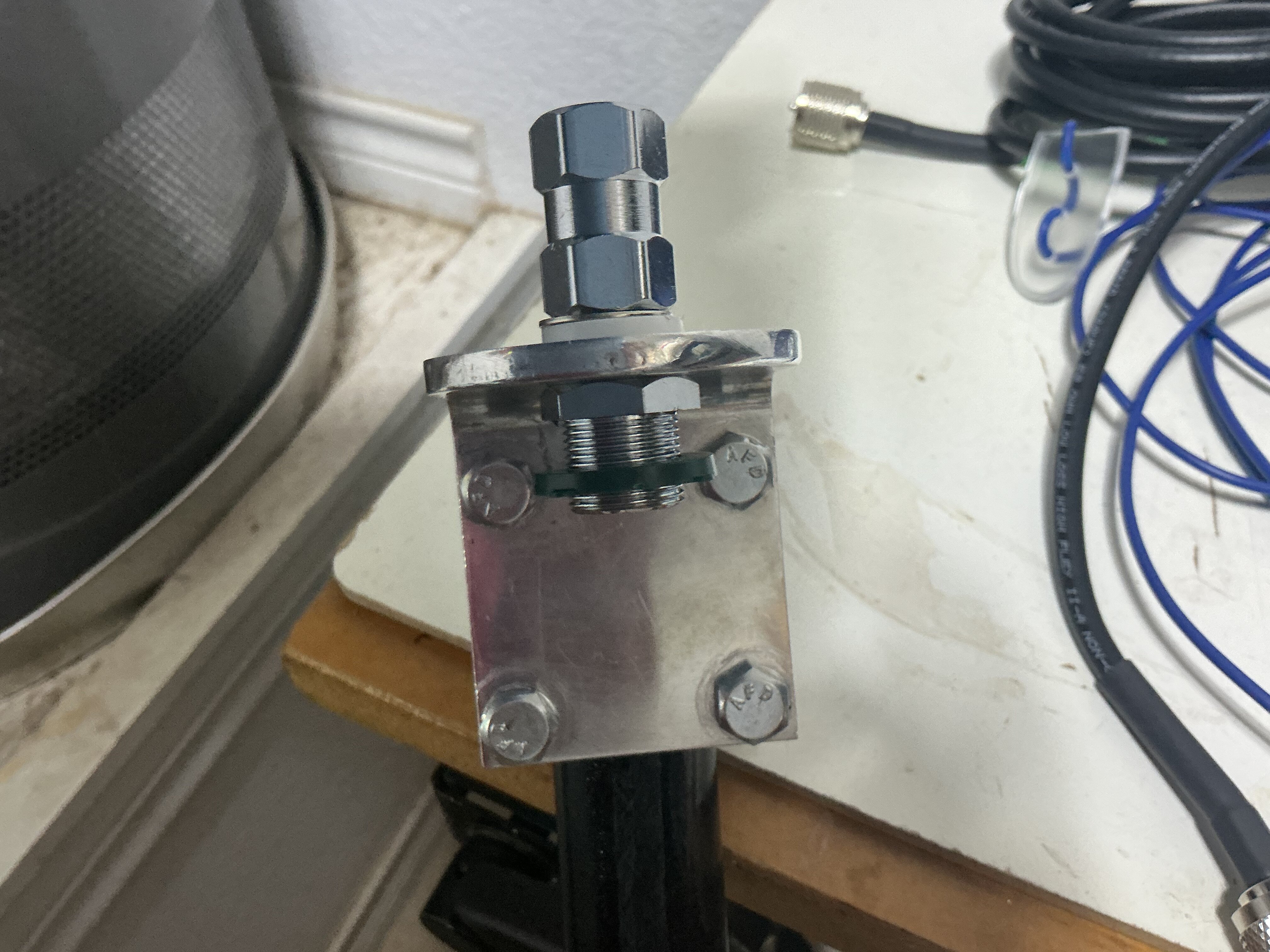

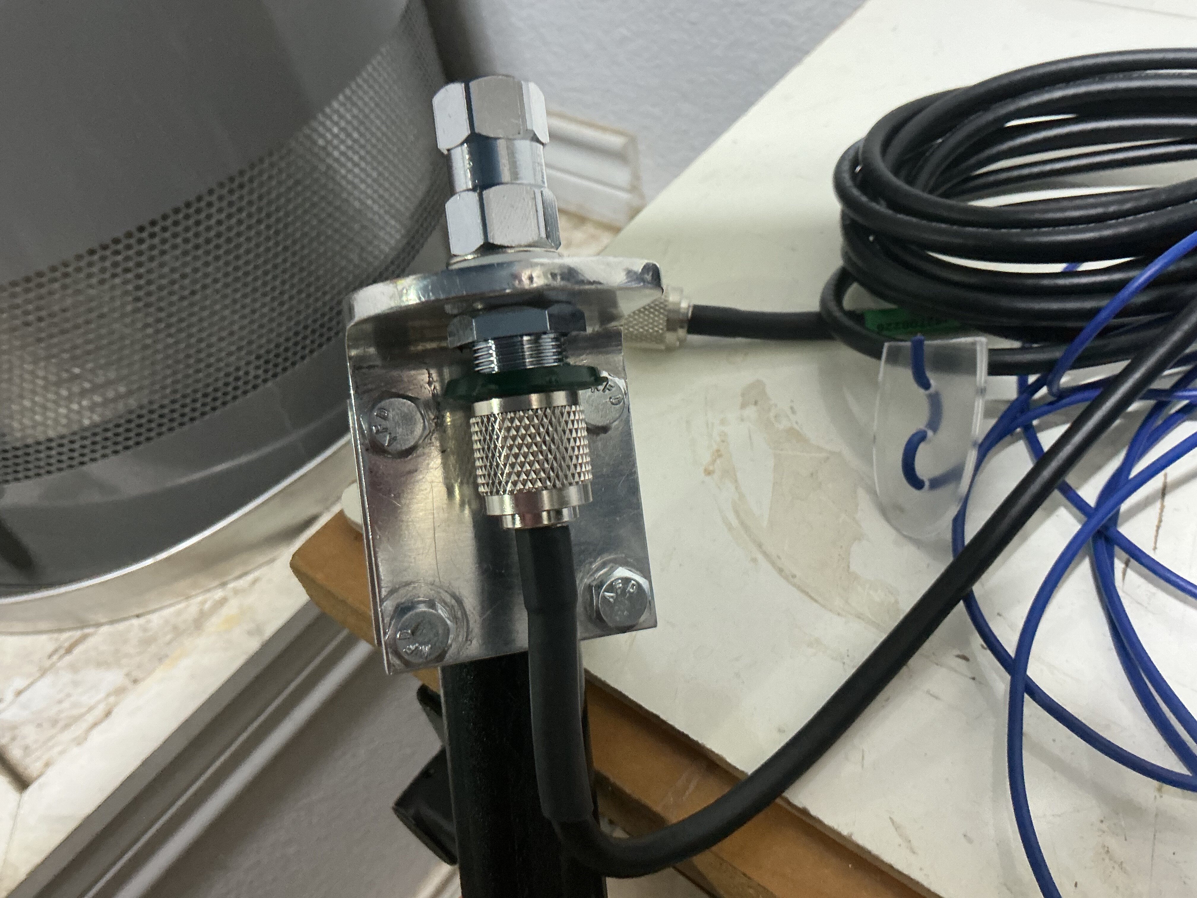

Take an ordinary water hose washer and slide it onto your SO239. You’ll find it is a perfect snug fit.
Then simply screw on your PL259. Bingo! No more sticky coax seal, etc.

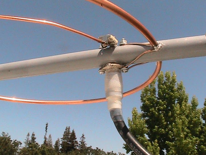

I use rescue tape. It is self vulcanizing and easy to remove with no residue. However it would be difficult to use with an L-bracket but it works great if the connector is more exposed like in this pic.

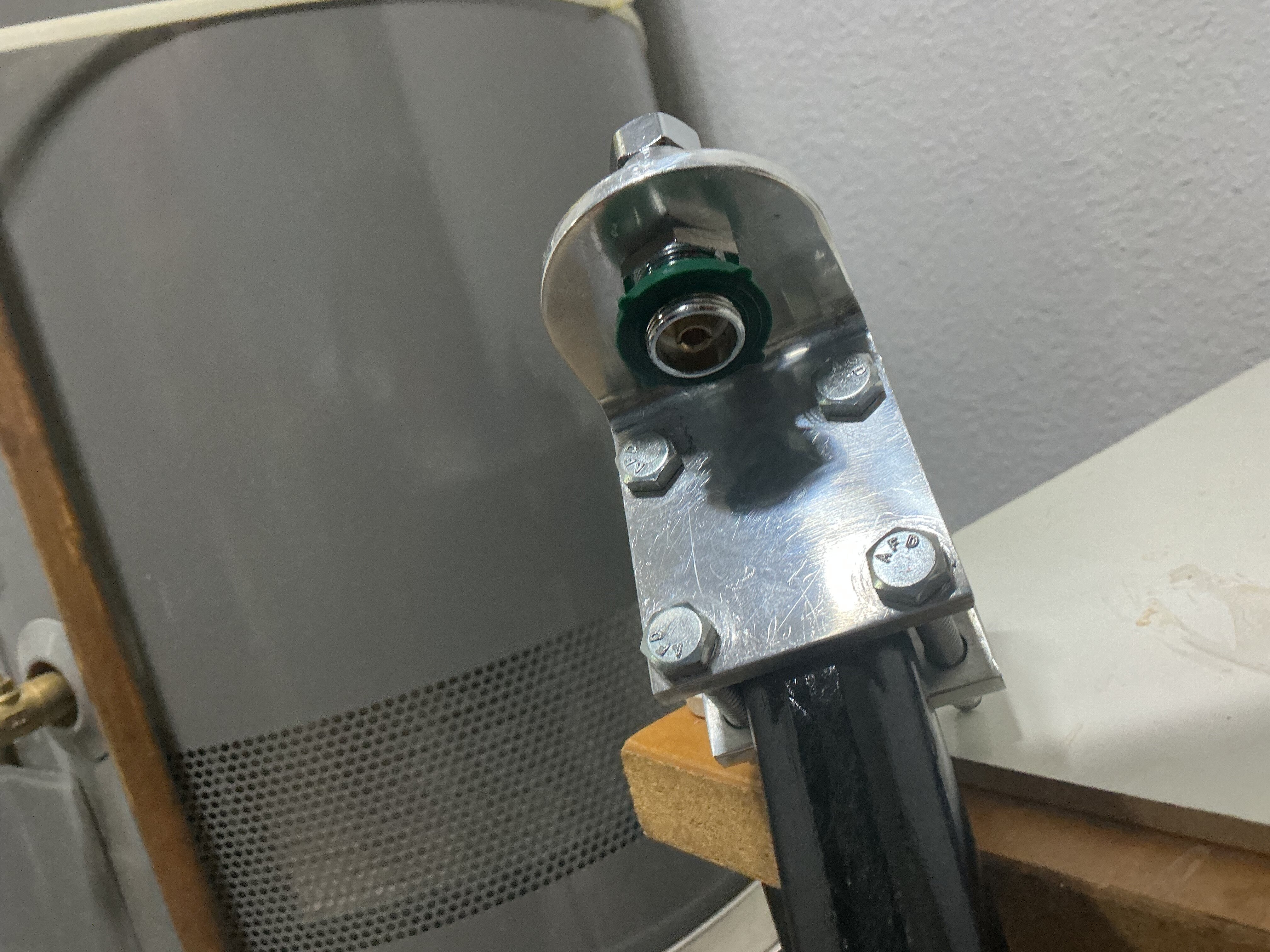

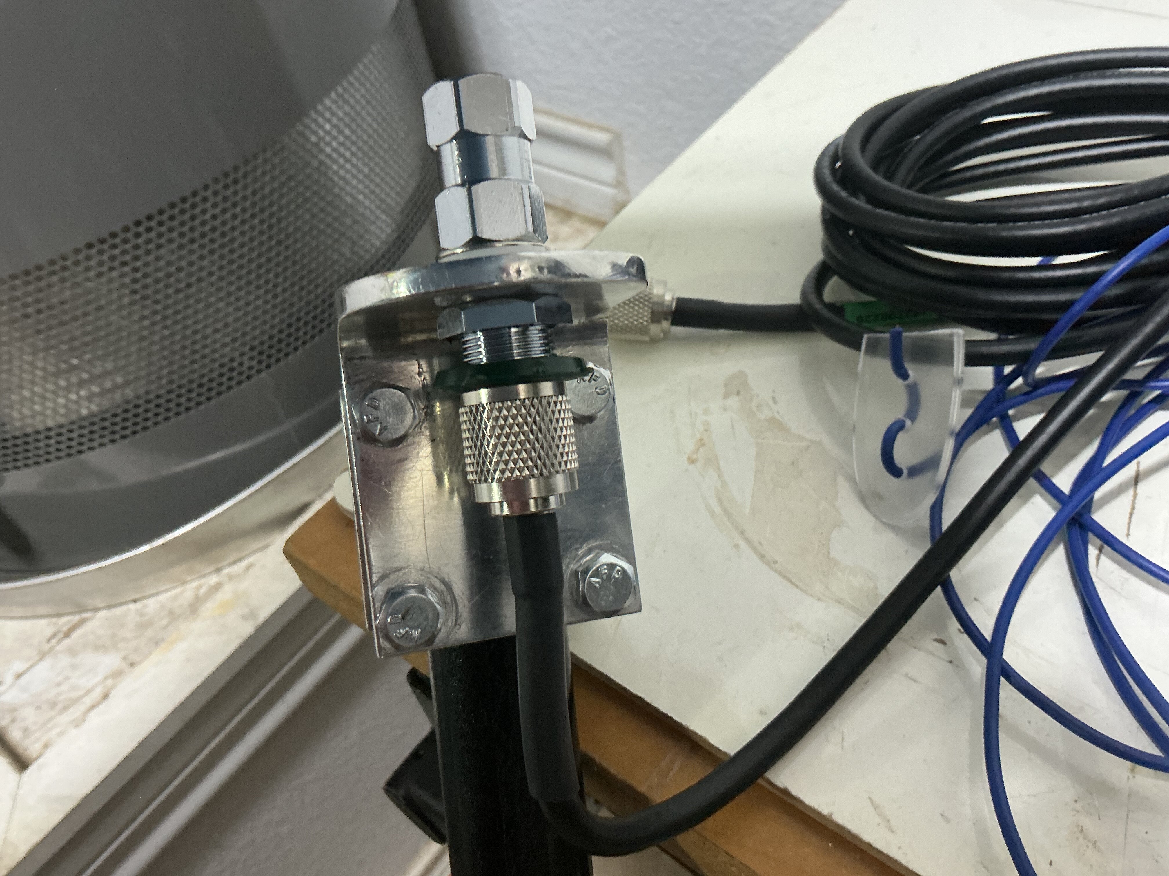

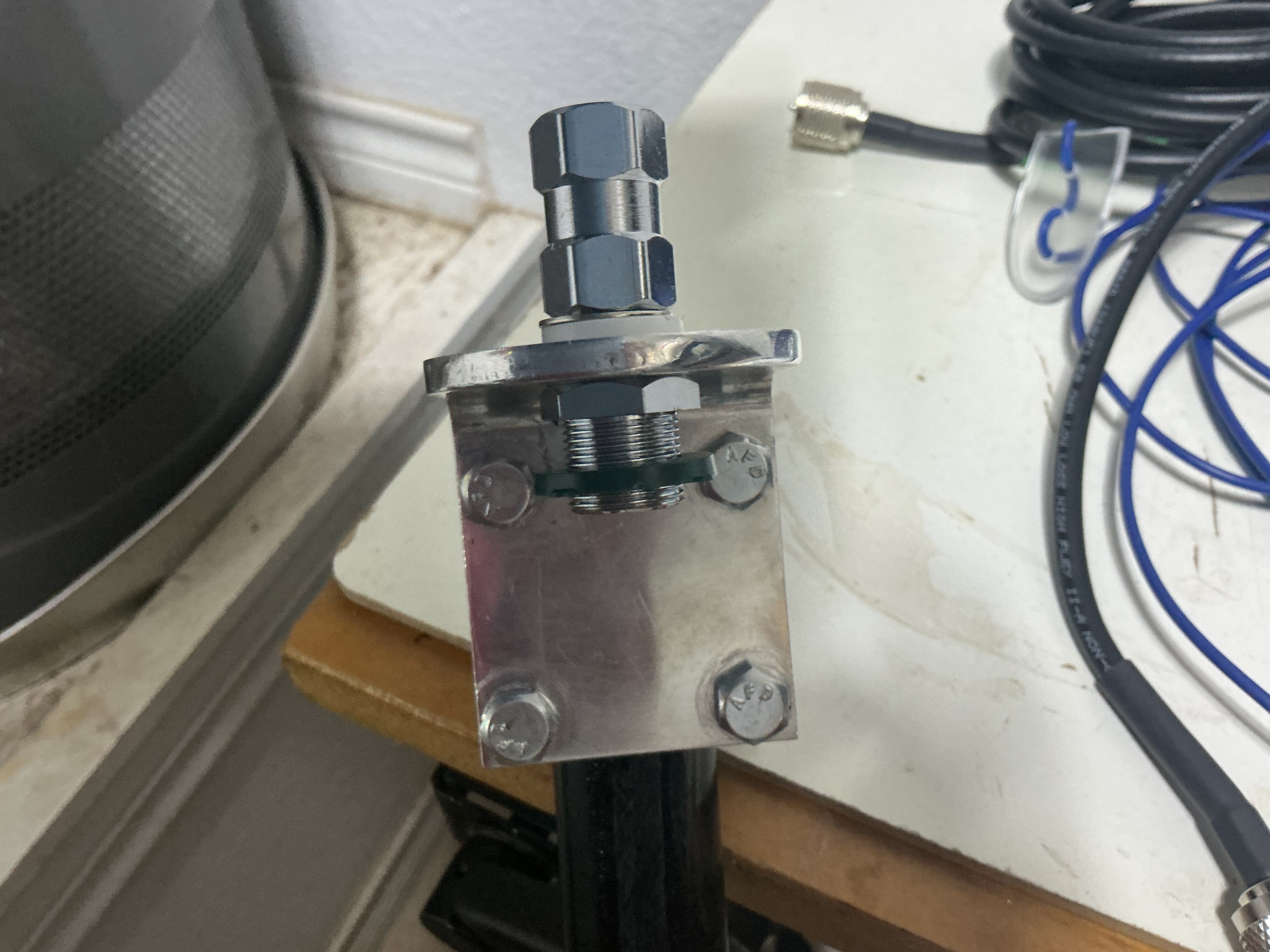

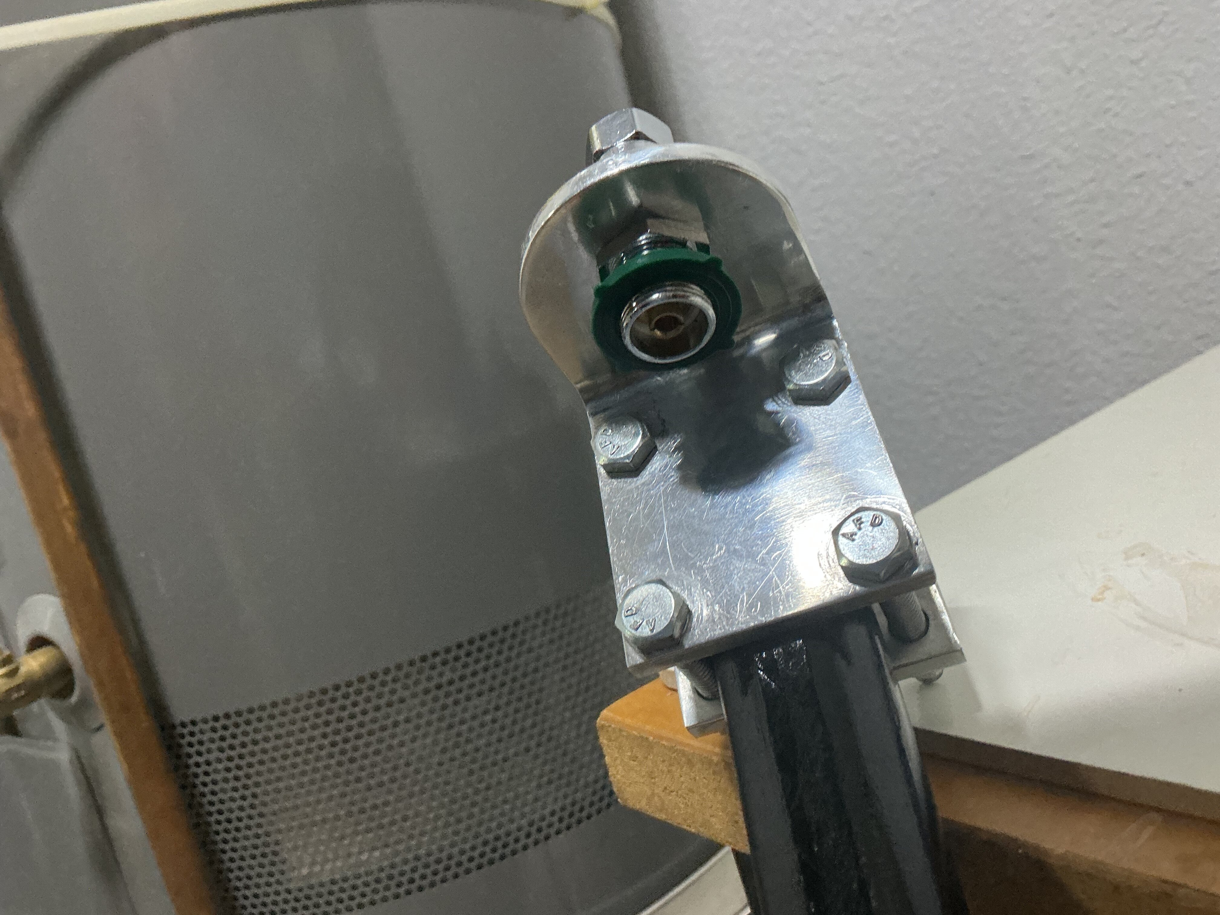

View attachment 76783View attachment 76782View attachment 76781
Looking at you pic again, it seems the rubber hose washer would act like a rain shield and let water drip away from the connection point which should work fine for that.
To add to your idea, I think putting a couple more washers on the threads so the connector will bottom out all the washers and create a tighter seal at the edge of the connector.
Just be sure not to use too many washers where tightening the connector will deform the rubber washers.
Multiple washers is an idea I tried. Quite frankly, a single one placed low on the connector works good as the washer is pushed upward as you screw on the PL259. Mine did not deform at all.
It definitely acts as a rain shield.
I tested it via a good dowsing with my back yard water hose, inspected it and found the inside of the connector to be bone dry. Still, for long term use, the tape you guys are using is likely better. I just never leave any one antenna up for more than a month or two at one time. :giggle:
