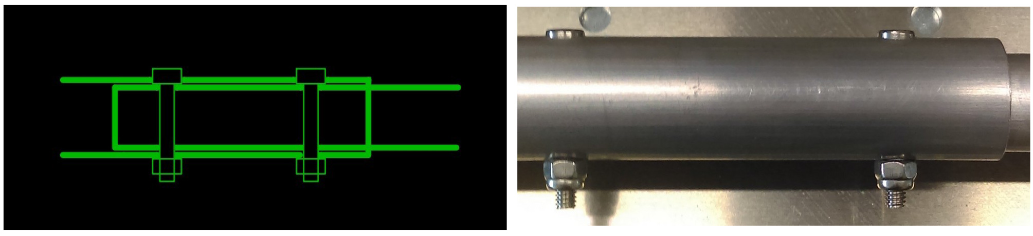

Yes, but there could be a problem compressing against the hollow pipes / radials. If there was a solid piece of aluminum inside the smaller diameter radial, the fasteners would have something to tighten against.

I did that in a few antennas with 1mm walls. No issues. Antennas over 10 years on tower. Still in one piece.
That's great! My concern would be if the fasteners were too tight, the radials would collapse and be oval shaped which would leave a path for water and moisture to enter the joint.

Sorry, I was thinking rivets.
Using rivets would definitely compress the hollow radials and you would have a mess. Using hose clamps is effective because they apply pressure on the entire circumference of the male to female connection, whereas using screws or thru-bolts only apply pressure under the head of the screw and/or under the head of the bolt and under the nut. The majority of the female ends on two-piece radials have two or more splits and provide a friction-fit between the male and female surfaces which will "almost" produce a watertight seal. Hose clamps with a layer of tape, sealant, Liquid Tape, etc. etc., covering the clamps, splits and the minute gap at the joint, will last for a long time.
