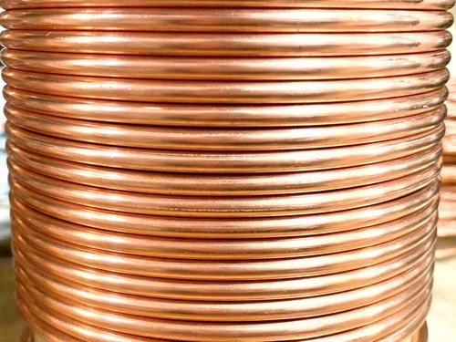

If you are not running big power, you can try soldering a piece of copper, if not, you can buy solid bare copper and make a new coil. In order to do that, you must determine the gauge of the broken one.
Here is a link to buy it. Some sell it by the foot, other by the roll.
