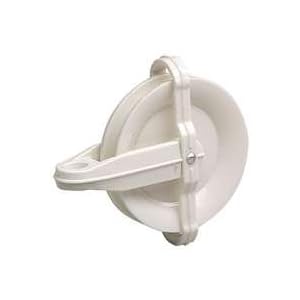

If you have two high enough mounting points for suspending it from, you could use the city tenement style clothesline pulleys and rope and make it of wire, suspend it from the endless clothesline, and rotate the line out from the tie-off structure to where you got clearance as needed. Hang something non-conductive from the bottom (run it through PVC pipe at top and bottom) of it to keep the wire from curling up antenna vertical.
Similar to this:
