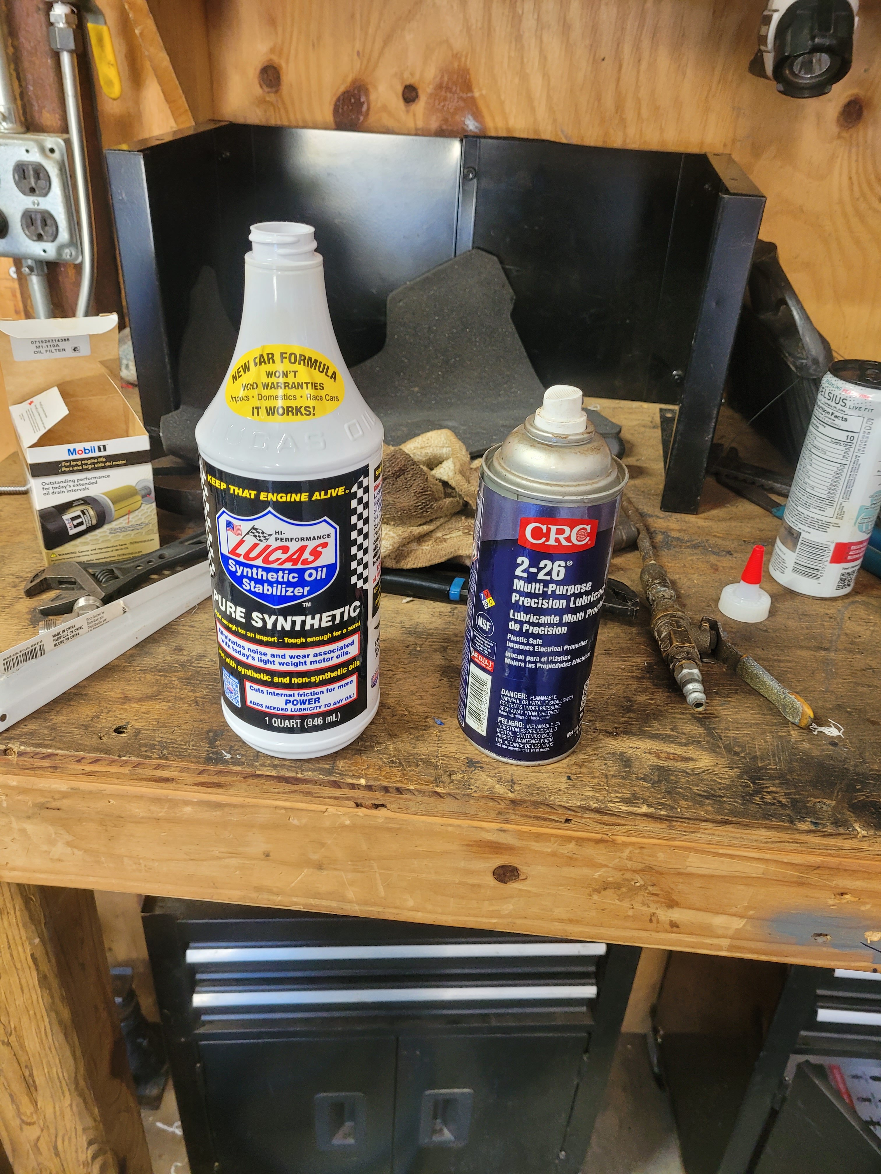

I know everyone has an opinion on this but I was just wondering if anyone thinks Lucas oil stabilizer is snake oil or actually worth using. I so far think it
it's
worth using. So far I've put just over a 100k on my little Frontier since I've owned it, it had 110k on the truck when I bought it and I've used Lucas along with my oil every time I done an oil change. I can't honestly say it works but I can honestly say I don't think it hurts, so far I can't complain so I intend to keep using it. Just wanted some other opinions on this stuff. And on another note, ive been driving this truck several yrs in the Ohio, WV, PA area and have tried several lubricants on the undercarriage to help combat rust, the North East use some pretty harsh concoctions to help with snow and ice. So far I ve managed to keep the rust in check pretty well ,I do have some but I would consider it lightly rusted compared to some I've seen. This time I coated the undercarriage with 2-26 multi purpose lubricant, I read on the can it contains mineral oil so I thought why not. Just wondering what some of our Northern members think of this and have you ever used it?
I have seen many engines go 300,000+ with just regular oil changes and cheap oil that I don't think additives are ever needed with the exception of older cars that have flat tappet cams, then a zinc additive MAY help cam life.
The undercoating spray is a good idea in the rust belt, I use fluid film or wool wax on alll underbody seams before the first salt every year,, my 2001 explorer is still rust free.
