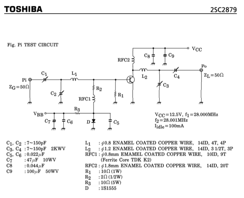

The popular 2sc2290 and 2sc2879 are Toshiba's.
They were the gold standard for being rugged.

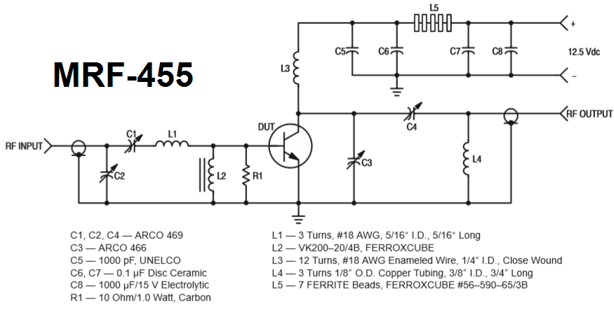

The 455 and 2290 are considered Benchmarks.
Their successors leave more Scorch-marks on the Benches than in real life - and even in Real life - the Efforts of Toshiba and Motorola paved the way for the copycatting that is so evident.

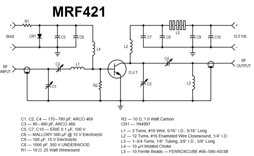

MRF455 - known to be Class C - STRICTLY Class C...
So what would be a Good Substitution?

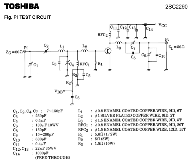

Ok, so you have the 2SC2290.
What would work - the 2SC2879?
Let's see...
Umm...Er - No!
At least - not as a Drop IN Replacement for Class C device...
It's BIASING is the carborundrum...​
The 2290 is actually Better for the Drop in on a Class C amp than that which the 421 to 455 could, simply due to HOW THE AMP MANUFACTURER set up their platform - NOT THE FAULT OF THE DEVICE MANUFACTURER...(Note R1 value)

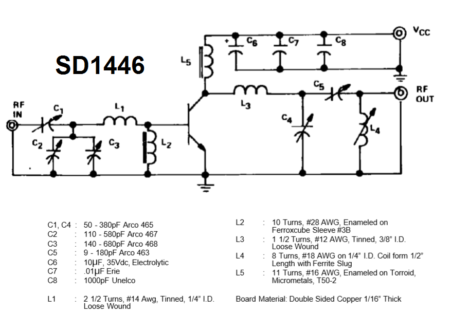

The SD1446 is more Class C that can act more of the DROP In for 455 conversion than
the 2290 or 2879 - needing that they require Class AB biasing - or do they...???

The reason that everyone praised the Toshiba 2879 was it was very rugged under abuse.
Insane drive levels and even more insane voltage and they lived for more than one key in a comp amp.
Suddenly everyone wanted what the comp guys are running and anything else was not up to snuff.

The 455 has no issues running class AB. Look at the thousands and thousands of amplifiers Messenger, Texas Star and Palomar put out. They all had a 455 based amp or amps at one point.
The 455 sold so good 40 years ago that the rep selling to Messenger when it was in San Diego has the license plate MR 455. I know he sold us more than ten thousand mrf455d. And Messenger didn't build class C stuff until BDW bought it.
