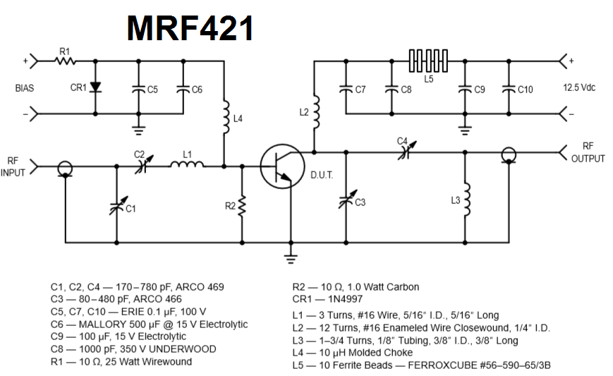

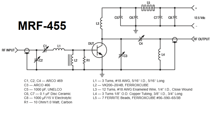

MRF455 - known to be Class C - STRICTLY Class C...
So what would be a Good Substitution?
Another:

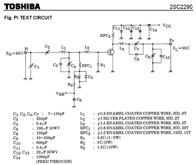

Ok, so you have the 2SC2290.

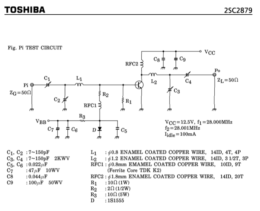

What would work - the 2SC2879?
Let's see...
Umm...Er - No!
At least - not as a Drop IN Replacement for Class C device...
It's BIASING is the carborundrum...​
The 2290 is actually Better for the Drop in on a Class C amp than that which the 421 to 455 could, simply due to HOW THE AMP MANUFACTURER set up their platform - NOT THE FAULT OF THE DEVICE MANUFACTURER...(Note R1 value)

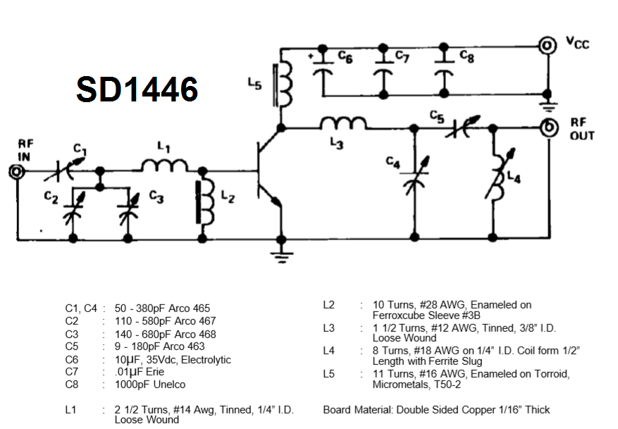

The SD1446 is more Class C that can act more of the DROP In for 455 conversion than
the 2290 or 2879 - needing that they require Class AB biasing - or do they...???
