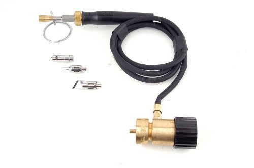

I also have a small Bernzomatic mini torch that is great. It came with several tips and runs off a standard 1 lb. propane or MAPP gas cylinder. It has a hose that is about three or four feet long and works great outdoors in the wind.
