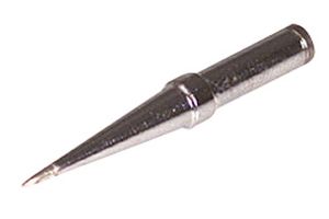

I use the PTS7 Weller tip; works fine for me.
700 deg/f.
