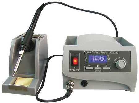

Captain Kilowatt, what is a good iron @45 or 60 watt for doing this type, and as far as solder what should I get 60/40 ect? Need to get some and be more prepared. A hone else wishes to chime in please do so. Your input is more than welcome.
I bought the digital soldering station from Radio Shack some years ago when it was on sale and have been very happy with it. You can adjust the tip temp to match the soldering job. They still sell it.
That soldering station RatsoW8 posted above is decent. Even a 45 watt iron is a bit heavy for this kind of work. Back in the day we used to have irons with interchangeable tips and used 15,25,30,and 45 watt tips. Usually the 15 watt tip was sufficient. Today the use of soldering stations is the preferred method since you can control the temperature of a single tip to match the job. As for solder, yes use good old rosin core 60/40 and stay away from the lead free crap. It does not wet the connections as well, is generally harder to work with although not real bad, and is subject to the formation of tin whiskers. I hate using it and have several pounds of 60/40 at home but I have to use the lead free crap at work. Thankfully I have to do very little soldering at work.
