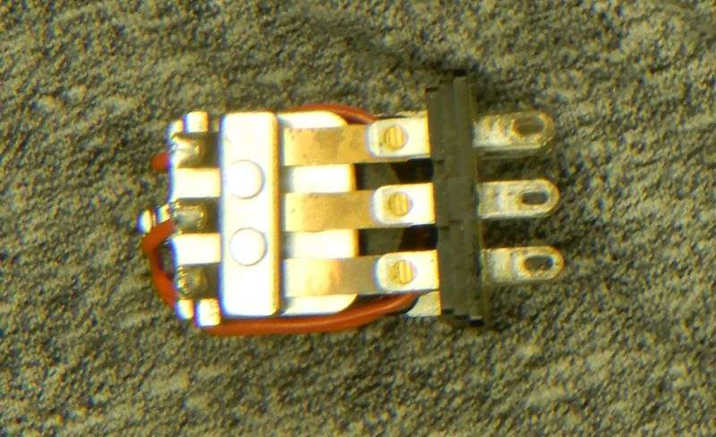

One of these contact levers is not like the others...
The Uniden-built 40-channel SSB CB radios from 1978 used the uPD858 PLL chip, and had one of these relays in them. Made by Omron, type MX3P. Discontinued decades ago, they last a long time if treated with respect. They pop up from time to time on fleabay.
But if cleaning the contacts with a strip of typing paper and solvent won't cure a noise, or fix a tendency to drop out you'll need a new relay. Just don't EVER use any kind of abrasive on the contact points. Just paper and solvent.
This relay was overheated, causing one contact lever to darken, compared to the color of the other two. You'll have to bite the bullet and track down a new one if you see this.
Probably.
Had a hard time getting the camera to show the color contrast between the two good levers and the one that overheated.

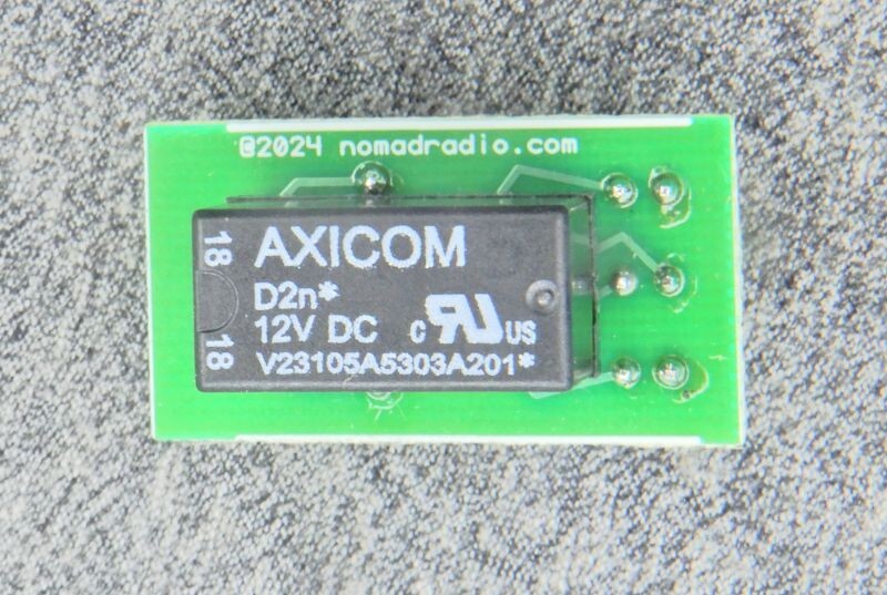

I'm sure you have pondered about building a relay substitute module for these radios. When are we going to see one?
