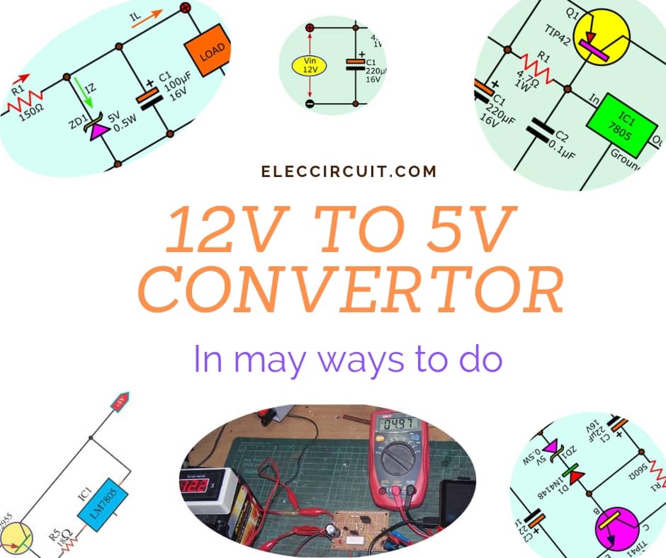

Which is why sp5it made the recommendation he did.
So, yes, it's normal for that particular USB doohickey. Most likely anything in the same price range will do the same thing. You can either live with it or research a better option. The link sp5it gave you is a good place to start for a linear regulator if you like to roll your own or just like to learn new things.
