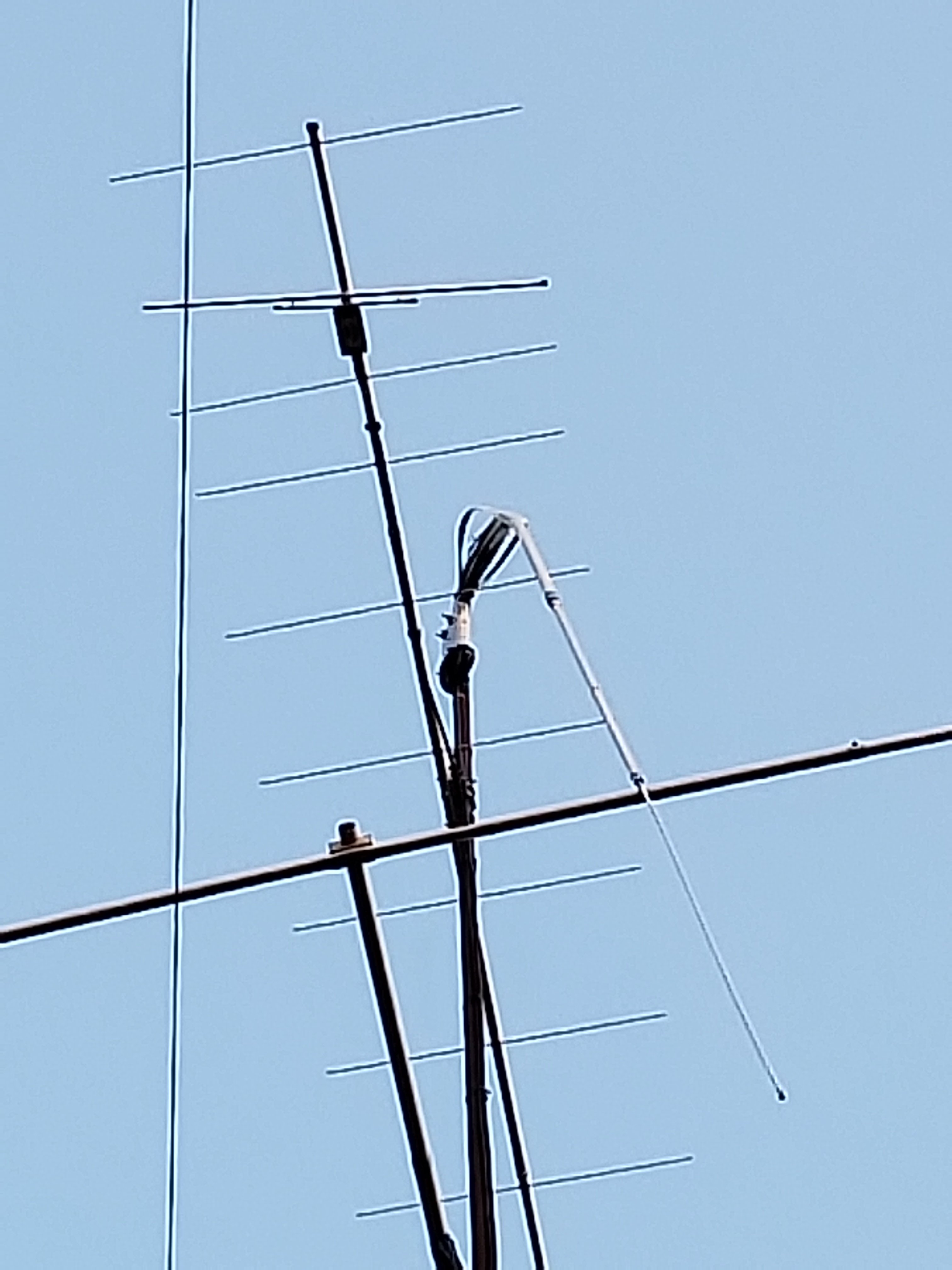

Update: 8/20/18 3:30am woke up to wife freaking out. Heard a very close lightning strike. All equipment was unhooked but I got up anyway to check things out.. half asleep everything seemed ok in the house & no bad smells that I could notice. The next morning I went outside and looked up.. bummer...

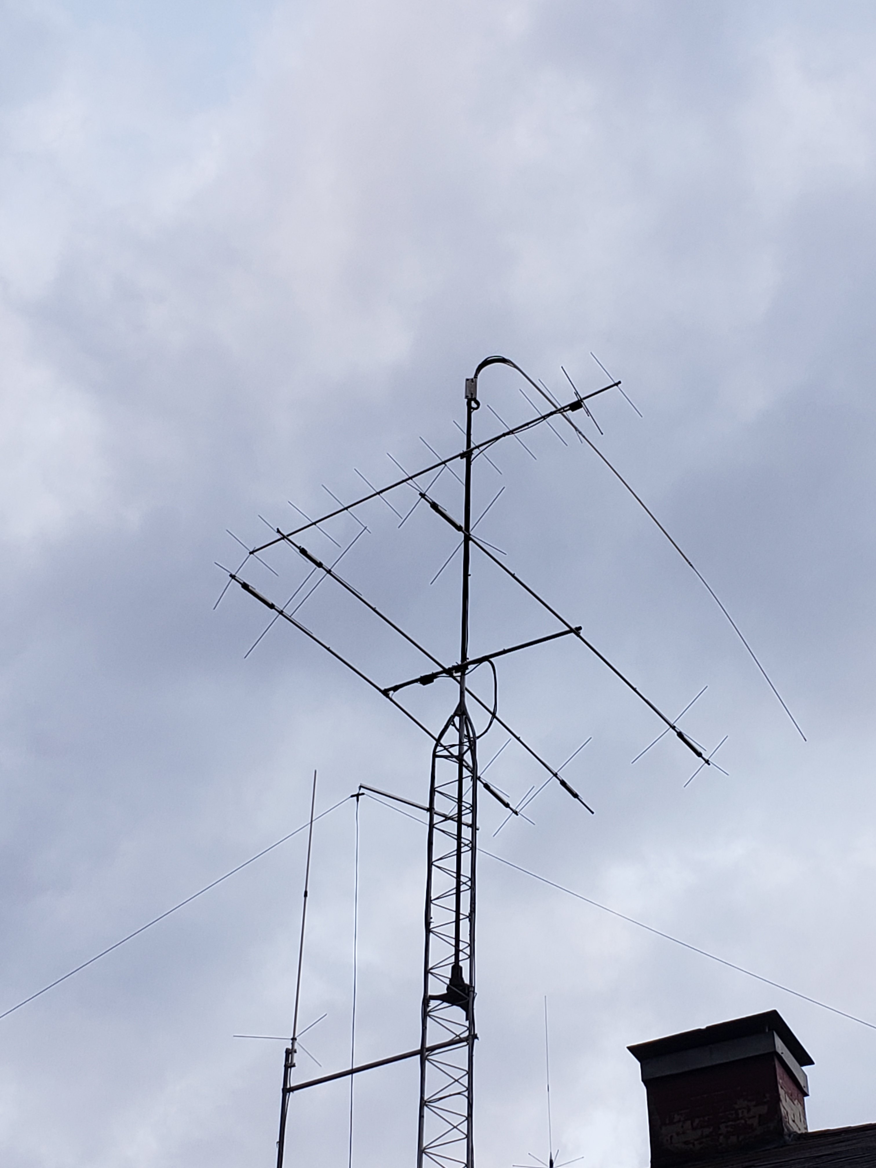

so the Imax blackened and split like a banana. It came to rest on the 13b2 and tweaked a couple elements but nothing that cant be fixed. NO damage to any radios. Only lost 1 power supply, son's tv, roku, and obviously the imax and 120ft feed line. All other antennas and rotor checked out ok...so far... as far as I can tell the tower grounds worked for the most part.. could've been a lot worse.. Just as I'm ready to expand and try some new antennas before winter sets in.. 1 step forward and 2 steps back (n)

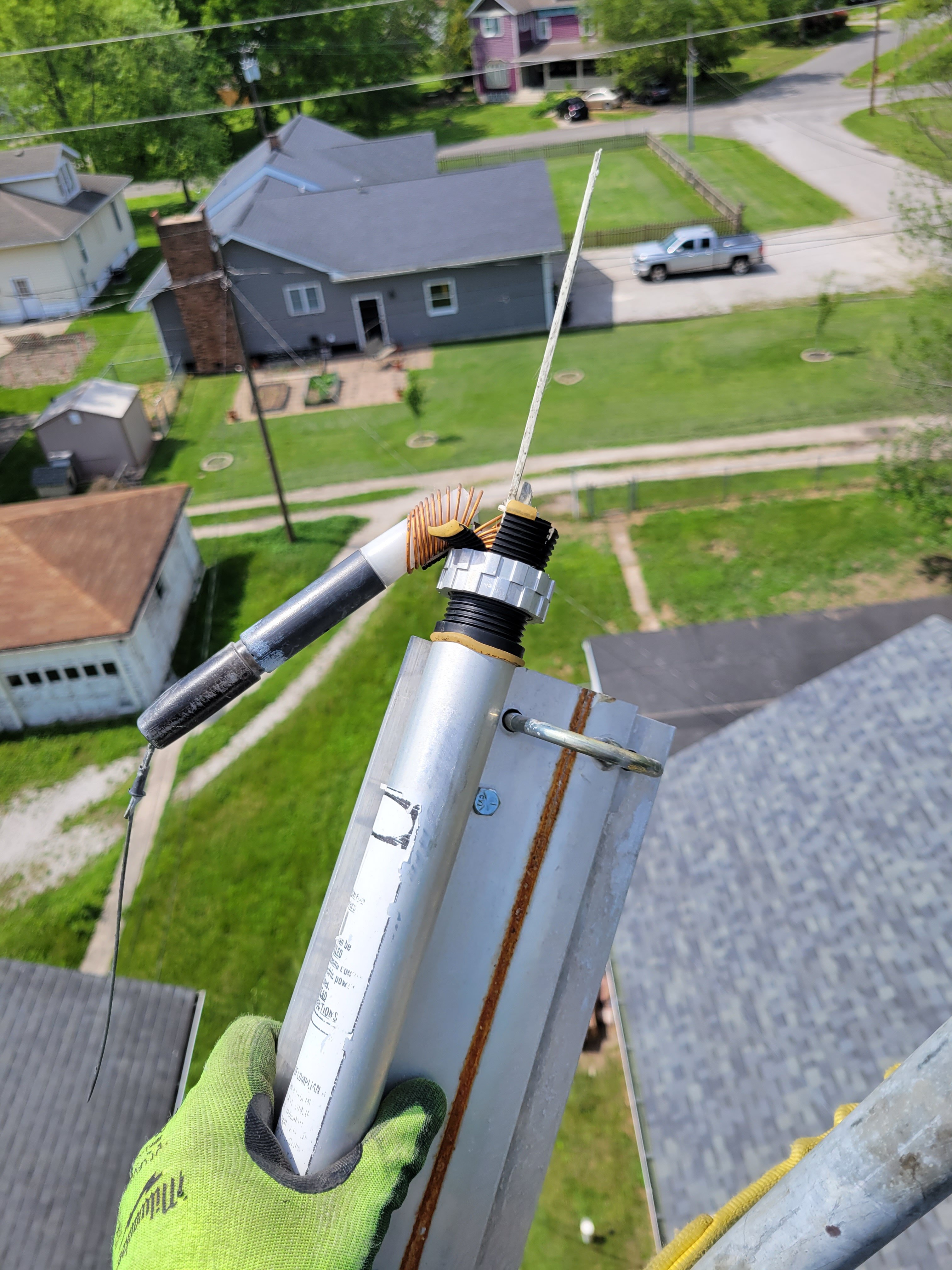

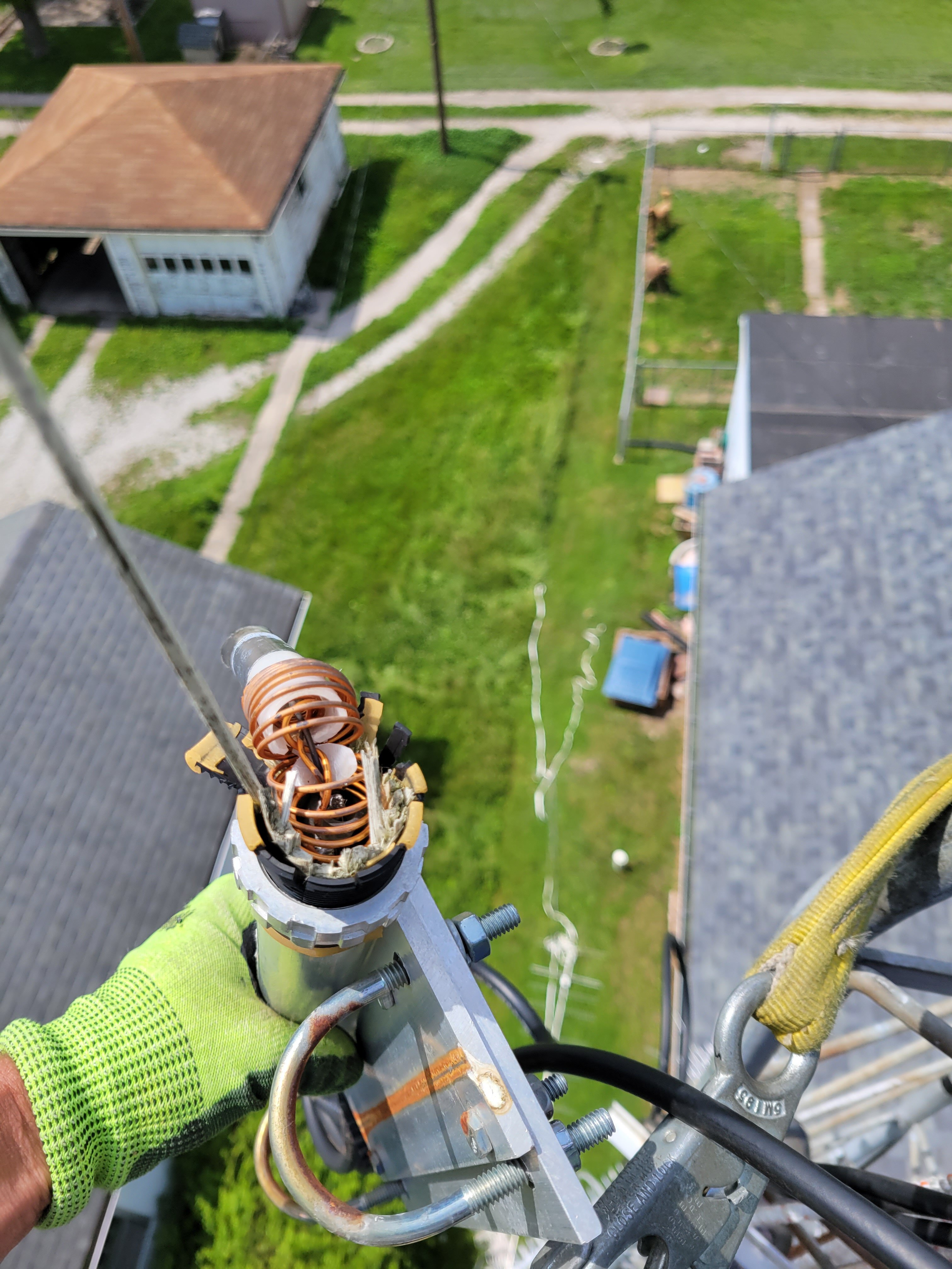

That's just Brutal - nice work on the removal - re-install.
Seeing the above pic with the SIZE of the Coil in the IMAX - then the mess with the pandemic - your absence got us worried and to see this - WOOF.
Glad the problem is taken care of.
Well the Imax got hit and split like a banana and folded over. It was laying in my 2 meter beam. I went up with a telescopic tree pruner and cut down the majority of it. But inorder to get to the base of it I had to lower the mast and deal with a couple of beams. I just left it til my interests changed. Got bored with HF for now.. figured I would grid chase. Love the summer tropo and the higher bands...
