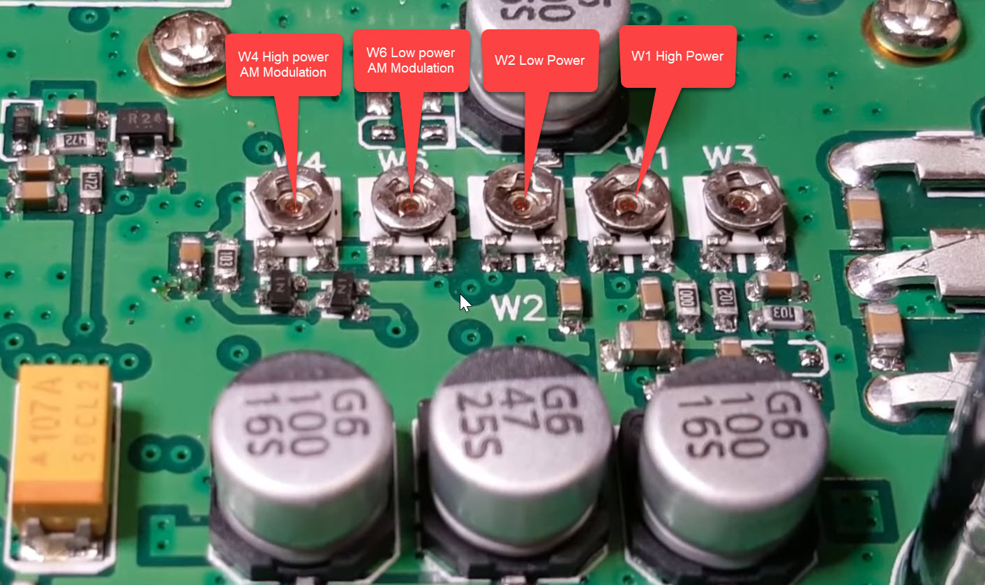

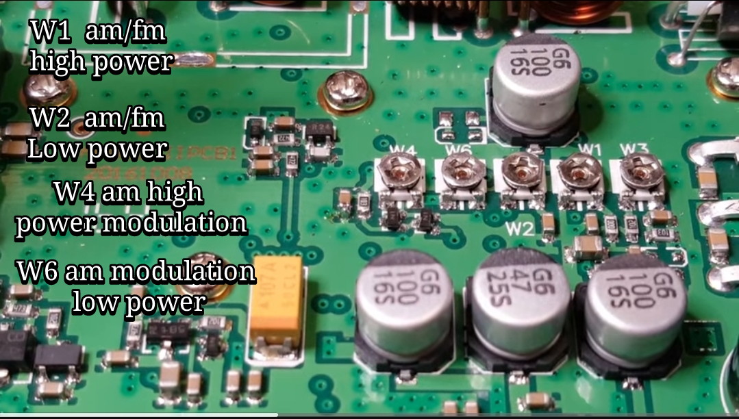

I just pickedup this radio .. Did the 11 meter mod and tingd the vr s for max out.. Would you have a Pic of the transistor in question ? Hate going in blind just looking for a reference ..
Thank You
Attachment is fot the vs I adjusted
Thank You
