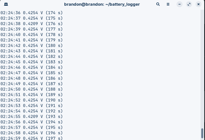

Terminal will look like this:

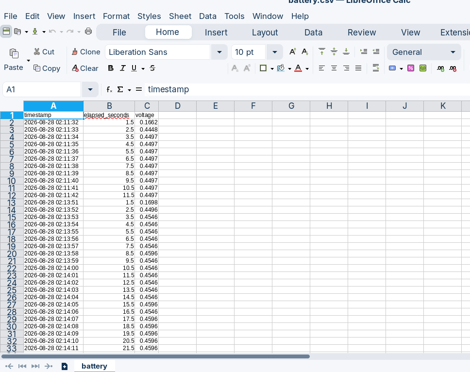

and the csv looks like this:
Note how in this test it was reading 0.4596v. I had the ADC pin floating when I did this. Don't expect it to show 0v unless it is actually connected to something that is at 0v. Also, you need to keep it within the nano's supply voltage so resistively divide and scale as appropriate. A zener to absorb spikes and a 1k resistor wouldn't be a bad idea either.

break
if not ready:
raise RuntimeError(
"Nano did not send READY."
# Send configuration
if not send_config(ser, config):
raise RuntimeError(
"Nano configuration failed."
print()
print("Waiting for START...")
print()
# MAIN SERIAL LOOP
while True:
line = (
ser.readline()
.decode("utf-8", errors="ignore")
.strip()
if not line:
continue
# START
if line == "START":
if log_file is None:
log_file, writer, start_time = \
start_logging(
new_file_each_start
continue
# STOP
if line == "STOP":
if log_file is not None:
print()
print("LOGGING STOPPED")
log_file.flush()
log_file.close()
log_file = None
writer = None
start_time = None
continue
# SOUND
if line == "SOUND":
play_sound()
continue
# VOLTAGE
try:
voltage = float(line)
except ValueError:
print(
"Unknown Nano message:",
line
continue
continue
elapsed = (
time.monotonic() - start_time
timestamp = datetime.now().strftime(
"%Y-%m-%d %H:%M:%S"
writer.writerow([
timestamp,
f"{elapsed:.1f}",
f"{voltage:.4f}"
log_file.flush()
print(
timestamp,
f"{voltage:.4f} V",
f"({elapsed:.0f} s)"
except KeyboardInterrupt:
print()
print("Data logger shutting down...")
except Exception as e:
print()
print("ERROR:")
print(e)
finally:
log_file.flush()
log_file.close()
if ser is not None:
ser.close()
print("Data logger stopped.")
