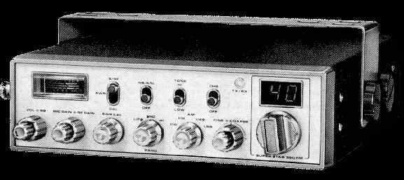

Picked up a Super star 360 FM unit today.
Looking at repairing it and using the rig for a test set on the bench.
Found quite a bit of info on the thing. First to go is that roger beep.
Next is to remove the RF power adjust and move that to the SWR knob to control power. Then add the 10kc jump.
Should make a decent bench set.
I did notice some noise in the TX audio. On all modes. Have to track that down.
Anyone seen other mods for this rig?
