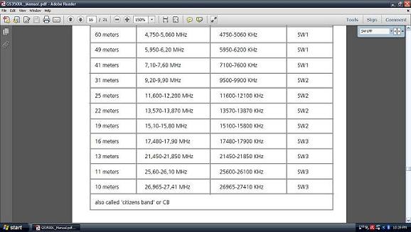

Is this even Accurate?
Since when or was 10m the CB band?... unless in SWL the bands are numbered different...

Look in the frequency columns.
Do the math: 300,000,000 divided by the frequency in Hertz (or 300 divided by the frequency in Megahertz) gives you the wavelength in meters. "Ten Meters", as in the amateur radio band, doesn't get really close to that wavelength until you're at the very high end at 29.7 MHz, where it's 10.1 meters.
Mathematically, "ten meters" would be 300/10, or 30 MHz. However, the regulations define the frequency spectrum specifically, and that's what we go by. The corresponding wavelength doesn't always correspond.

Also, these are numerical designations for the "Shortwave Broadcast Bands" International broadcasters etc.... they kind of have their own designator "language" that they speak not unlike CBer's have the things they say and hams have their own terms.... even when referring to essentially the same thing.
So you copied a SWB list....so you get SWB language and numerical usages.
