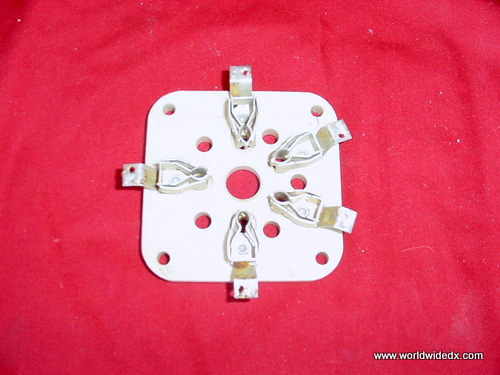

Found and bought an original Johnson tube socket on eBay to replace the right tube socket on the RF deck.
It wouldn't clean up; so I'm replacing it.
Cost was $20/shipped.
Also bought a new RCA female plug for the TX relay locally; cost was $.50.
