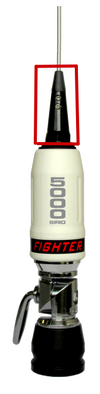

SWR started acting sketchy the last few days. I disassembled the antenna and found the area inside the item circled to be full of corrosion. Only that area. Not sure if moisture got it from the top where the whip enters and ran down or if it got in lower and condensed up in that area. It was a combination of rust and white chalky nastiness, a real mess. I cleaned it up best I could and the SWR is back where it should be. If your 5000 starts acting up, you might want to have a look inside. Great antenna performance wise but not sealed at all against moisture intrusion beyond the rubber cap at the base of the whip.

A little dielectric grease will solve that issue. Coat the end of the stinger with the grease, insert it back into the antenna mast, tighten the set screws and wipe the excess from around the mass tip... Nice and weather tight.
*edit to add*
Do the same on the threaded shaft that connects the mast to coil (where you found your issue).

Coating the whip end is a good idea! I used a little bead of silicone around all the seams and on the base. I also remove the antenna during downpours but I leave the base on which also has a silicone seal.

I didn't think to take any pics of the corrosion but it was a mess. SWR didn't get over 2.2:1 but I knew something was up because it was never above 1.4:1 on either end before. It has been through some torrential downpours for sure. Yep a dab of dielectric grease and a little silicone will go a long way. Now if mother nature would throw us a bone...
