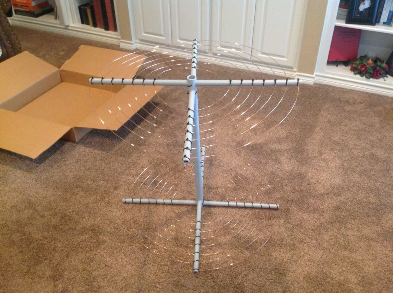

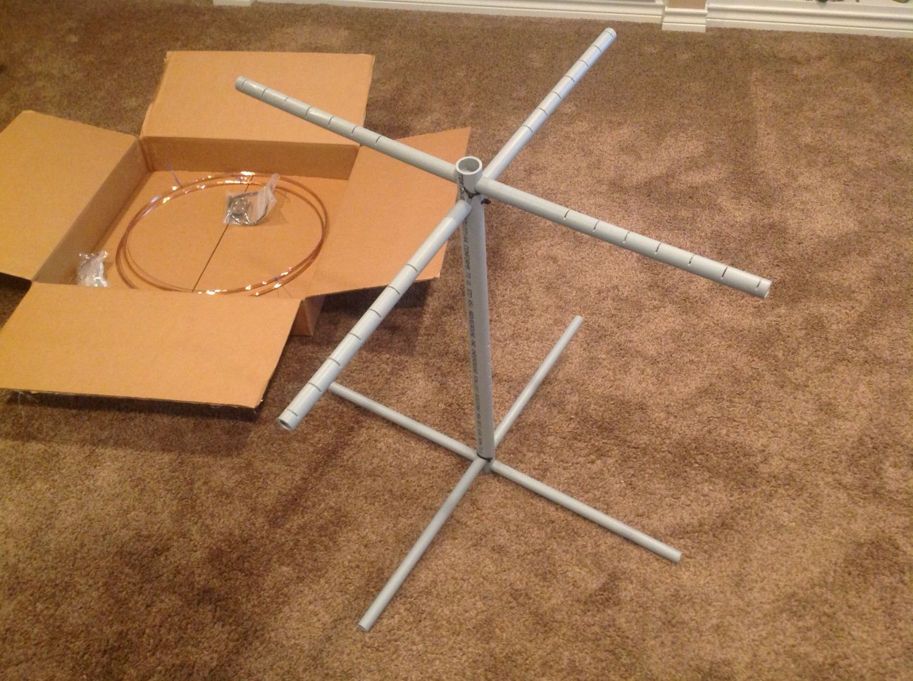

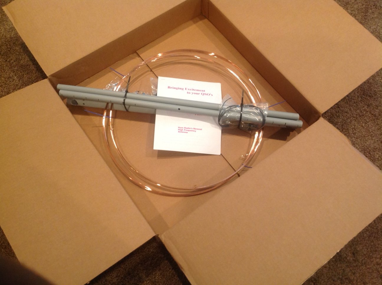

Comes neatly packaged:

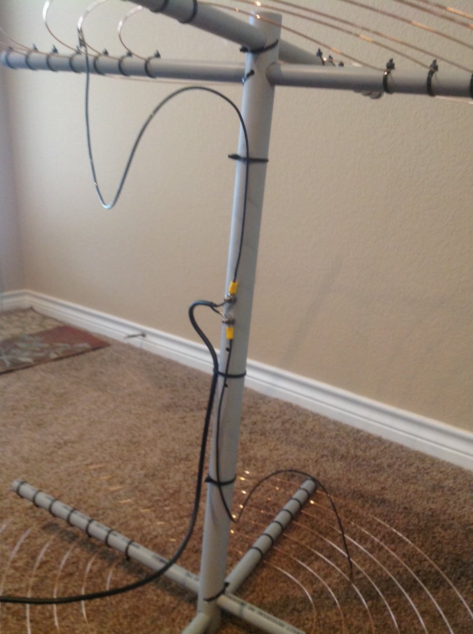

Booms attached:
Copper wire in place:
Resonating wire and coax attached:

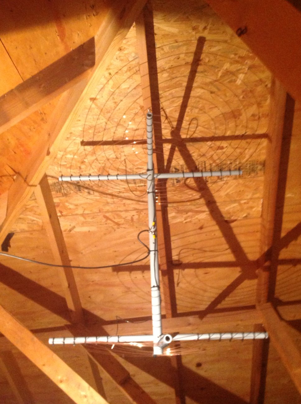

Hung in attic:

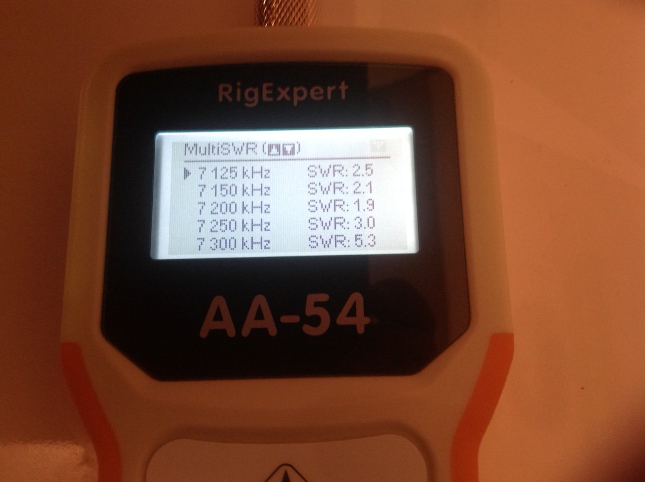

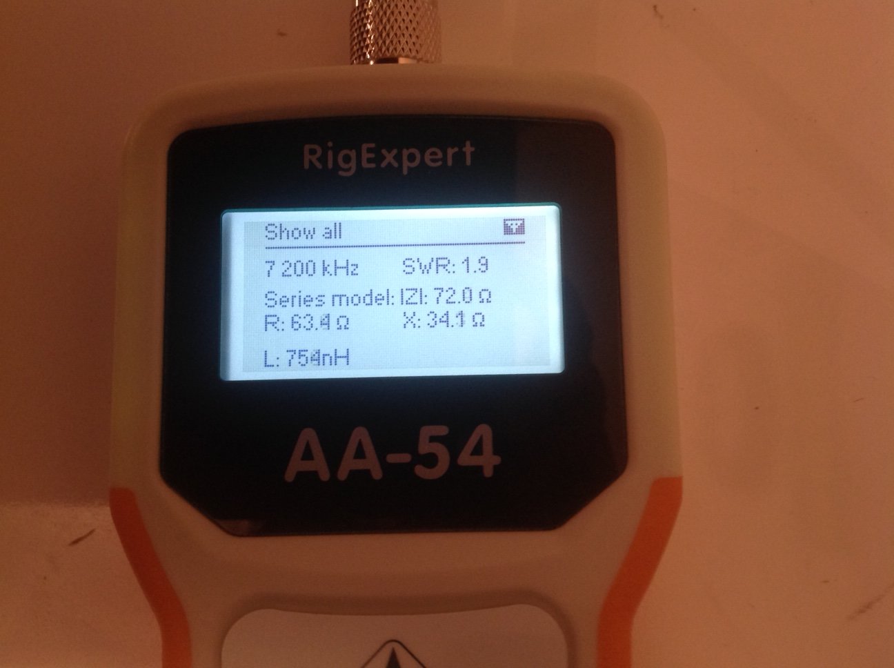

Lowest results I was able to achieve:
Efficiency in middle of phone band:

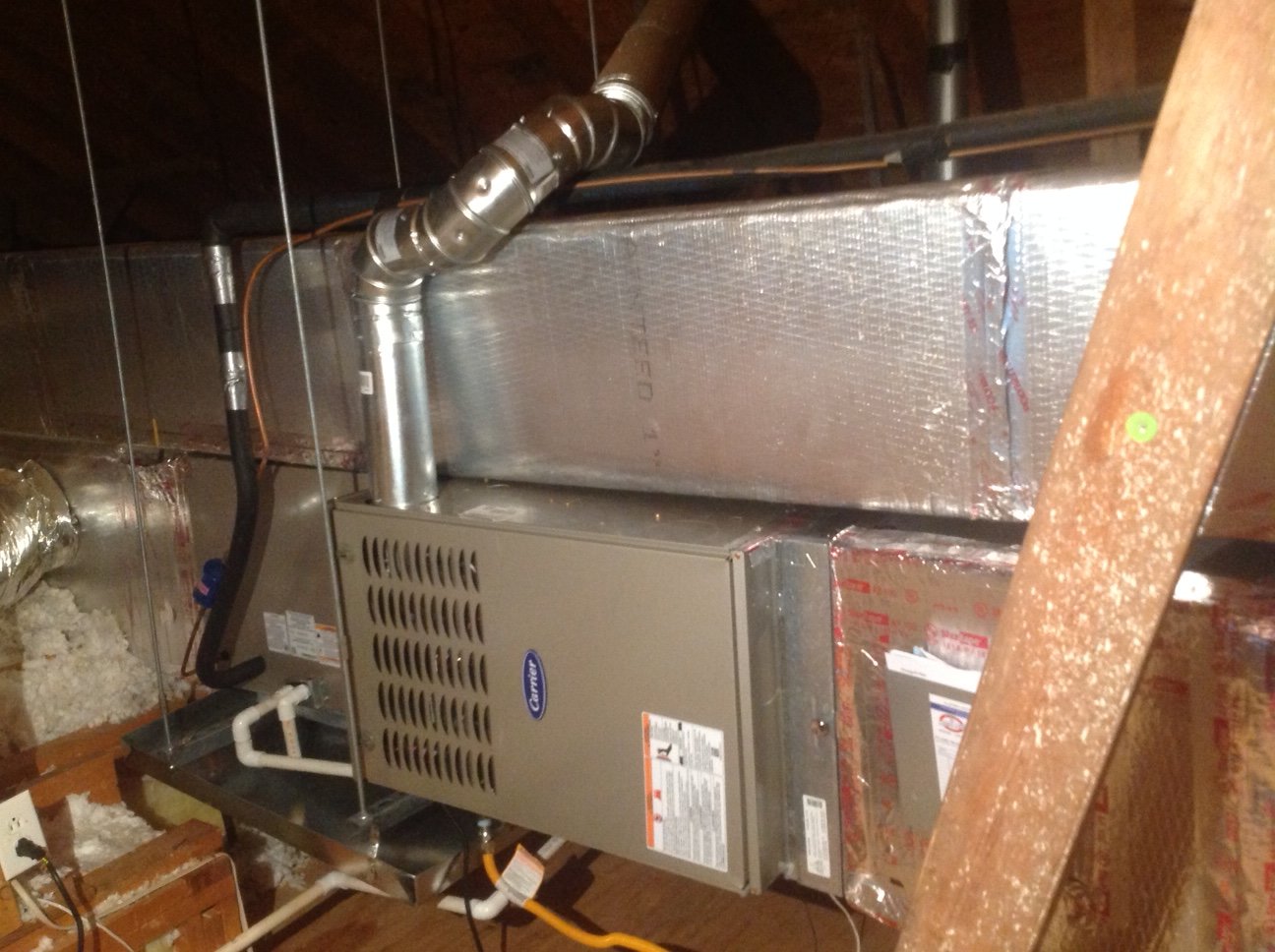

My biggest culprit (10' from antenna):
Conclusion:
If I had an antenna tuner, I'd probably use it as is. Since I don't, I'd like the SWR's to be a little lower. Believe I'll move it to the backyard on a painter's pole.
